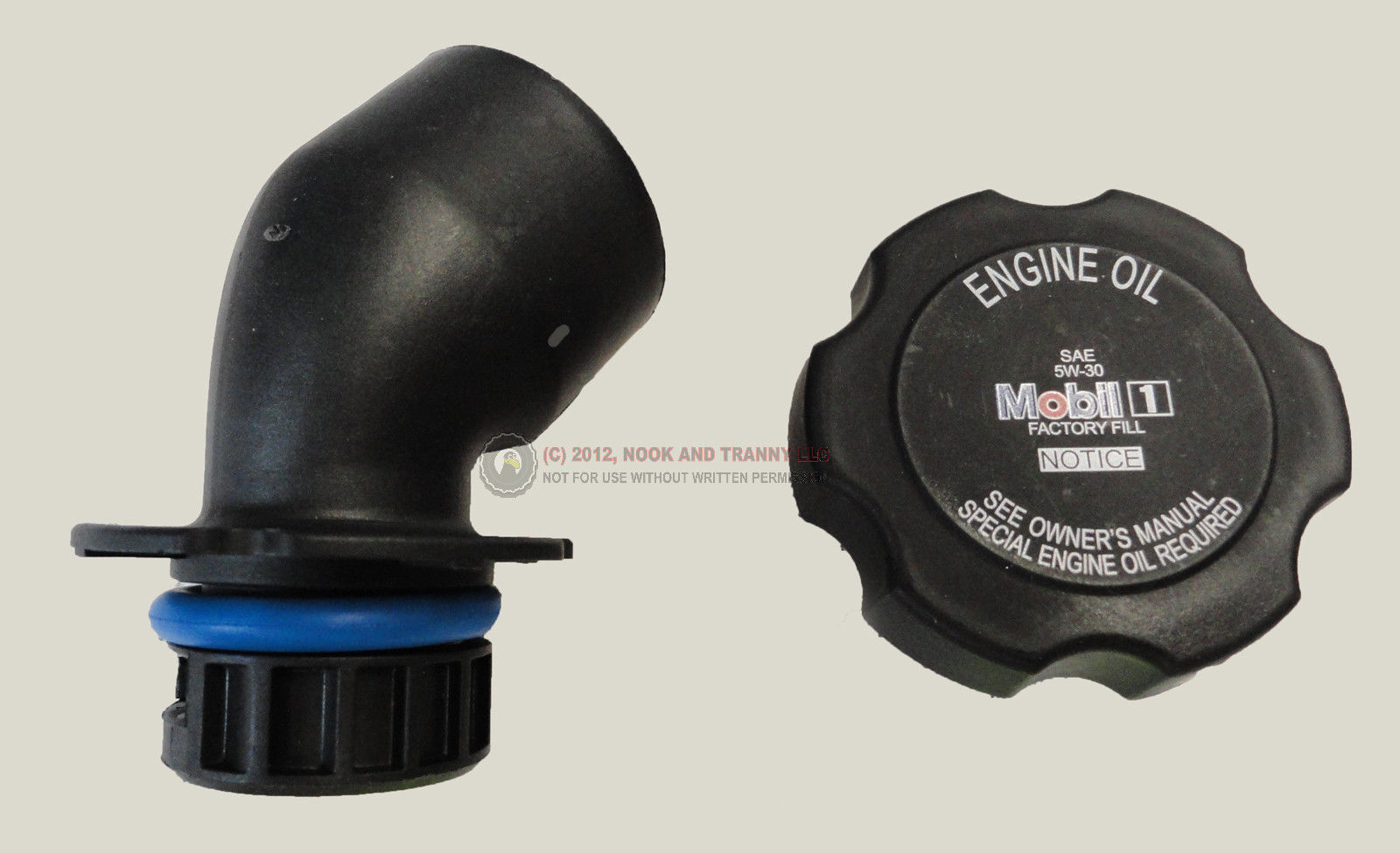

Problem is that both the dry sump and the wet sump motors both use the same valve covers.
On the dry sump, the passenger side does have a closer cap that can be removed and oil can be added to the motor incorrectly . Hence there is not hole through the fuel rail cover on a dry sump motor, but if you remove the fuel rail cover on the passenger side of the motor, you can get to the valve cover closer cap instead.
Hence on a wet sump motor, the passenger fuel rail cover does have a hole in it, so the funnel section with its oil fill cap extends above the cover instead.
So the low down and what sounds like what happen,
the tech did not remove both the drain plugs, hence one of the side to drain just the quart'ish of oil that dripped down into the motor to the dry sump pan when the motor is shut off, and the one of the front of the pan to drain the tank and the majority of oil in the system. Which only drains what oil was in the dry sump pan that had dripped to the pan when the motor was shut off, plus the oil from the filter that was pulled.
Then, instead of only adding oil to the reserve tank only, pulled the passenger fuel rail cover, and proceeded to add oil into the motor incorrectly to over fill the dry sump pan that can only hold about 1 1/2 quart of oil max instead before it start to take the oil line up the point that the piston when moving will slap off the top line of oil as they are punching into the over filled amount of oil
So at start up with the way too much oil in the dry sump pump to start with, and reserve tank full of oil from it not being drained correctly via the front drain plug,

The mass amounts of oil in the TB and intake manifold and what flowed down the air filter, already tells the tail of the system over filled with oil, to over flow the tank in the first place.
Hence on top of the tank is the two vent lines that is used to pull the oil vapors from the tank and valve covers and send such to the intake manifold so the air like oil vapors are burnt by the engine.
When the tank was over filled by too much oil in the system, instead of just oil vapor be pulled into the motor to be burnt off from the top of the tank, pure oil was sent down the lines to the the intake manifold isntead.
If you look at the oil tank, you will see two lines that come off the top of the tank and note the position of the oil check dip stick which is much lower in the tank as well.
The back line is used to vent the valve covers vapors to the tank and the forward line is used to vent the tank vapor as well to the intake manifold, so the oil vapor can be burn by the engine.
https://doc-0g-3c-docs.googleusercon...2NQX3VOYVg2c28
If you look at the according rubber piece right in front of the throttle body, you will see a press down top cap with line to it in between the back side of the rubber acordian piece and air filter resinator box, and is the line in the diagram link above that vents the tank and valve cover vapors right before the Throttle body in the air intake system, so the motor can burn the oil vapors from the oil system.
So even if Pep boys tried to pull a fast one with draining the tank down to full line after the fact, the oil that over flowed from the tank when the system was over filled in the first place, with still will be in the tank vent lines, the air filter system, the TB, the manifold, and in the cylinders (oil soaked spark plugs) as well.
And again, if they just tried to over fill the tank from it oil cap fill port on the tank, it would have been pouring oil of the dip stick area.
So someone poured oil into the engine by removing the passenger fuel rail cover, the valve hole plug piece to incorrectly instead. As soon as the car was started, the oil dry sump pump, pulled that oil in the dry sump pan to send it to the tank since the pump is trying to keep the dry sump pan dry, which cause the tank to over fill instead.
