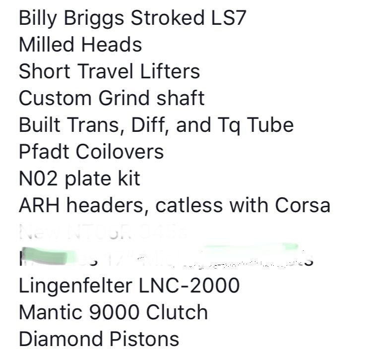

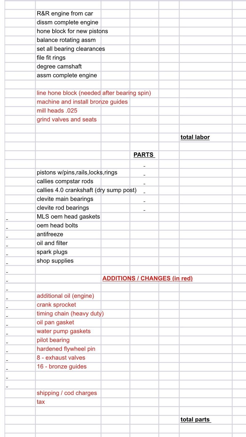

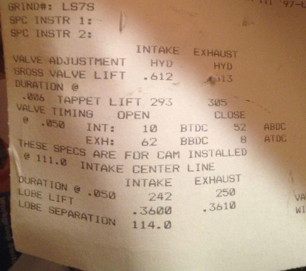

Looking at picking up a new to me C6Z.
I will be using it as a weekend warrior at the track and occasional nice weather cruises. Does anything below stick out as an issue for what i want to do? Was looking for a stock LS7 car but this is a decent deal and has some other goodies in it i like
thank you
