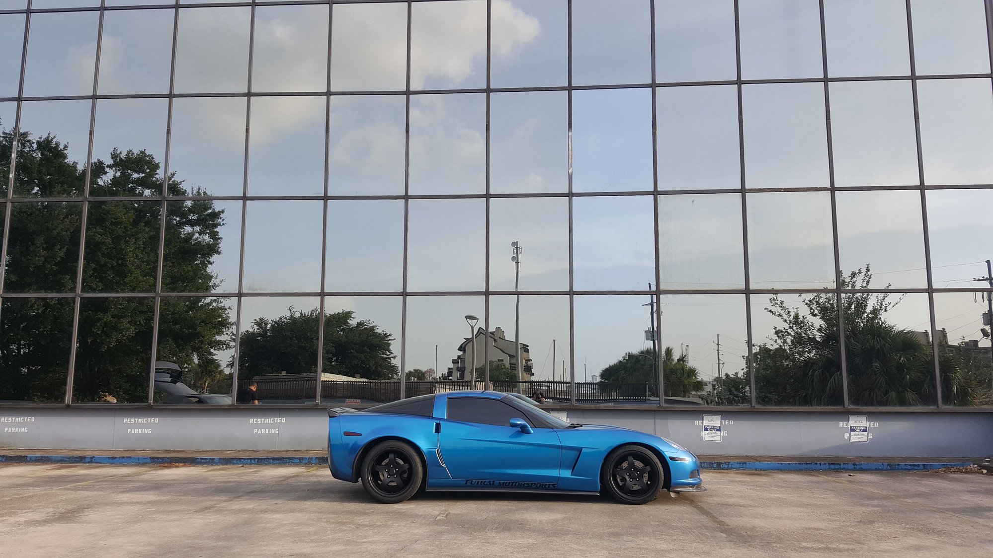

This is for my rear wide body base car on 19s.
Currently running 275/30/19 (25.6)with rear 345/30/19 (27.2)
With this setup I don't have any issues. When I put my 17s on the back with a 28 it's a hit or miss with the stability and abs sensors.
Looking for input on switching from 275/30 (25.6) to an 275/35 (26.6) with the same rear 345/30 (27.2).
Is it now too close of a ratio moving up in size? Also I'm trying to put r888rs on all the way around and this is the only sizes I can get them in.
If I do different tires up front I have the option of 25.6 or 26.6.
Thanks for the help
