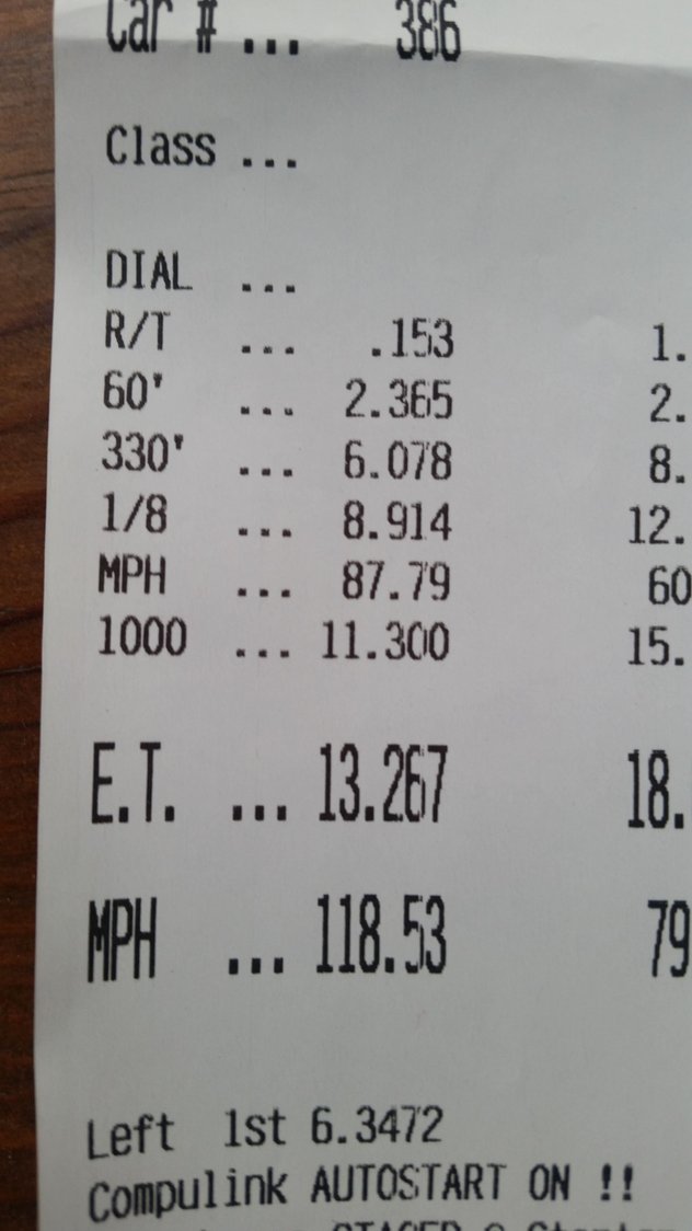

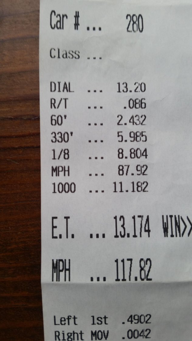

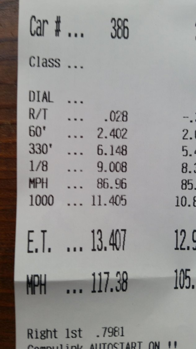

Alright guys here's some of my last time slips. The 13.1 was spinning basically all of 1st gear. The other 2 passes were bogged pretty bad. And thanks for the link, it has some very good info in there. Also thanks for all the suggestions guys I can really use all the help I can get. I'll try to get my girl to go with me next time I hit the strip and get her to take some video hopefully. Anyways guys my mods list is fairly basic. Right now I'm running PRC ported L92s, halltech intake, kooks 2" headers and a TSP Stage 4 F35 cam. Oh and I know I'm running extremely slow for the mods, but I live in CO so bandimere speedway is a little up there in elevation.

With that MPH you can easily run 11's. People don't realize just how much the 60ft affects the ET. Work on slipping the clutch quickly without letting the car bog, the best way to describe it would be to keep the nose up all the way through 1st gear with out letting the weight of the car fall forward and have to regather itself. It takes time but you can do it. Make sure you do all the things that are needed to make it happen. Lower your rear tire air pressure a bit, do a good clean burnout and don't drag water through the box, and go to a track where prep is good. Without prep you can pretty much kiss any chance of a solid street tire run goodbye.

Thanks for the advice. I'll work on slipping the clutch and try letting some air out of the rears

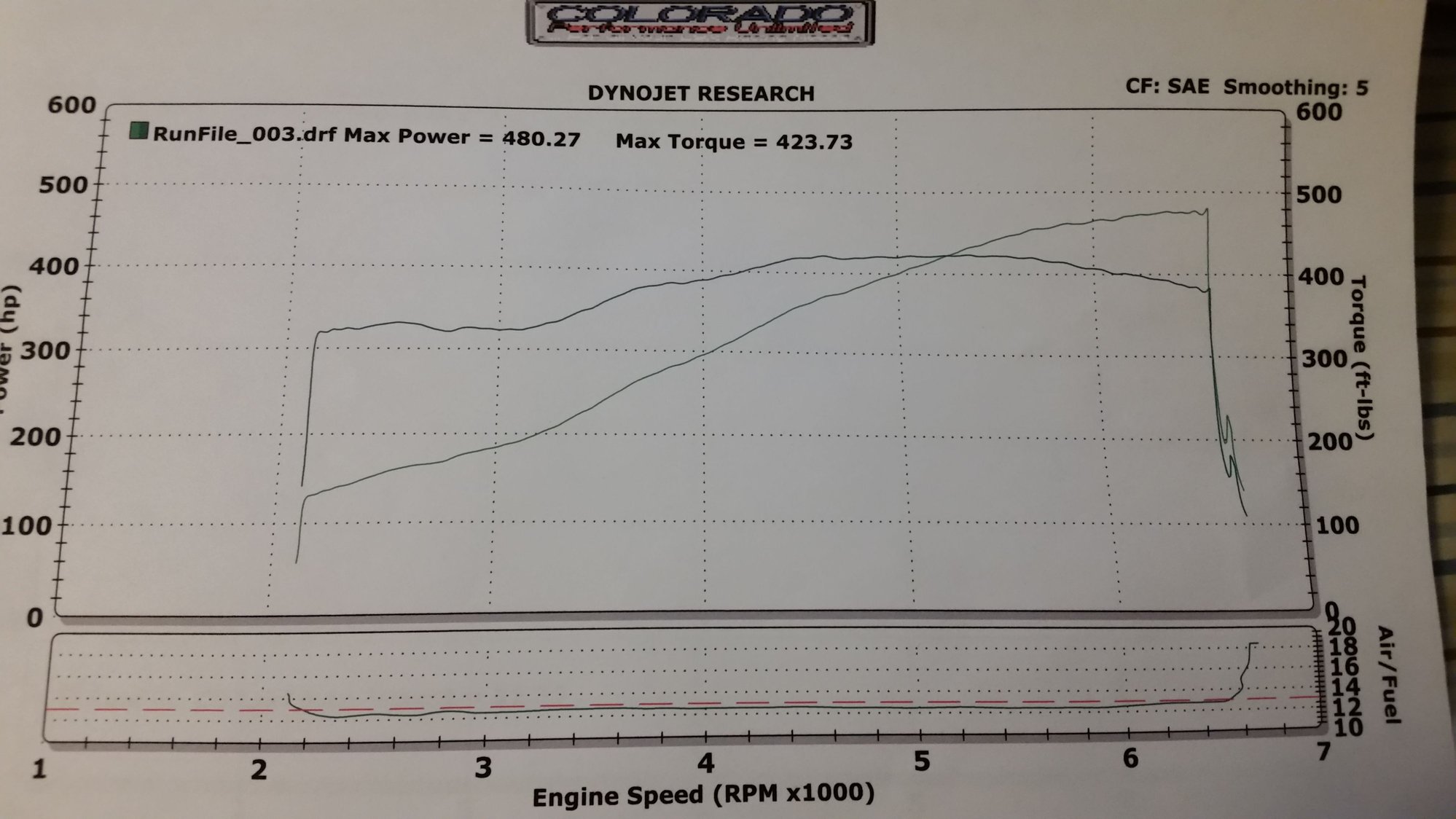

Also here's my dyno graph for the car. It's corrected for our altitude so I'm guessing the car makes about a legitimate 400 whp. The car feels pretty flat in the lower Rpms as you can see, so I need to keep them up just a little while trying to keep wheel spin down

Launch like you would on the street if you were lined up next to another car and had to get out ahead of him and into his lane quickly (like if you’re in the wrong lane and need to get over to make your turn). Don’t go for max hard launch, just think “quick” like u are trying to beat the other guy to the tree. Then shift quicker! Stab the clutch and rip the shifter. It should be violent. I have seen some decent in car videos but a quick search of youtube didnt produce a good example.

Good idea. I've been trying too aggressively and spinning a lot I'll give your idea a try
