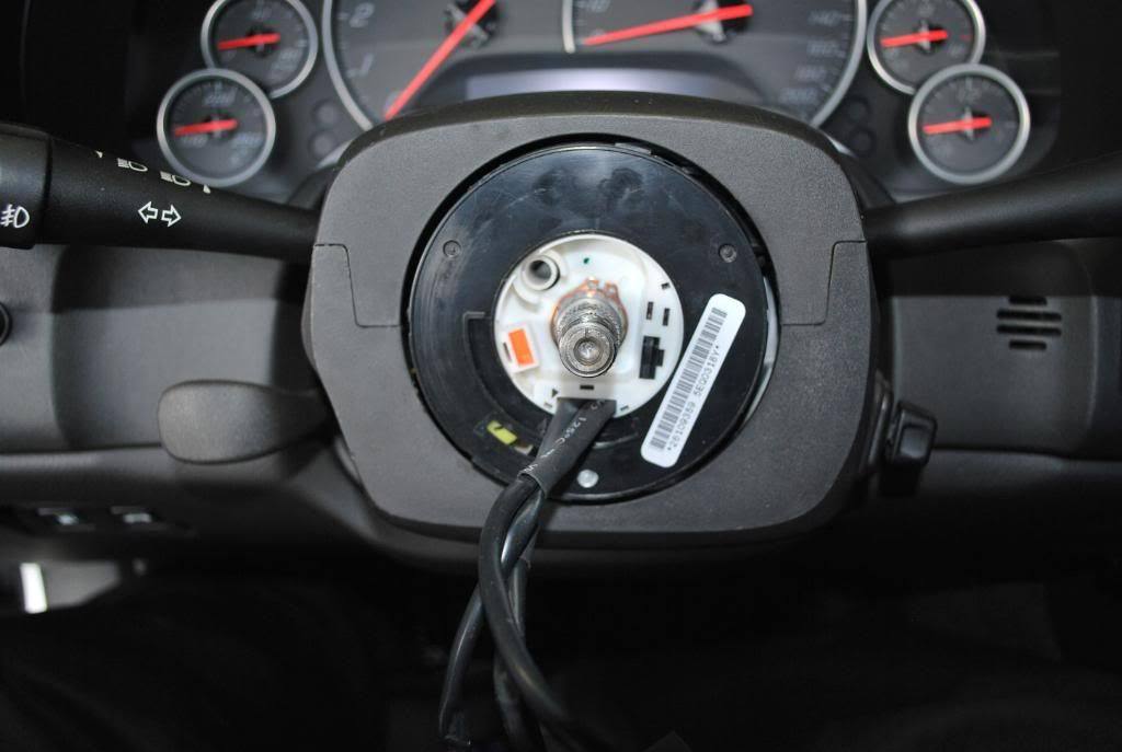

And this is what the clock-spring looks like.
It's a wiring harness that's loosely coiled around itself so that as the steering wheel is turned, it either winds up or un-winds.
