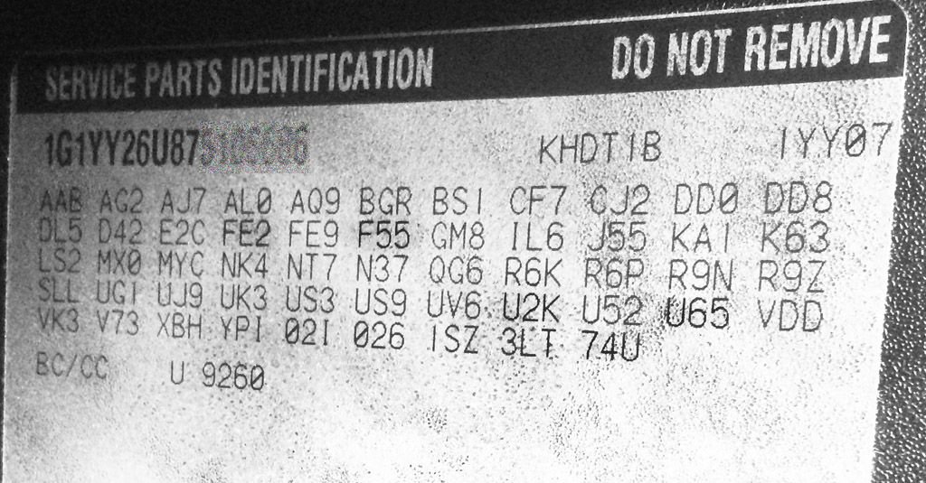

Does your list of Option Codes include "F55"? These are found on a placard in the glove box. The F55 code means you have Magnetic Ride Control, and replacing shocks is complicated, problematic.

it is not magnetic ride,i just want to know which bilstein shocks i should go with.
