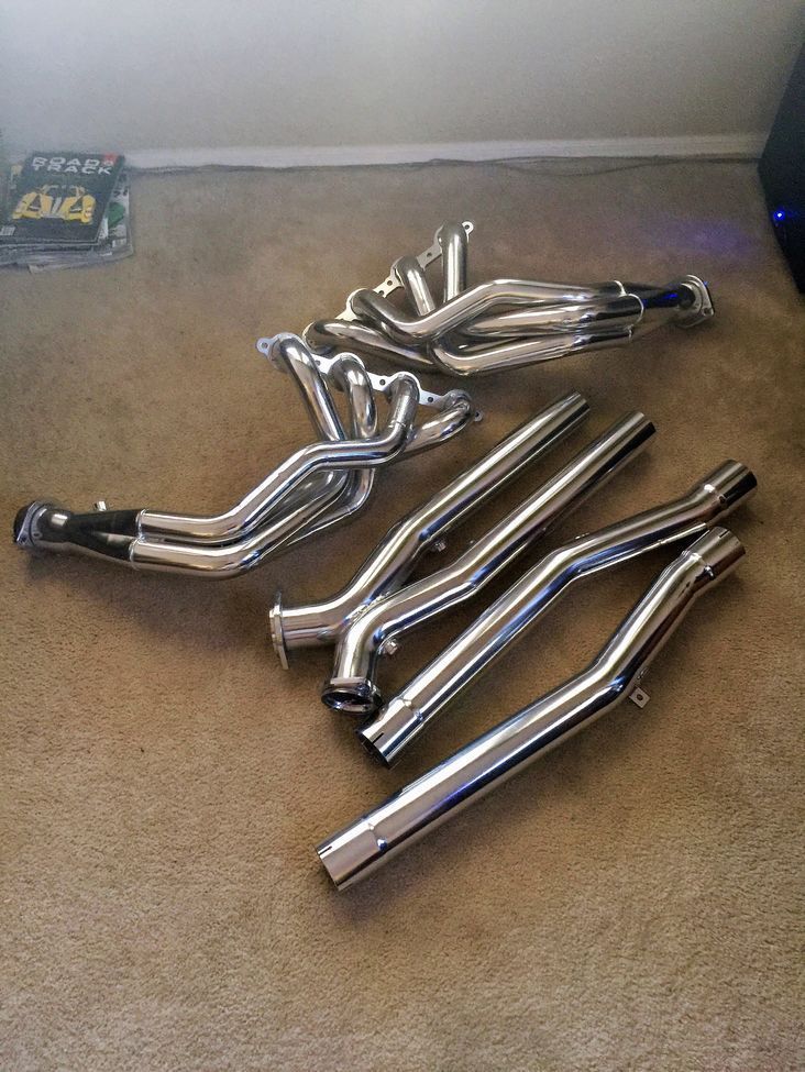

I just got a complete ARH header system (with catted x-pipe). I am going to have the headers ceramic coated to help with the under hood heat transfer. Is it worth it to coat the rest of the x-pipe as well? Not sure if that will help with heat transfer in the tunnel area. I know ARH doesn't recommend coating the cats as that makes them retain too much heat and can damage them. I can probably have the coater just leave the cats uncoated, but coat the rest of the pipes. Appreciate any feedback on this.

i would not coat the cats for sure or you will have dead cats.
There are other heat shield wraps that half cover the cats that would be a better option or heat blocker material on the tunnel plate.

I have decided to only coat the headers and leave the x-pipe alone. I am also installing the thicker tunnel plate with heat shielding so that should take care of the tunnel heat. I don't want to destroy the cats.

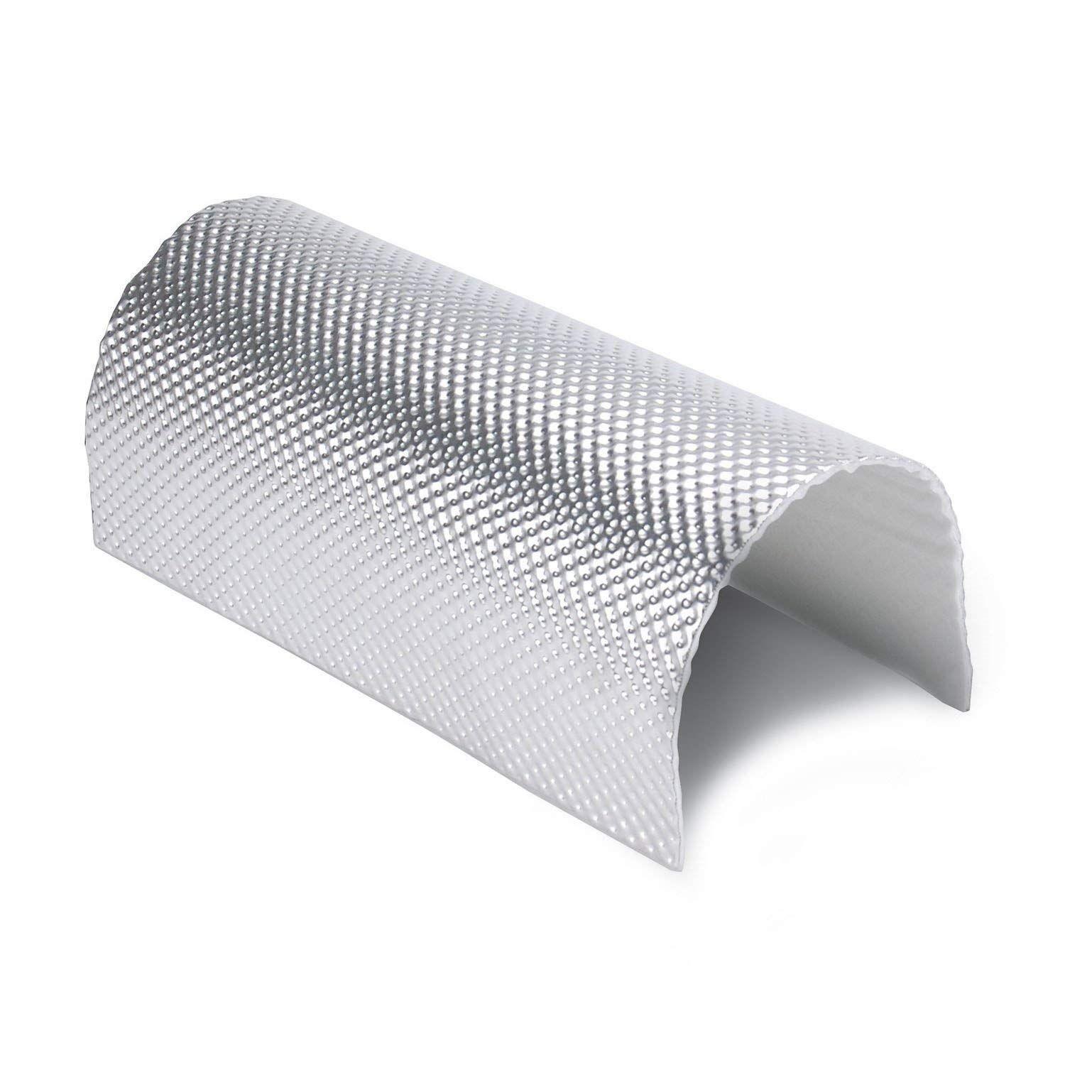

The cats are where the most heat will be coming from (I believe), but coating the entire exhaust is a worthwhile investment to me. While I have no data to back it up, theoretically if you can keep the exhaust gas temps hot all the way to the mufflers this should keep exhaust gas velocity up as well..helping the scavenging at the heads.
I also did my own tunnel plate shielding for both acoustics and heat using the Design Engineering DEI Boom Mat product, model # DEI 050508 which gives you a sheet of product 21" x 48" which is more than enough to do the tunnel plate.
The product is rated to 1750* ambient.
I purchased mine thru Summit but it';s available from Amazon and other retailers as well.

Hi Tim from DEI here,
For the transmission Tunnel guys we now offer a kit that includes the center plate cover, and 4 sides shields that is great for blocking heat coming into the cab from the center console. Check it out at http://designengineering.com/corvett...tunnel-shield/ and can be purchased at Corvette Central or Zip Products under P# 050532.
For the exhaust wrap guys, header wrap will can get moisture in it but typically burns off just like an un-coated or un-wrapped pipe. You can saturate wrap with moisture but again it will burn off almost instantly, unless you purposely spray the hose on the wrap and hold it there and then instantly park the car when it is not up to operating temps. As for oil a drip here or there will smoke and burn off. Now if the wrap is saturated in oil, it will be best to fix the leak and then re-wrap with new material.
