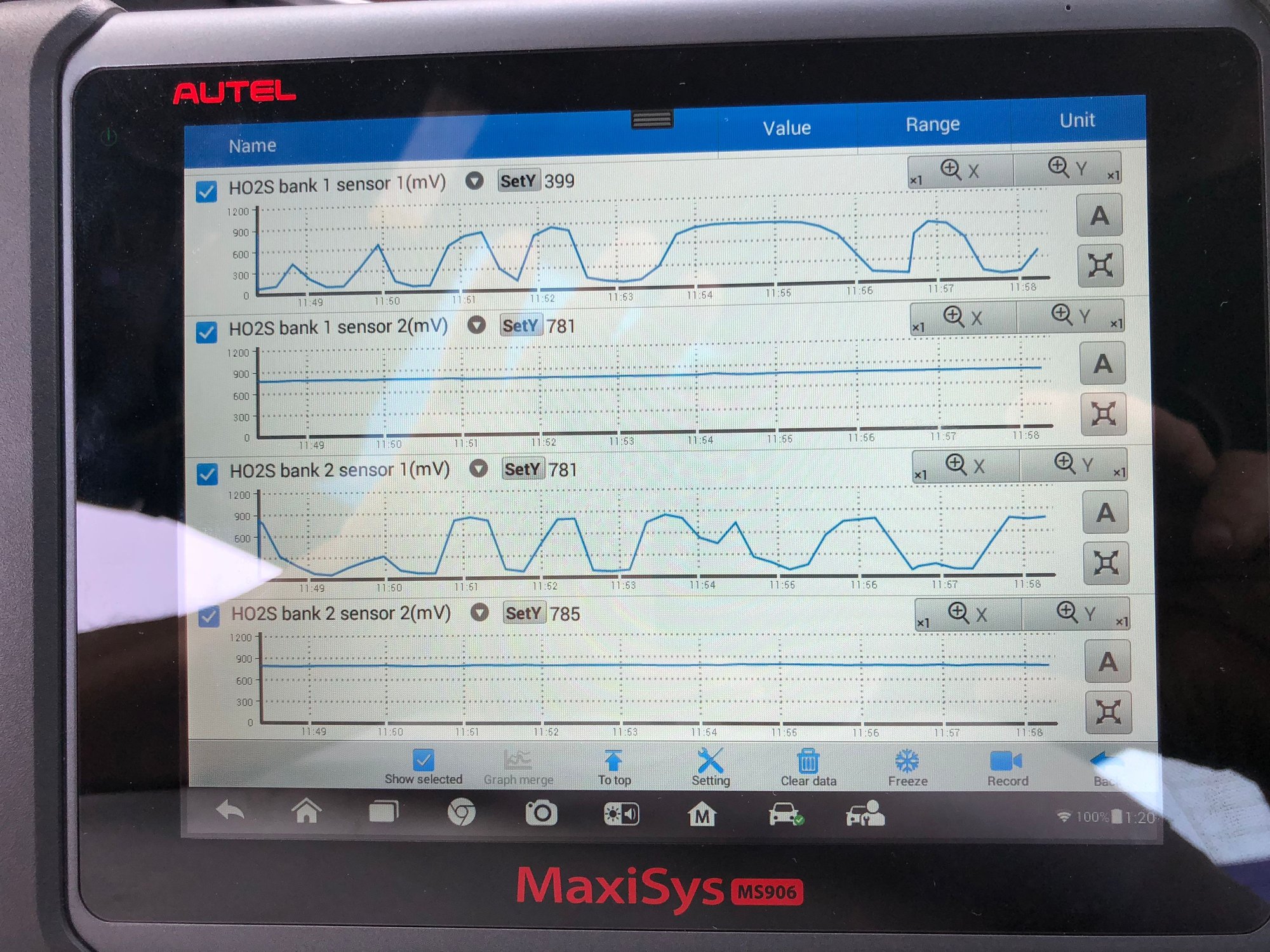

If your upstream O2 sensors are switching like this you’re GOLDEN !!

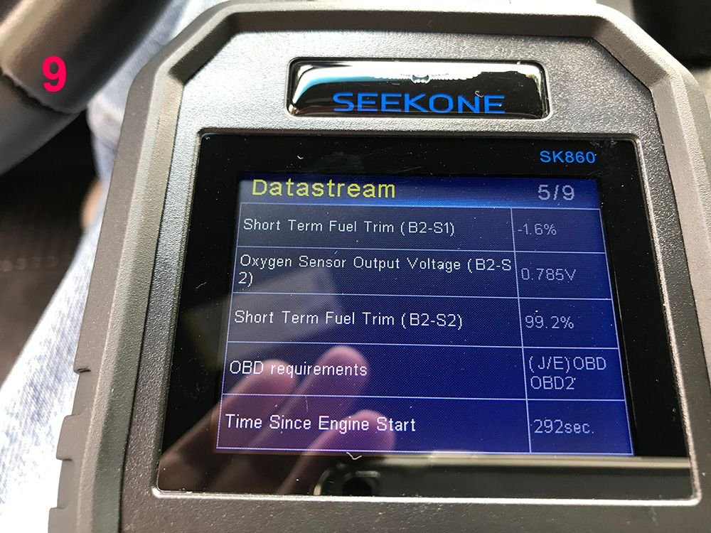

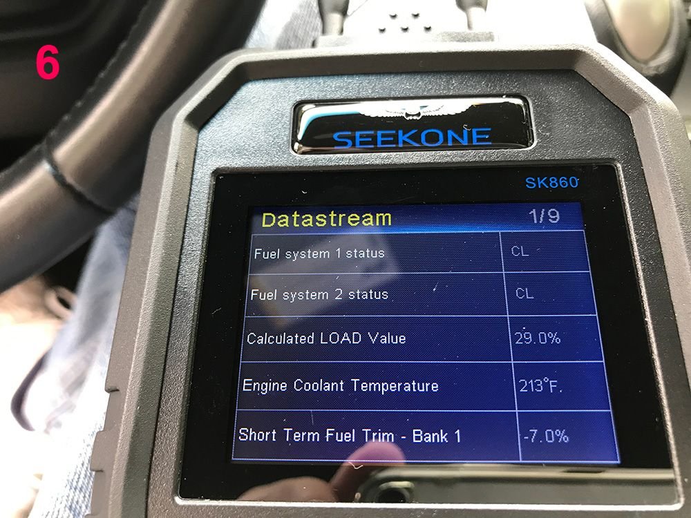

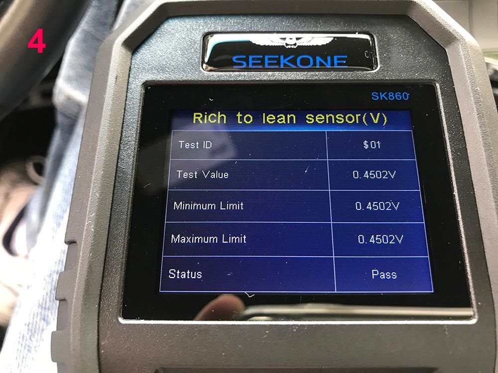

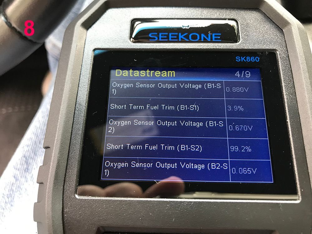

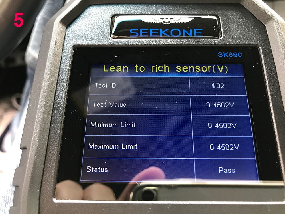

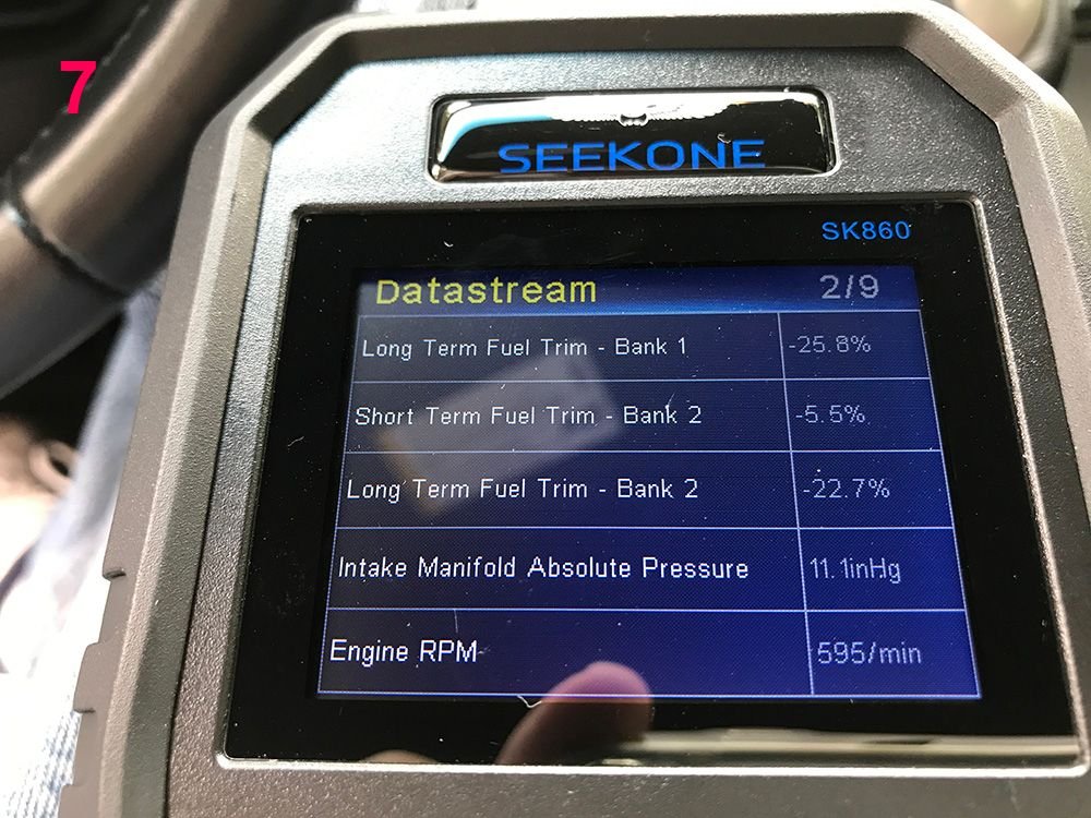

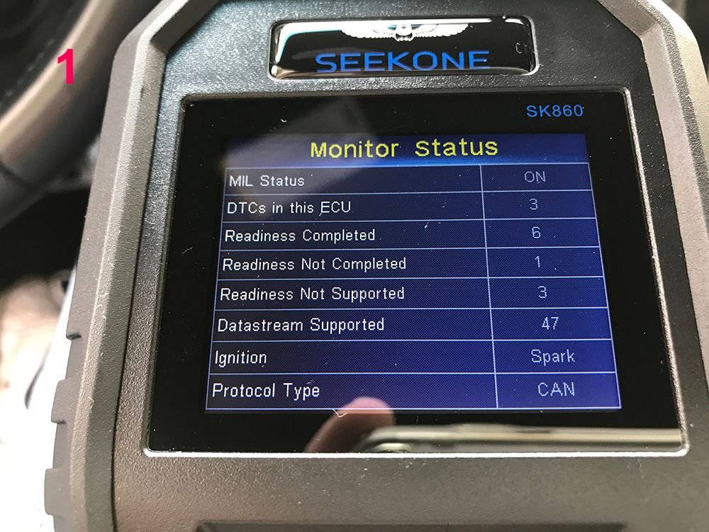

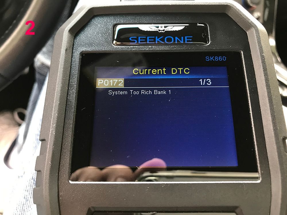

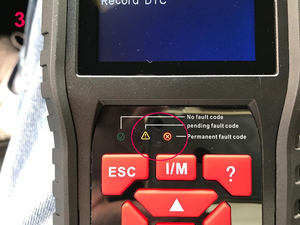

OK--I got the DTC P0172 error cleared--however, it required me to clear it while the engine WAS RUNNING not OFF even though that's what the devise said to do. The CHECK ENGINE light went out and I re-scanned the system and found no DTCs. Again--I cleared it while the engine was running--not with ignition ON and engine OFF. Clearing the DTC wihile the engine was running worked. Attached are a series of pics I took of the scanner while I was attempting to clear the error. Image-1 is the initial MONITOR STATUS screen I get upon selecting DIAGNOSIS. Image-2 shows the DTC. Image-3 shows the PENDING FAULT CODE light and the PERMANENT FAULT CODE lights lit-up on the devise. Image-4 shows the RICH TO LEAN SENSOR figures and Image-5 shows LEAN TO RICH SENSOR figures. Images-6-9 are DATA STREAM screens I shot too--after the DTC was cleared. I don't know if any of these are helpful or not and I've been unable to access any graphs showing TRIM data you mentioned. I'm not real familiar with working with an OBD II scanner and what it's telling me. BUT--currently I have two BRAND-NEW O2 sensors installed and I've been able to clear the DTC error. All this doesn't mean my worries are over as the CHECK ENGINE light may return. If it does, do you think I'm looking at a faulty fuel injector?
Thanks again for all your help.
Thanks for the pics !!...looking at your fuel trims you have BOTH banks running rich. Your total fuel trims on bank 2 are -28.2 (-5.5 + -22.7)...you should have gotten a P0175 also. That leads the diagnosis in another "direction"...You might have an "over reporting" MAF sensor because of a dirty OR defective one...a dirty throttle body is something to look at too...I'd clean both and we will go from there. You can check for a dirty MAF by running the engine at 3000 RPM...if the fuel trim numbers go from negative (yours) to positive numbers it's dirty !!...I don't see any MAF PIDS in your pictures but you should be reading between 4-7 grams/second at idle to 190 or more at WOT. Your MAP sensor with "key on engine off" should be around 103 kPa (14.93 psi). I'd also look at your air filter too. These numbers are for an LS1 engine. I don't know if you have a CAI or OEM factory. Like I said let's run it a little on the road and see if those fuel trims get better. I'll include a pic of mine at IDLE with PIDS I look at. Also I'll include 2 videos on fuel trims which are excellent. Matt is a microbiologist by trade and is SUPER SHARP. If you REALLY want to learn this stuff and not have to rely on forum members you can start here. Learning O2 sensor operation and fuel trims are the KEY to successful engine diagnosis...another thing, I'm looking at your Bank2 Sensor 1 O2...is it always .065 mv and not fluctuating between .065 and .900mv....065mv is SUPER LEAN ??....that's why I don't like looking at snapshots because I only see the number the camera captures while it's switching high to low...if I can see a graph like the picture of mine I sent you I have an idea of what's really going on.
