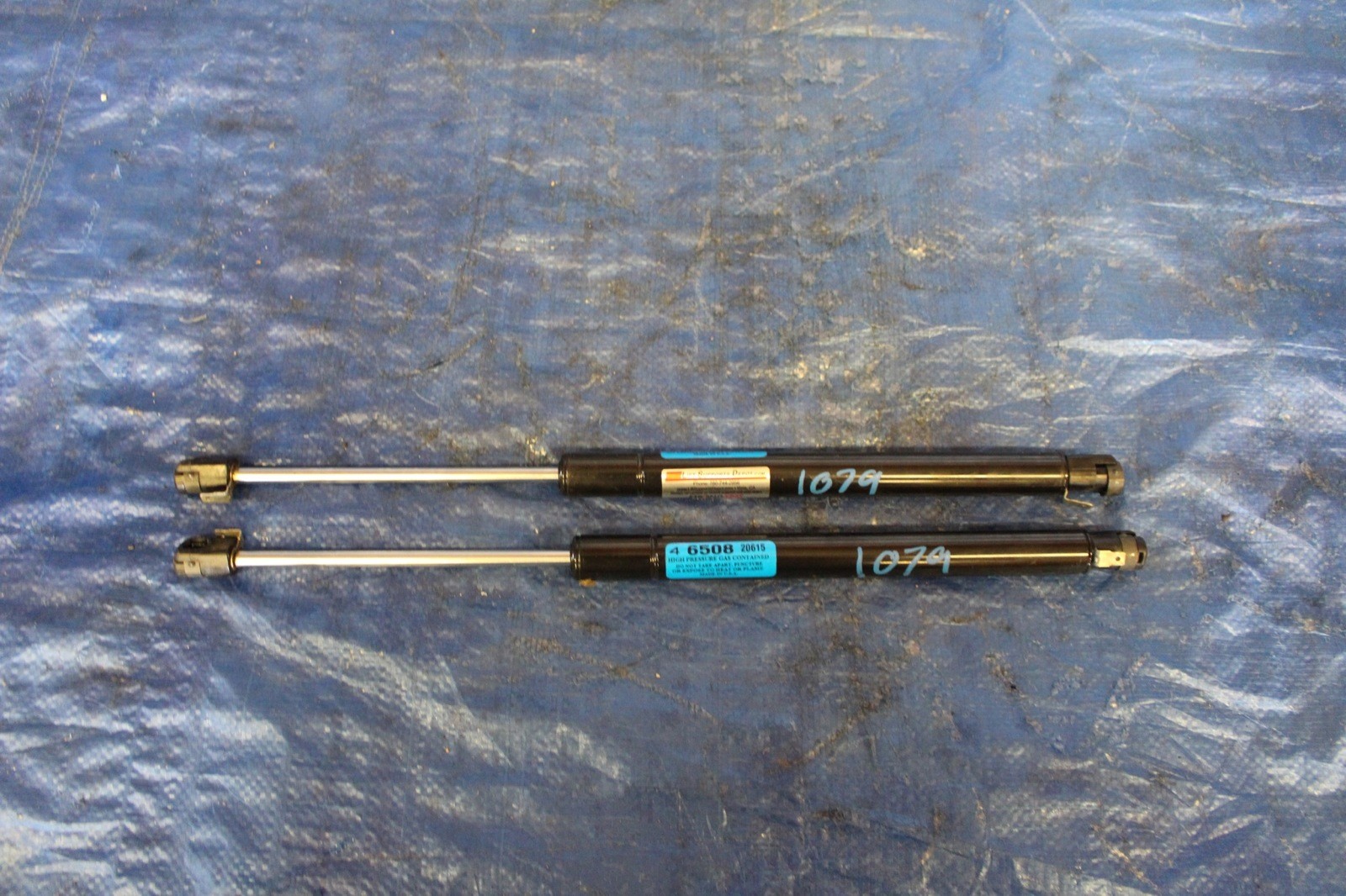

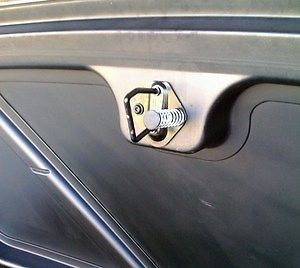

Pop assist spring will help, but may be time to replace the struts as well. Also check the hood struts, since will bank that they are going weak and due for replacement as well.

Thank you for the information and images. I did not know about thr "pop assist"

I put the Pop assist on mine a couple of years ago....works great.
