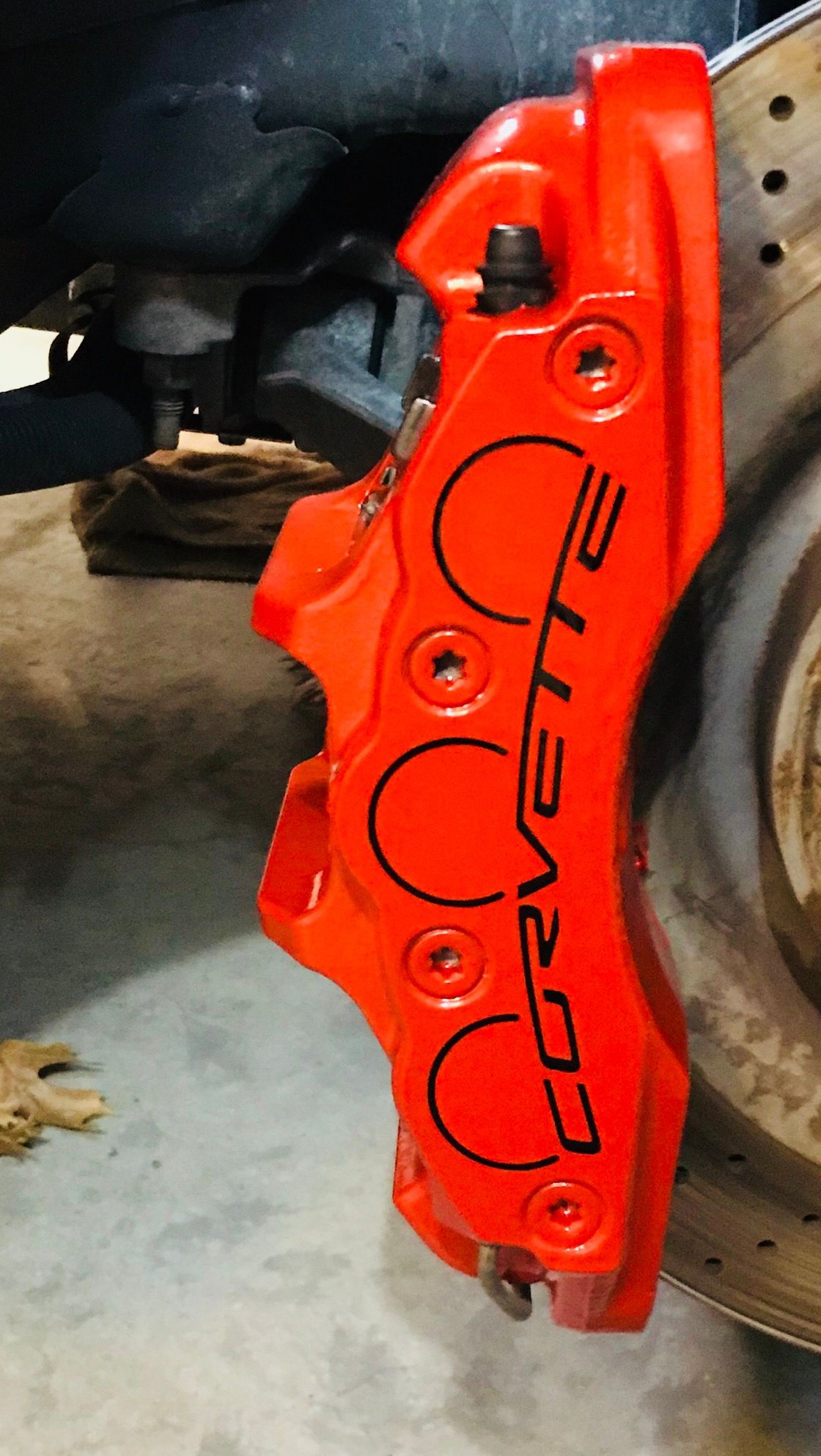

Originally Posted by bacord
I used finger nail polish for the raised letters. It's been almost 2 years now and still looks new.
The Grand Sport calipers don’t have raised letters. Use the G2 Kit & get caliper decals here fourthodesigns@aol.com

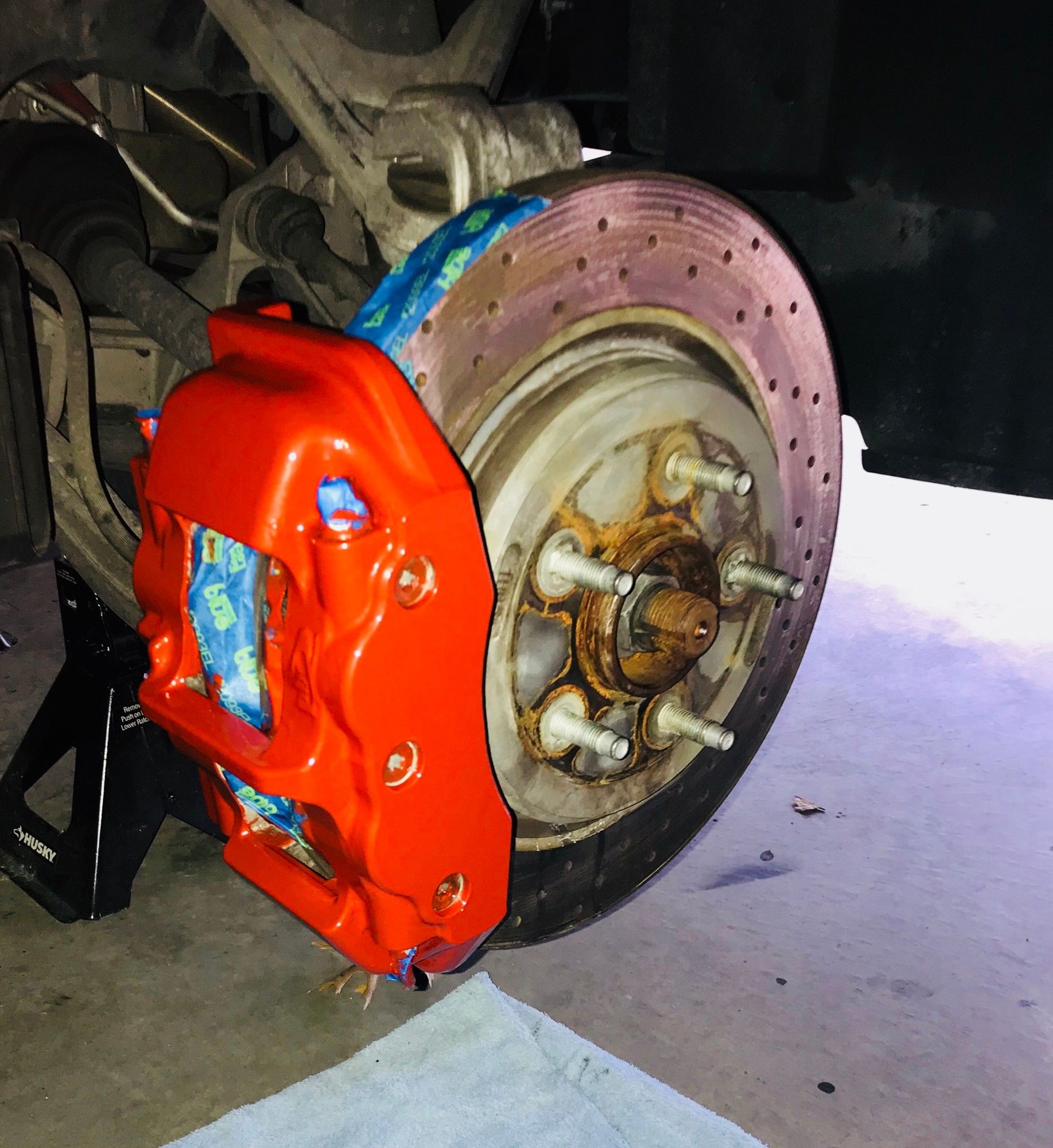

JABCAT.......Remove that Brake Hub Rust and treat bare metal with FLUIDFILM to inhibit
Future Rust & Corrosion
Just checked out the Fluid Film - I'd never heard of it before. Is it Type A that should be used?
