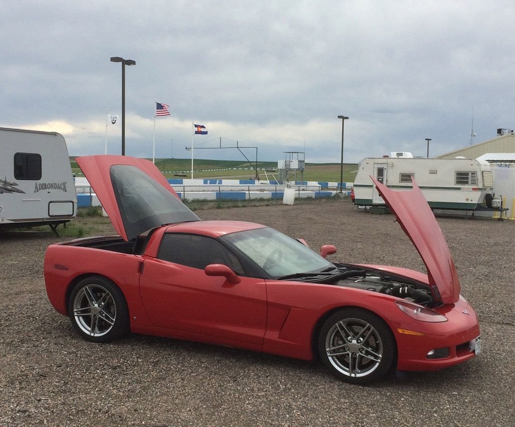

I tracked mine at High Plains Raceway in May, 2019. Great Fun! Hey, FloridaJohn-- they didn't require a Roll Bar in your convertible? At High Plains convertibles are prohibited without a sturdy (they decide) Roll Bar.
To 08 Z51 concerns
