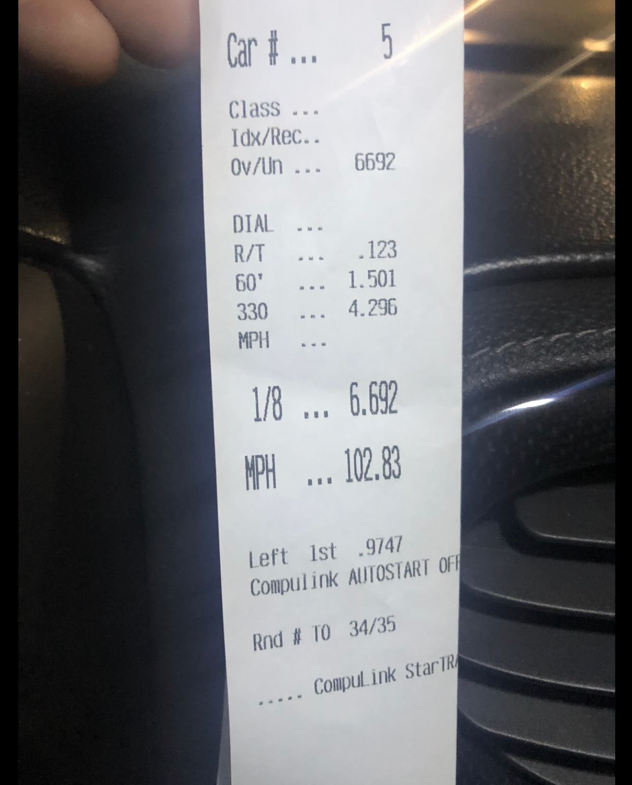

My stock bolt on ls3 ( only headers and cai ) picked up a solid half second in the 1/8th with just the addition of a yank pass 3400. Drives like it should from the factory now. And it loves a shot of nitrous. It’s been a 1.48 60 but still spun a touch. Poor track prep. I think it might have a low 1.40 in it. This was a 100 shot. Valve covers never been off of her either. It was running 7.80’s before the converter. .5 is the best bang for the buck ever in my opinion. Fixing to put the same setup in my buddy’s 08 and see if it will do the same thing.
This was with drag radials and a 100 shot of the line
This is on street tires. First pass with the new converter.
