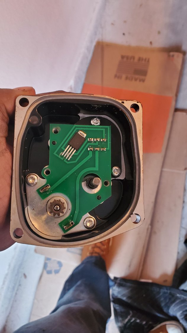

So just for future information just tore apart a NW one and it looks to be the GM equipment inside which is great!
glad to know it’s true. Nice work

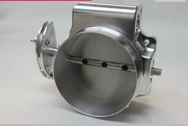

Hello everyone... I don’t own a corvette anymore.. I do have a 81 Trans Am with a LS3 416 stroker 650 HP engine . I’ve gone through 2 cheap cable operated 102mm throttle body’s purchased through eBay, don’t waist your money. The cheaper units have machining issues like TPS shaft is to big and the sensor fits really tight . if you try removing the TPS, you will destroy it ... second and most important... the throttle blade hangs up when the engine is at normal operating temperature. Causes all kinds of idling issues and really difficult to tune if next to impossible. I suspect Cheap aluminum alloys cause the problems...As for the fly by wire units, same issues with the casting and the electronics are hit and miss. Go with a American made unit like Nick Williams or BBK. Yes there 3 times the money . You get what you pay for. Do your research because even brands like Holley are inexpensive and made in China. Holley has excellent products but stay away from there sniper throttle bodies. I hope this helps with your decisions... if you have little experience and are getting your throttle body installed tuned by a mechanic, spend your money on the good quality part instead of a extra 3-4 hours labor into your mechanics pockets just to advise you that your throttle body is defective .
This is my LS3 416 stroker with the Chinese 102mm throttle body. I have since removed it and waiting on the Nick Williams 102mm throttle body
Nick Williams 102mm throttle body.
looks like a good quality product but that’s all it is. This 102mm TB doesn’t function properly. Remarkably similar to the cheap Holley sniper. Not recommended
