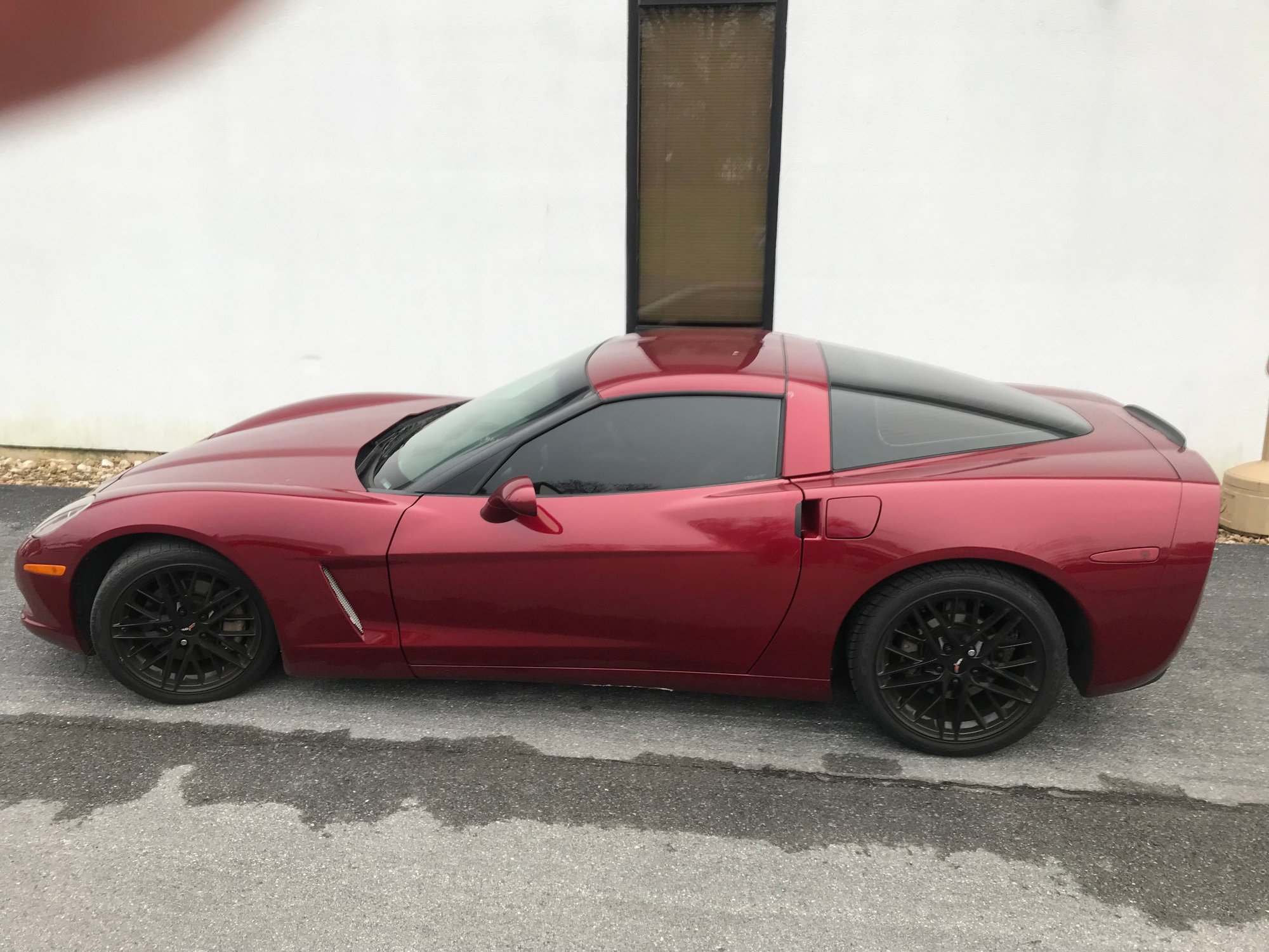

I just got a really good deal on a corvette, my first and I have some questions. First off is it’s a 2006 base model corvette with auto trans, well equipped but does not have the magnetic ride control. I want to increase power and also give it a nice sounding exhaust.
So now my question. Is it better to get long headers with an axel back exhaust and short ram intake or a cat back exhaust system and short ram intake??
I waslooking at:
-LG motorsports street headers long with the cat
-Bora ATAK exhaust axel back
-Vararam intake
Any and all help would be appreciated, I am brand new with Corvettes and know nothing about them besides being fast and good looking.
