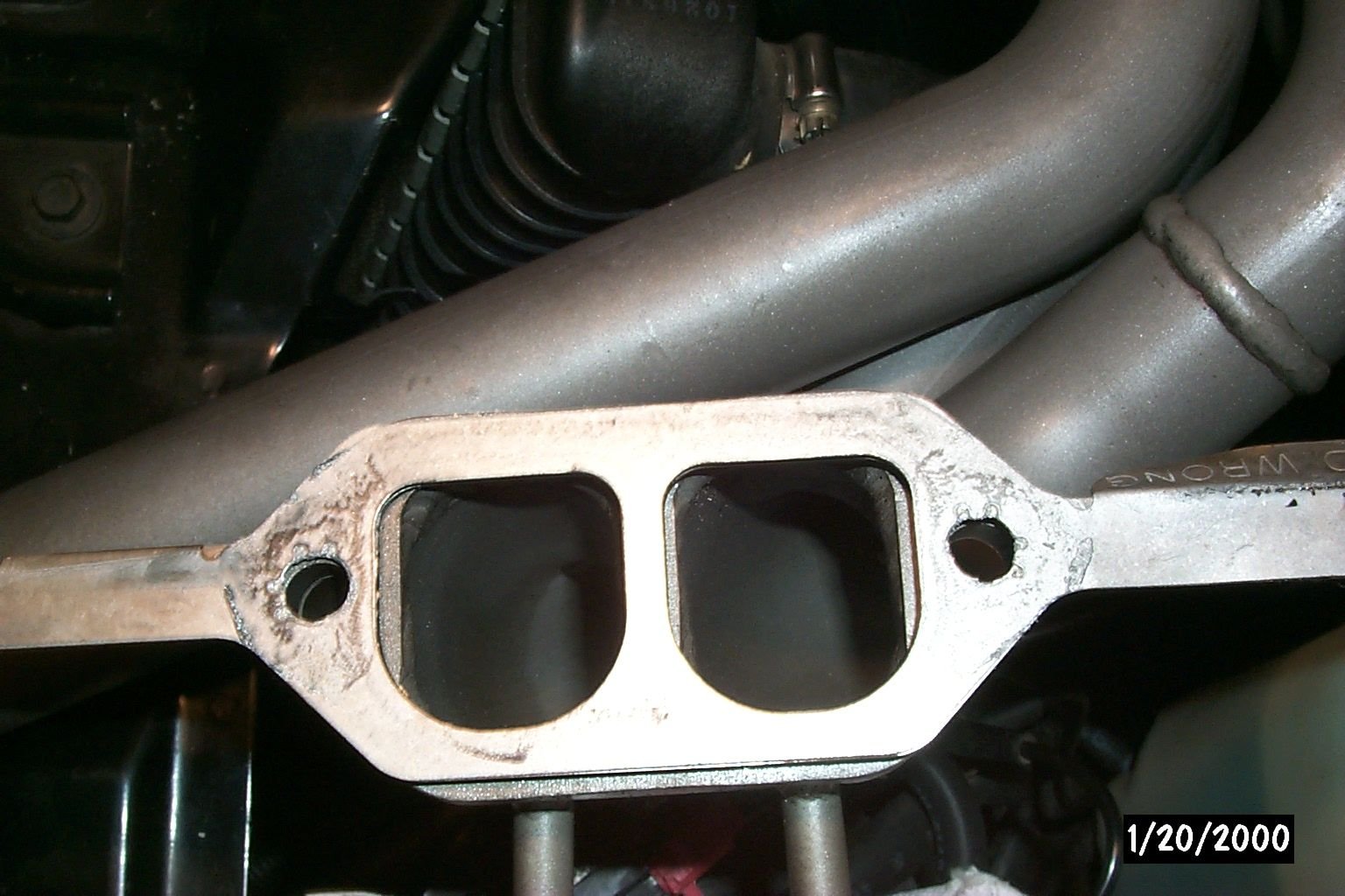

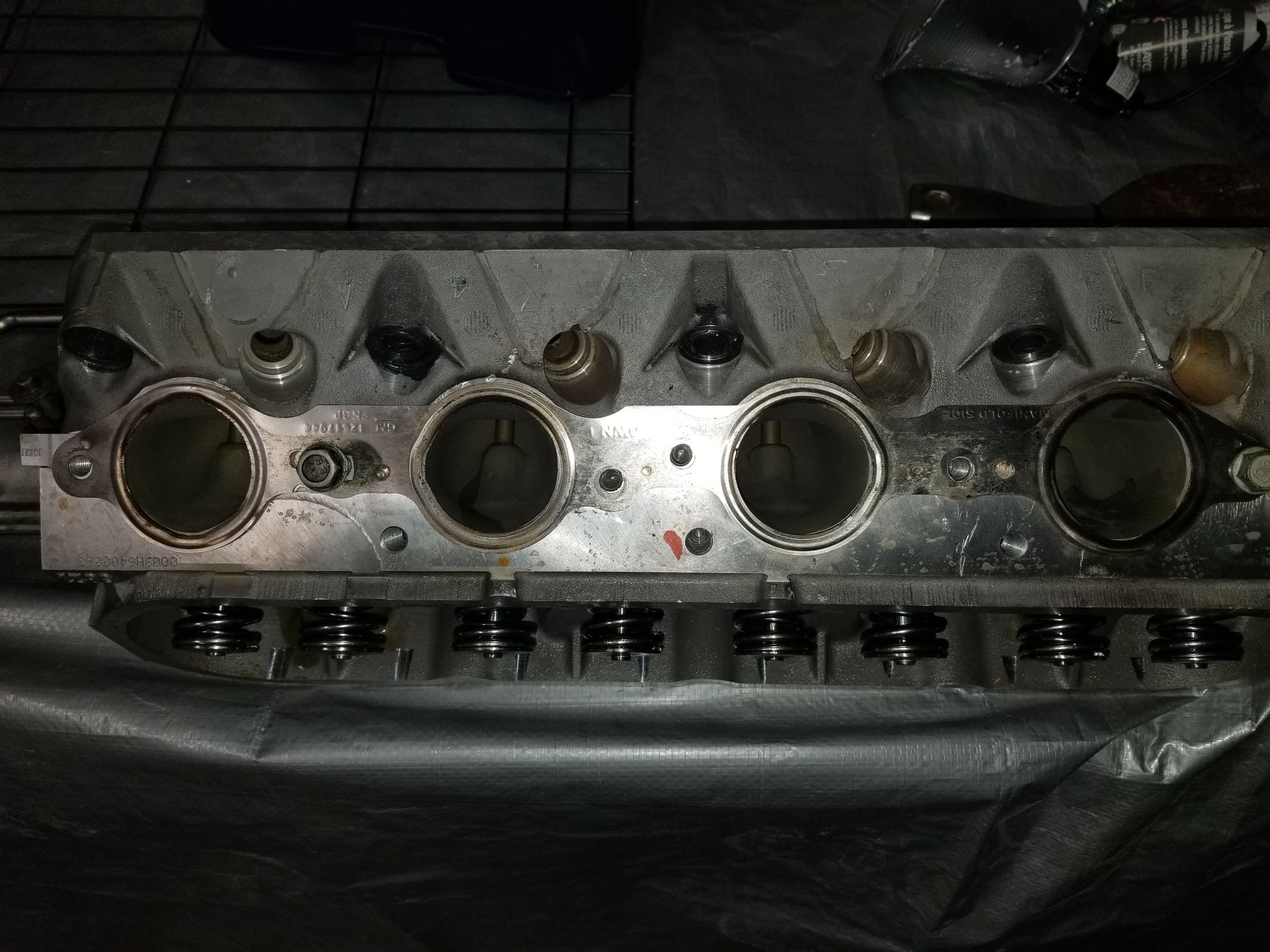

Here the head and gasket i mentioned. I also placed it on my long tube headers and its a perfect match
Here is a pic of the heads they are a perfect match for the header and heads

Compared to gasket, you over sized the ports just a touch.
Do you have any room on the header flange port to slightly enlarge them now?
Hence since you know that your going to have a slight step between the head ports and header flange ports when the two are bolted together with any off set, you want the header flange ports slightly larger than the head ports; so you don't have a step from the off set in the other direction isntead.

yes there maybe some wiggle room. Not sure if I need to take anymore off as the primaries, header gasket holes and the cylinder port are almost a perfect match. You probably cant see it I the photo but the exhaust port is just a hair smaller than the gasket
