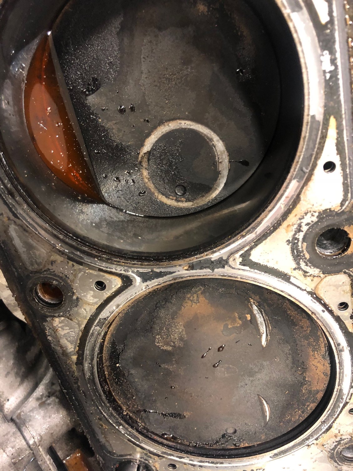

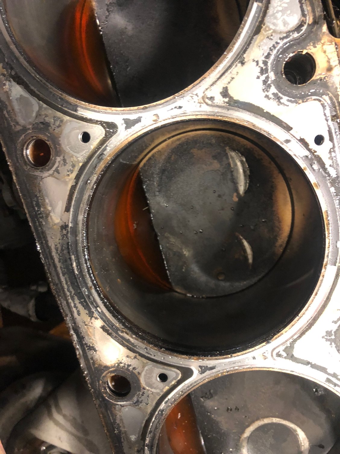

I bought a new to me M6 Z51 wth 65k miles, and one week into ownership the timing chain lets go. This part been discussed in another thread of mine but long story short I'm blaming it on the 25% underdrive pulley. I pulled one of the heads and I've got valve impact on every piston. I'm trying to keep my spirits up and turn this into a build opportunity -- I'd like to get around 500whp out of it. My question is: what is the most cost effective way to go about this? I have a friend who can do most of the engine work outside of machining for about $1k in labor, and we could do a heads/cams upgrade. We'd still have to send the block out for piston replacement. Is this my best bet, or is a drop-in engine (LS3 + mods?) replacement going to be more cost effective?

if it was mine, (and assuming that the cylinder walls look ok), I'd get the valves replaced and the heads freshened and run it as is. Maybe measure the piston top to deck measurement on each cylinder to make sure you haven't bent a connecting rod.

You'd leave the pistons and not replace them? And then still go for 500 rwhp?

those pistons are ''JUNK''

You can overbore very little on that block with the miles on it you will probably end up having to replace it if it needs oversized pistons. A lot of people cut notches in factory pistons for PTV clearance and don’t have an issue.
If you honestly want 500 rwhp then buy a crate LS3 and put a BIG camshaft in it.

I was under the impression I wouldn't need to overbore since there doesn't appear to be any cylinder wall damage. Is there a possibility I would need to? Or could I just get away with honing?

You would almost need to disassemble it to measure cylinder diameter and taper. You could just give it a quick hone and throw new pistons and rings in it but it probably would run as good as what you have now.

I'd run it, wouldn't replace the pistons.

Agreed as long as you do not see any cracks going on (doubtful).

When you have that type of contact. It puts a lot of pressure on the all the mating surfaces. The rod bearings should be checked, check the rig lands for cracks and wrist pin surfaces.

Those are cast pistons, and they do not like being beat on. I would replace all the pistons, and while the engine was out, replace all the bearings as well.
Check for bent valves, cracked rockers, bent pushrods, damaged lifters, and other signs of valvetrain damage. Replace anything that's even remotely suspect. This would be a good time to do the valve guides and seals too, and maybe a new set of springs. Obviously, it's the perfect time for a cam swap too.
The motor can likely be rebuilt very successfully and can be made to make good reliable power for a long time. But this isn't the time to try and save money by reusing parts.
