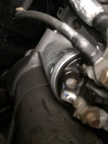

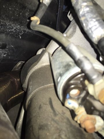

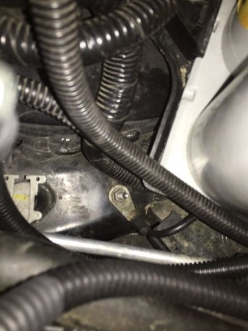

Old Jan 20, 2019 | 07:21 PM
Dano523's Avatar
Dano523
Joined: Dec 2013
Posts: 12,502
Likes: 3,631
If these are with the motor running, you have major problems with the re-outs. Hence running, evap purge should be closed, and evap solinoid should be showing a percentage of how much it venting. Also, should be showing a percentage of the TB opened, as well as the accelerator pedal as well. Hell motor load should be around 6% at idle as well.
So start the motor, then pulling the DTC to see what is not showing up on the GM lan bus, and then the read-outs of the motor running.
Lastly, double check the connection bolt of the alternator cable to starter solenoid, since it may a header heat problem with the connection loose and alternator voltage not making it to the battery as the connection point heats up/battery not being charged from the alternator.

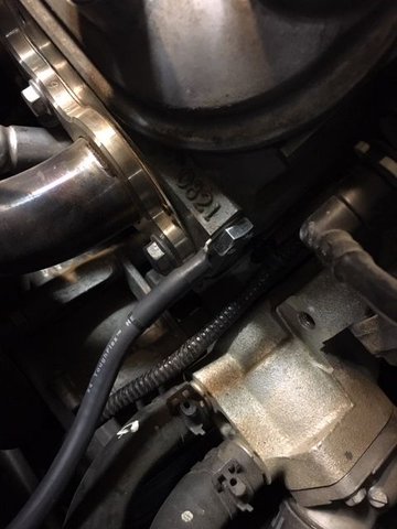

Old Jan 21, 2019 | 03:20 PM

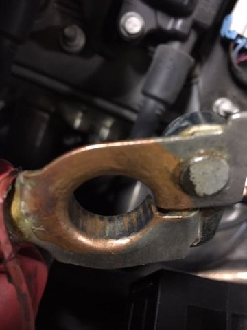

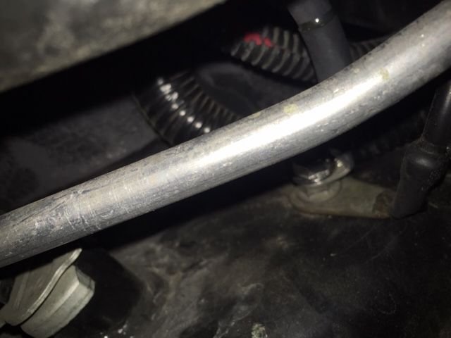

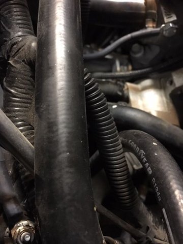

Old Jan 22, 2019 | 07:43 PM
Patrick G's Avatar
Patrick G
Joined: Oct 2005
Posts: 188
Likes: 23
From: Victoria Texas
Pretty sure you have a bad negative ground cable that goes from your battery to the chassis ground. If not that then you need to replace the positive cable that goes to your starter and fuse box. These cables can look good, but inside they get corroded and the car will die. It's most likely not the ECU.

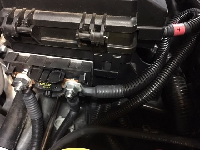

Old Jan 22, 2019 | 08:15 PM
Odo's Avatar
Odo
Joined: Sep 2018
Posts: 50
Originally Posted by Got uid0
I will do another screen capture after i put the fuse box back together i was double checking all the connections again even tho that was done long before this issue popped up.
I may have posted some captures when it was off either way it was done while in park. New alternator installed 170amp mechman as the stock was not keeping up when at idle stereo going etc. Engine cut off happens with original and new alternator.
if you can tell me where to go in tech2 and what to capture i appreciate helping rule out or identify where to look. Fearing a corrupt ECU
Also noticed a bit of oil in the intake may need a catch can with the big cam.
I have in addition to stock this wiring kit
https://www.saccitycorvette.com/C6-Big3.html
I'm almost positive you're dealing with bad grounds, check your wiring kit.

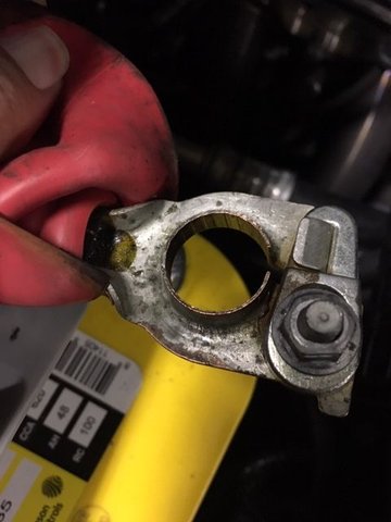

Old Jan 22, 2019 | 11:41 PM
Got uid0's Avatar
Got uid0
Joined: Mar 2002
Posts: 8,466
Likes: 51
St. Jude Donor '17
I have checked it and it seems ok. Battery volt meter terminal test shows 12.6v DIC shows anywhere 14.6 - 15

Grounds don't look bad.
Personally I'm very averse to using nonfactory wiring or alarm kits because I've seen multiple issues similar to this caused by them even though everything appears completely fine.
That said I'd pay close attention to the cable integrity of everything near your headers.
