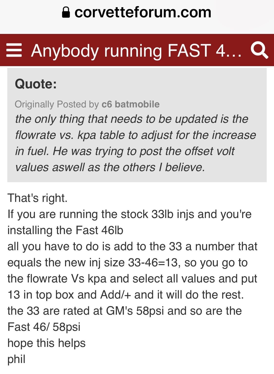

Found this on a previous thread.

schpenxel's Avatar
schpenxel
Joined: May 2004
Posts: 16,667
Likes: 1,209
From: Raleigh, NC
St. Jude Donor '15
No.
Old Mar 17, 2019 | 07:58 AM
jim2092's Avatar
jim2092
Veteran: Marine Corps
Joined: Jan 2005
Posts: 1,827
Likes: 301
From: Tucson Arizona
St. Jude Donor '08
Originally Posted by schpenxel
No.
Right, as always.
