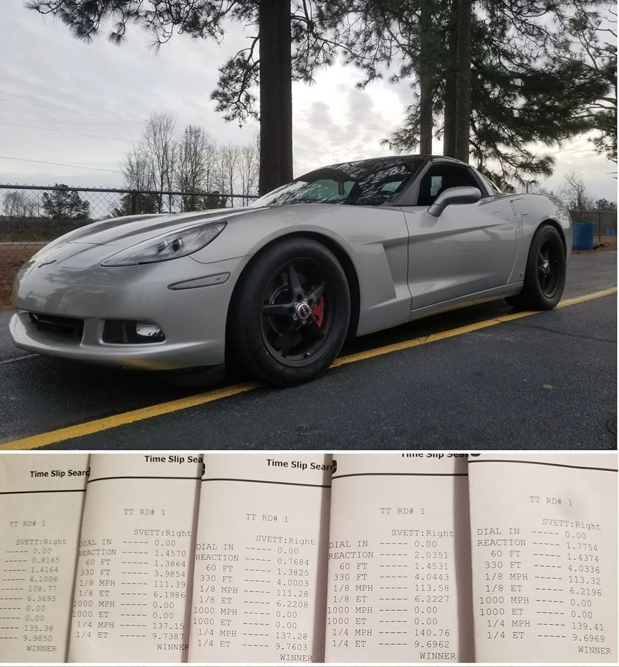

Default Finally went 9s!!! Videos inside
So long story short I've had my corvette about 2.5 years. I bought it and it ran high 11s trapping in the 11x area. Wasn't happy got it retuned added nitrous and the best pass back then was 10.9@126 all motor and 10.6@132 spraying 100 shot. Got a new converter moved to el paso went to a flex fuel setup. The best nitrous pass there was a 10.1@134 spraying a 200 with e85 shot with the da around 6,000. I ended up having my oil pump break so i pulled the motor changed the oil pump, and the cam. The car felt great moved to NC went to the track my converter broke again, i snapped an axle, the converter destroyed the transmission in the long run so i bought a circle d converter and plus a used 6l80 off ebay for $600 havent had any issues since.
Yesterday On pump 93 the car had the best et of 10.74 with the best mph of 128 all motor with a 28" tire. Spraying 100 shot with issues (fuel pump for my fuel cell wasnt hooked up oops) it went 9.98@135, a progressed 150 it went 9.76, 9.73, then 9.71 all those passes were on the factory front wheels and tires. I Jetted the car to a 175 still being ramped in and the car spun both passes but me being stubborn wouldn't soften the hit to come out the hole harder resulting in a 9.69@140 with the slowest 60ft of the day in the corvette.
Mods include Cam Motion custom grind nitrous cam,Circle D Specialties 258mm pro series triple disc converter, Kooks Headers and Exhaust 1 7/8" headers with catless xpipes Trick Flow Specialtiesgen x ls3 heads, Brian Tooley Racing valve springs,DSX Tuning fuel sensor, Nitrous Outlet c6 plate kit with a c6 stand alone fuel cell.
Tuned using
HP TunersNitrous Oxide System nos mini progressive controller, braille battery 17lb battery
9.6@139 pass 175 shot
9.7@137 150 shot
bonus video of my wife making her first pass in the car. It spun so she let out then got back in it.
11.1@128

Originally Posted by CI GS
It’s nice to see a simple setup like this knocking down 9 second passes at will, especially after having a number of setbacks.
I wish I could get my car to leave like this, although our track surface is crap compared to the one I see in that video.
I don’t see any suspension mods listed, so I take it the suspension is stock? If so, don’t let anyone talk you into wasting money on coilovers. At most, all you might need would be some decent D/A shocks in the rear.
Yeah everything is stock suspension wise. I was planning on some viking adjustable shocks or something along those lines. It was spinning on my 9.6 passes. Went from 1.38 60s on the 9.7 passes to 1.45 and 1.43 on my 6.9 passes. The track prep was on point but it was a rental. It could do better with new tires these are over a year old with over 1000 miles.
But even at test and tune I was getting 1.40 60s
