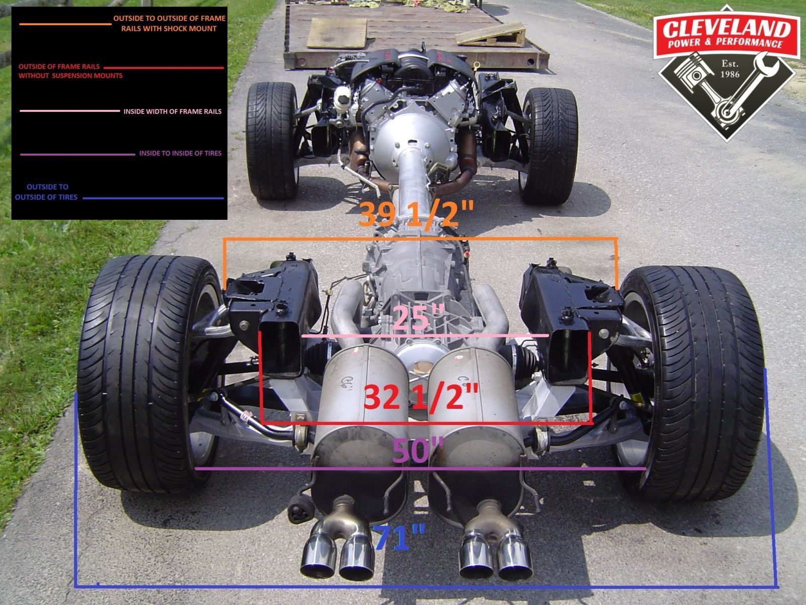

Does anyone here have a schematic of a C6 frame specs? Looking specifically for rear frame dimensions from ground to frame, diff/trans cradle mounting surface to ground, frame width etc.

Probably not what you're looking for but here is what I looked up while trying to choose a suitable hoist.
