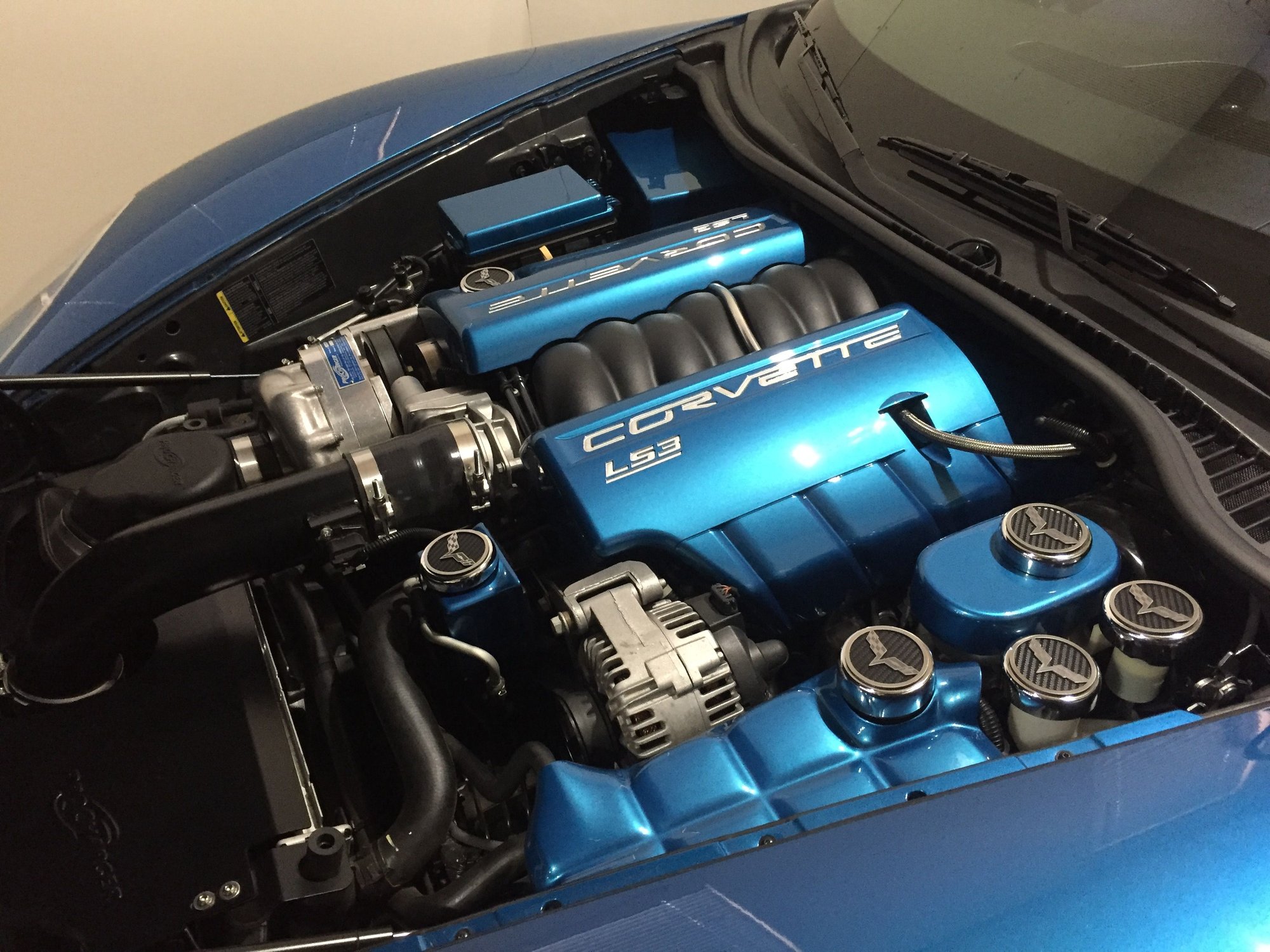

ProCharger D1SC. 565 RWHP with conservative tune and happy with it. Changed tires to Michelin PS4S which improved ride quality and hooks up pretty well. (Goodyear Eagles spun ALL the time!)

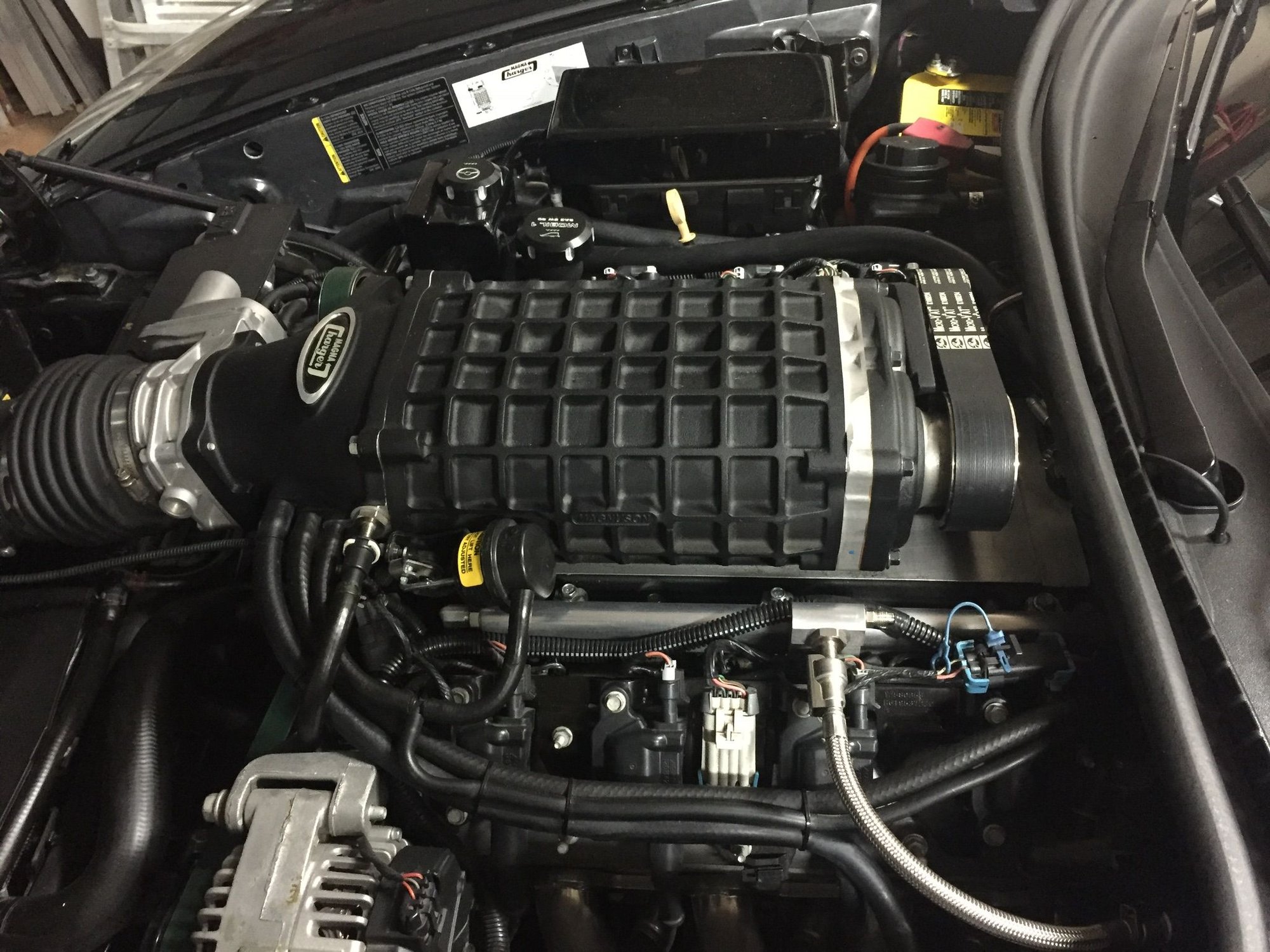

On my 2011 GS, I installed the Heartbeat SC:
Just looks AWESOME sitting there let alone the awesomeness of feeling the extra power at the throttle on the road! Must be one heck of an adrenaline rush!!!

Myself and my son-in-law installed the SC in my garage ... No special tools or lift needed, and the hood don't even need to be removed.
Now, for the harmonic balancer ... As with any SC install, the HB will need to be pinned. We did not want to tackle that job (a big big pain in the ***), so I paid a shop to replace and pin it prior to us installing the SC.
Hunh...didn't know you could do that. Pinning it and tapping the oil pan for non contained units are my biggest concerns, although I guess the latter is moot since most are contained.

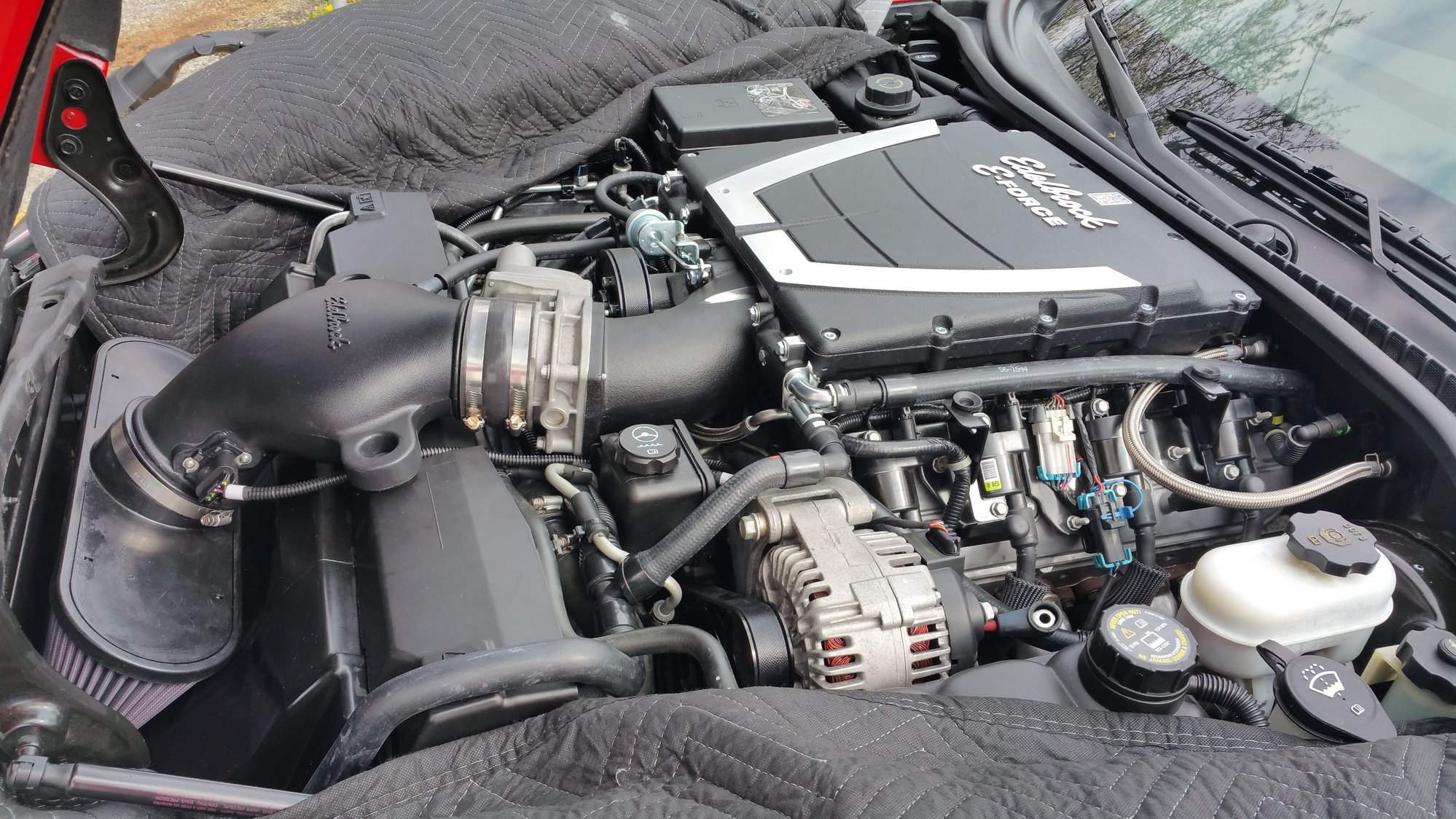

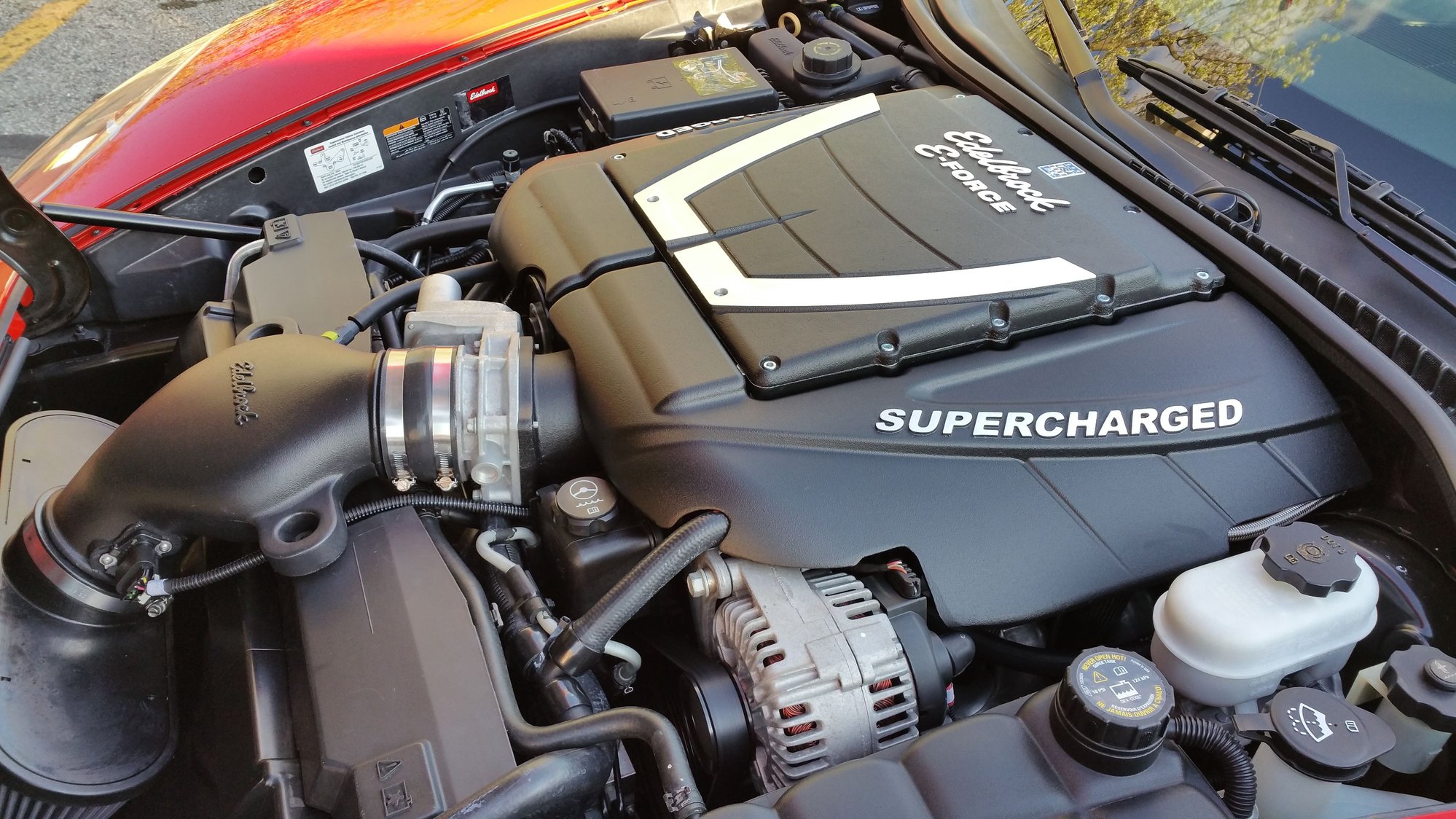

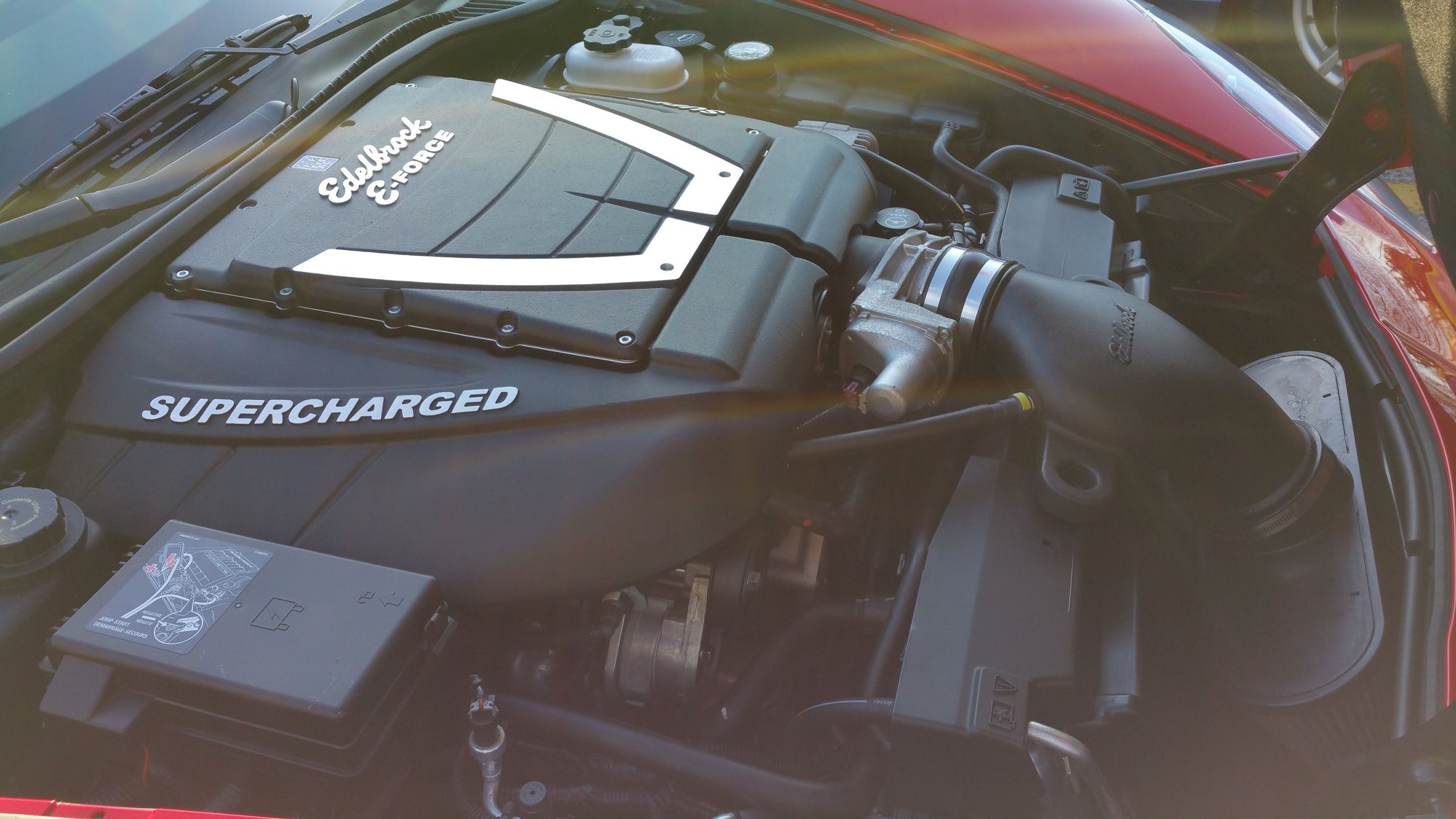

I finished installing an Edelbrock E-Force on my 2011 Grand Sport about 3 weeks ago. I installed it myself with about a total of 20 hours of actual working time. Can be done on jack stands with hand tools. And can be done in less time but I also installed a DeWitts radiator for additional cooling. I installed the 554 Hp kit. But I decided to get the 3.5 inch pulley and a Boost-A-Pump to upgrade to the 599 Hp level (the 599 Hp upgrade kit from Edelbrock is massively overpriced). The engine calibration is the same for both Hp levels so I figured why not.
The GS is no slouch at the stock 436 Hp but going to the 554 or 599 Hp level just makes the car so much more confidence inspiring and that much more fun.
Turbo6TA's Heartbeat install is super clean and looks great. I actually think the Heartbeat looks little better in the engine bay than the Edelbrock. I was a bit impatient and if I would have ordered the Heartbeat, it was a 3 week wait for it to ship while the Edelbrock was a 3 day wait. I think the Heartbeat does have better written instructions but Edelbrock isn't too bad. Both will get to you the same place.
