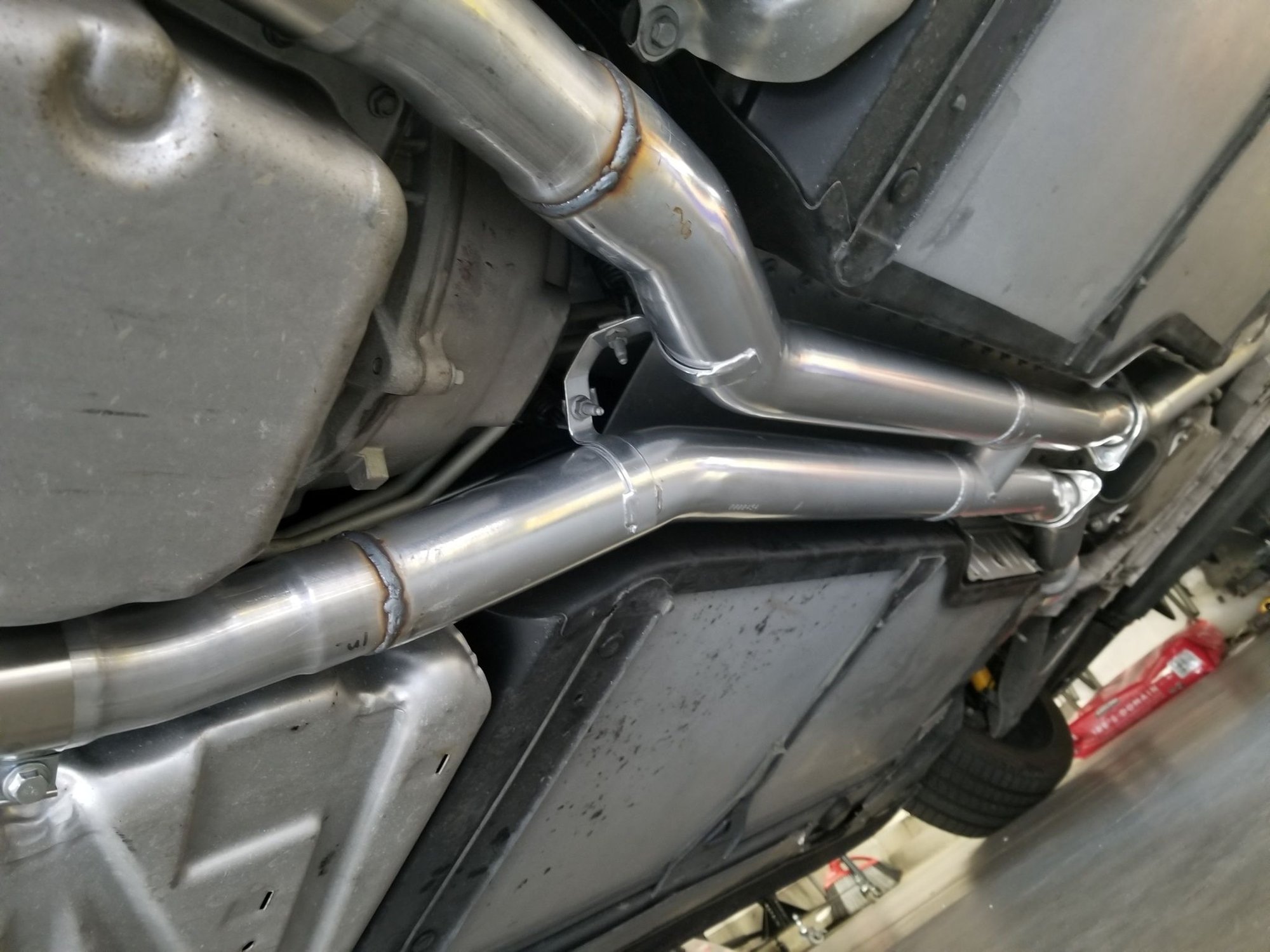

I just did this project a few weeks ago. You would be better off modifying the X or H pipe at the axle/ transmission end. You might be able to modify the down pipe to fit the 2.5in connection but it will be more work which will cost more. As you can see it's not that much work to get around the A6.
Final result
