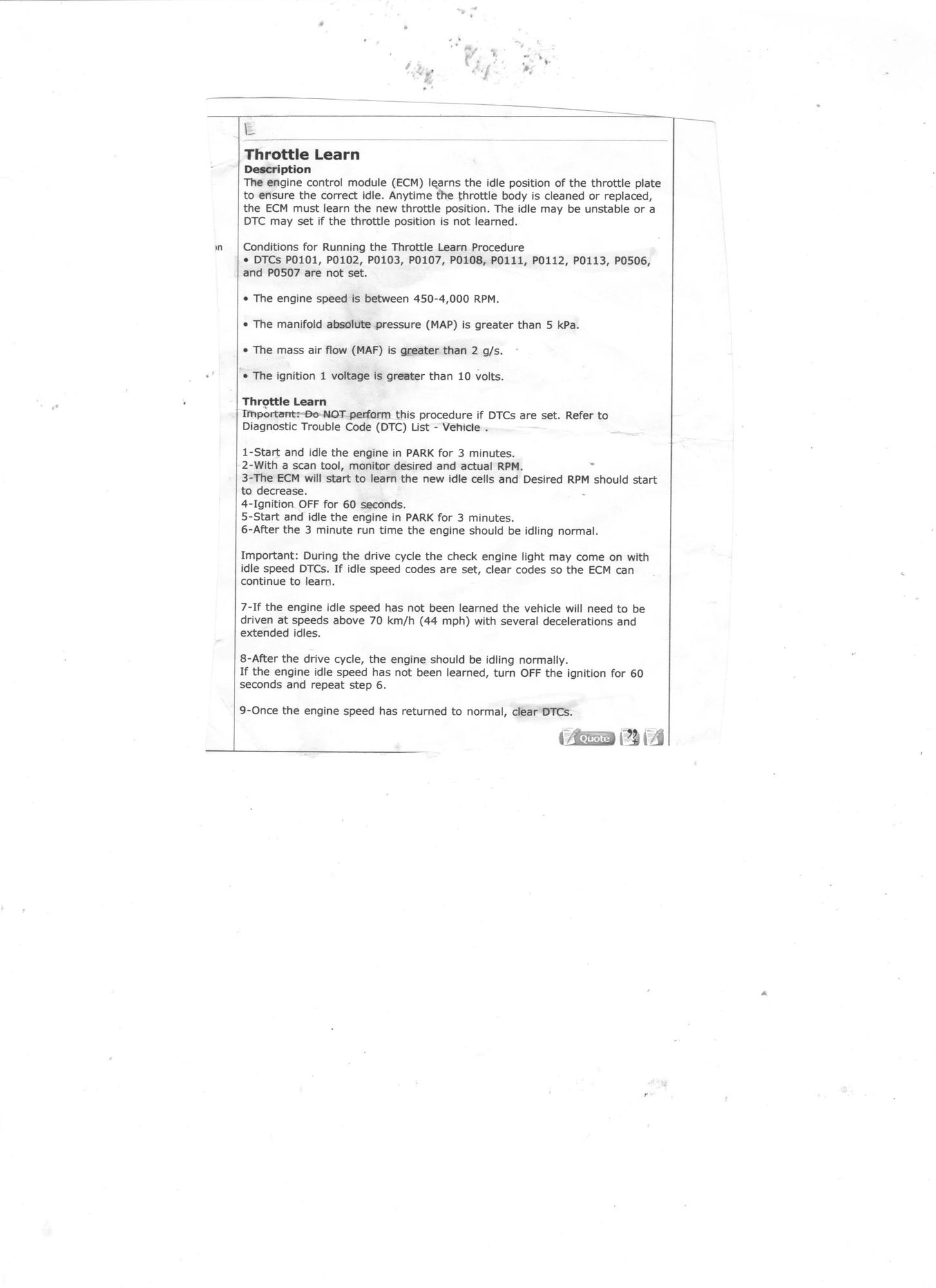

No I bought it from Corvette Central and installed it. The dealer wanted $1200 to install a $400 part. How do you perform a throttle relearn? I had read in another forum to disconnect the battery, put the leads together for 2min and then hooked it back up, but didn't fix anything. Still idles high.

I copied this from this forum a few years ago.....Want hurt to try it...Good Luck
