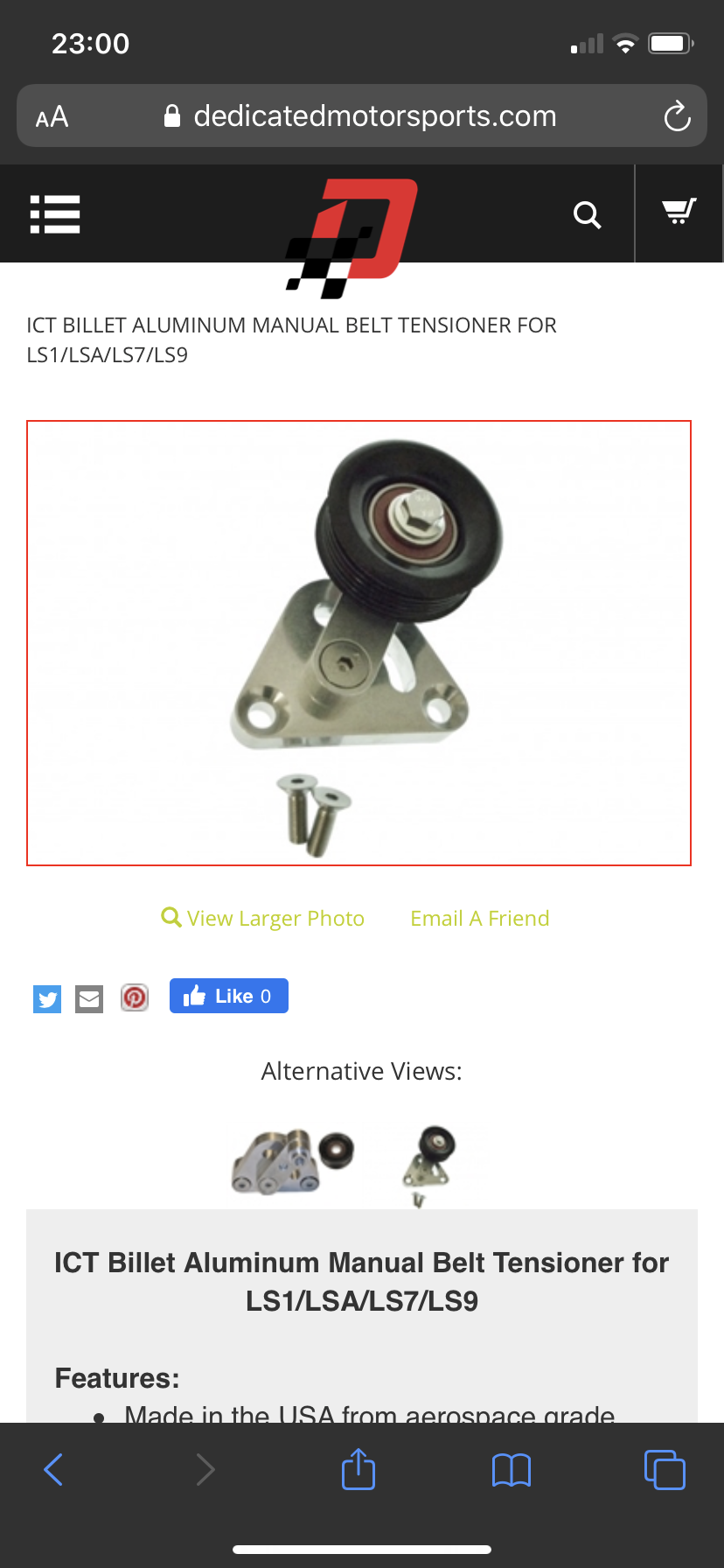

but I did find this and it looks promising doesn’t say “no supercharger” either
This with the billet pulley 👍🏻
