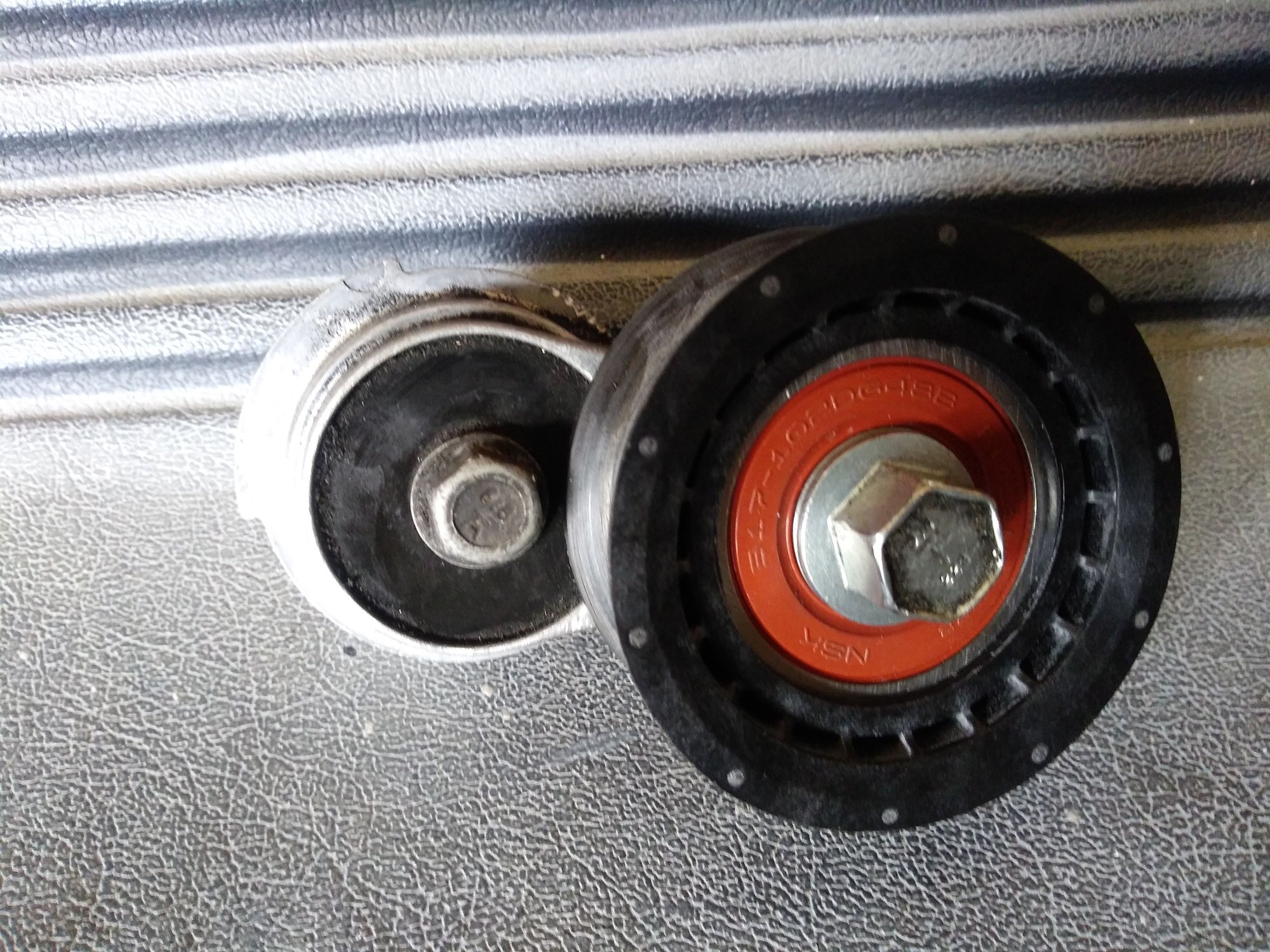

Anyone else having issues where the A/C belt is coming off the tensioner? Three times in the last year my A/C belt has come off due to excessive belt whip and sliding off the backside pulley. I already replaced the tensioner last year. Today I got another tensioner and replaced the 4 rib pulley with a 6 rib back side pulley with same dimensions. I made a few hard pulls today and so far it's holding. I noticed when I pulled the old tensioner out the belt was riding towards the far side of the pulley. The belt is now centered on the new pulley now. Here is the part number of the new pulley made by Gates: 36322

I had already replaced belt and tensioner before and belt continued to jump off due to hard pulls causing nasty belt whip. Made more hard pulls today without issue. You can see in the pic how close to the outer edge the belt was riding. You can also see the wider replacement pulley on the right. I replaced the balancer years ago with ATI Superdamper.

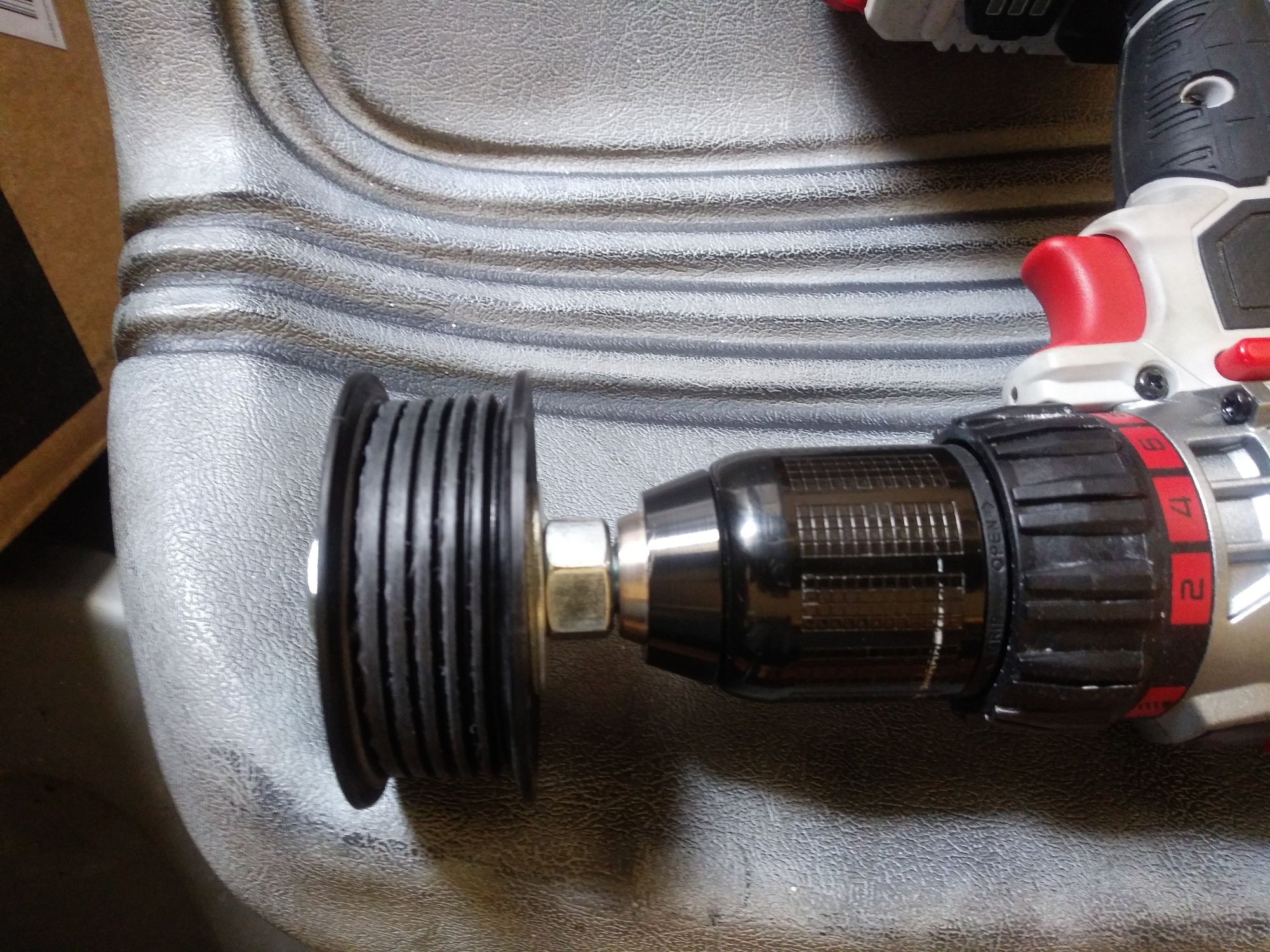

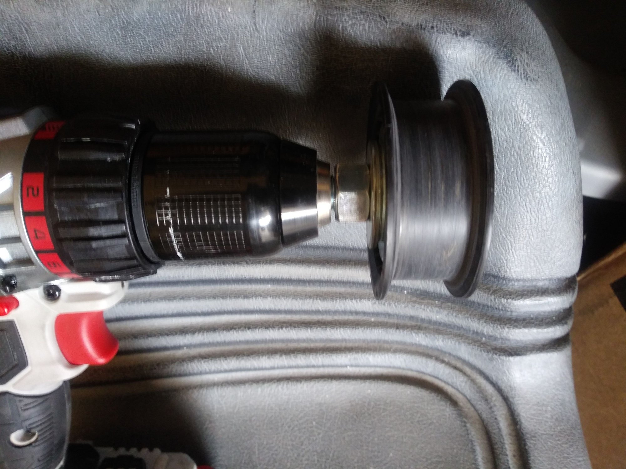

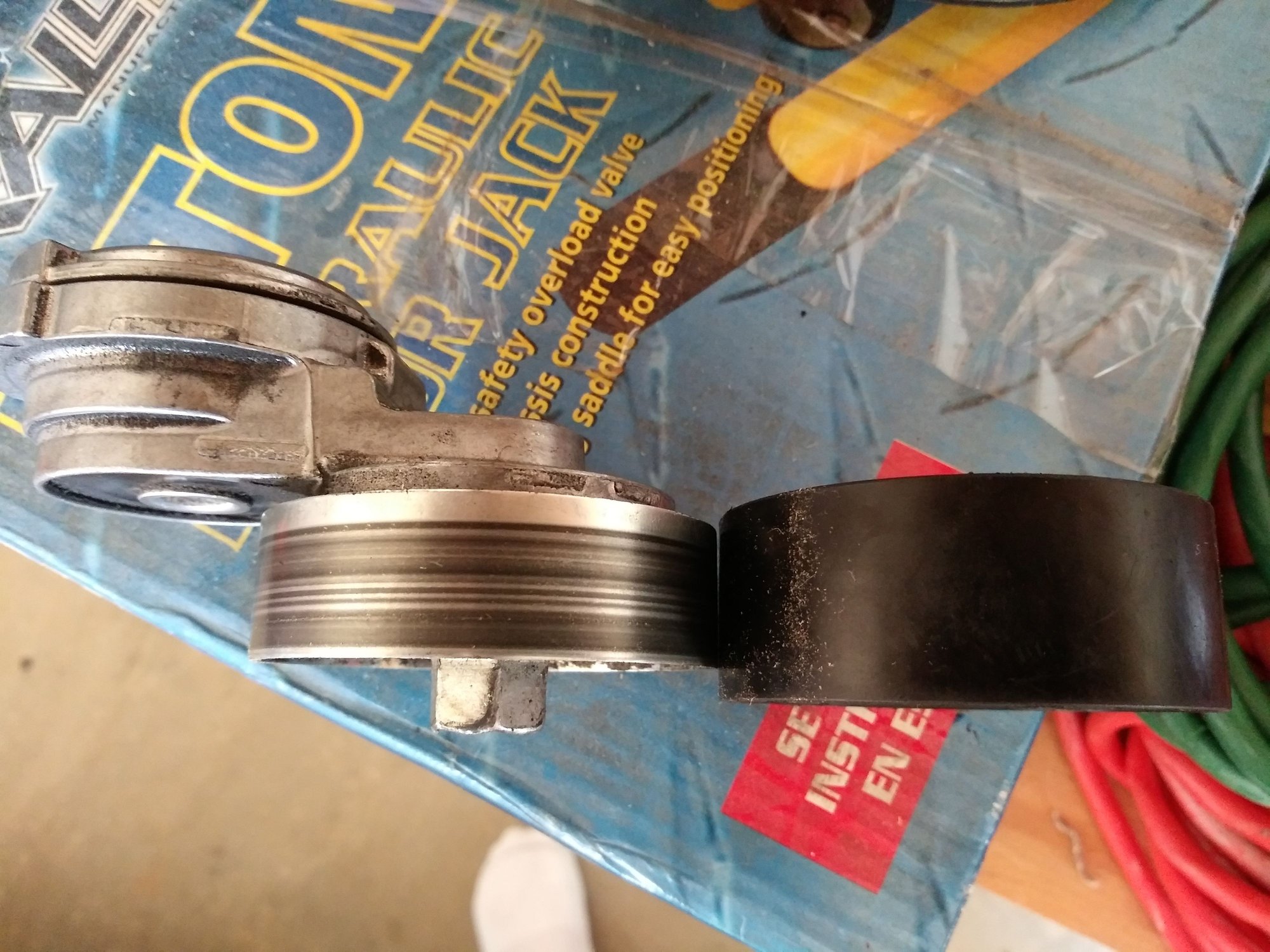

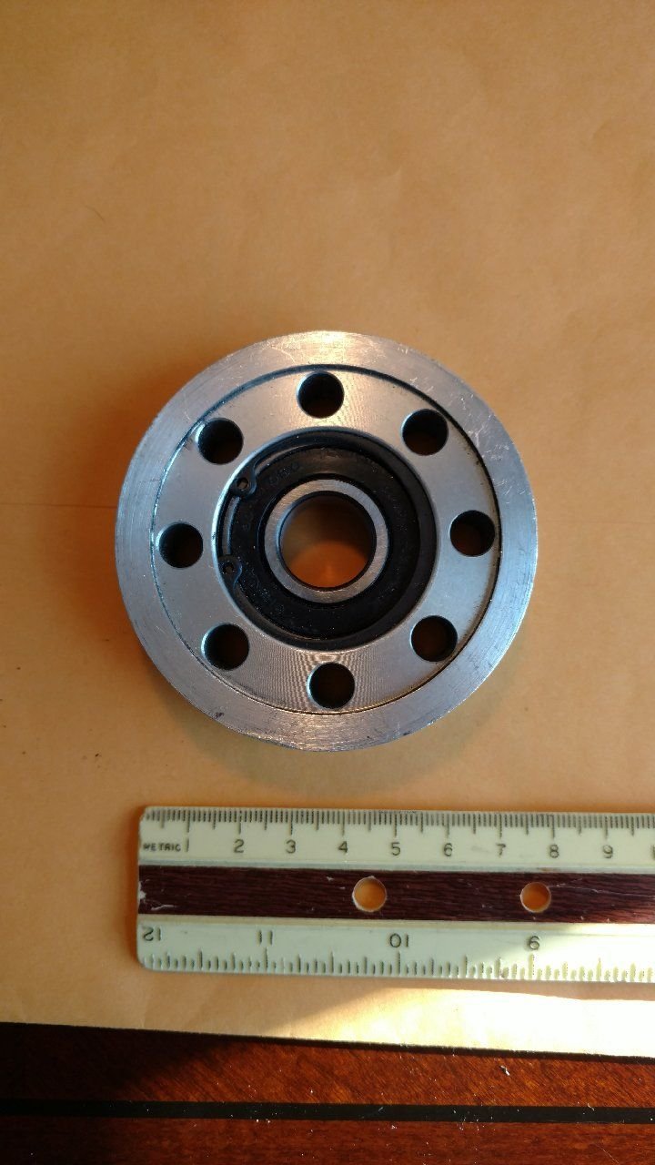

Figured I would update this post...The wider tensioner pulley worked for a while and during hard pulls the AC belt slipped off twice now damaging other idler pulleys in my setup. I decided to look for a smooth backside pulley with flange, but guess what? No one makes one for this setup. But they do make on with groves, so I bought one and removed the groves to make my own pulley. See pics. I'm going to install and post my results in here. If anyone wants the pulley part number, I can provide it. I had to purchase some hardware to make this work.
Mounted pulley and started to remove groves with metal file.
All groves removed.
Mounted on AC tensioner.

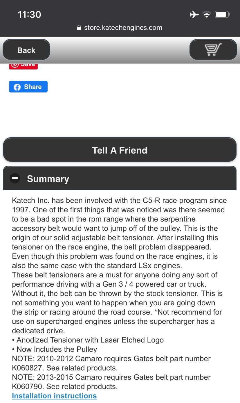

So I looked into those beefed up manual tensioner but why do they all say “not for supercharger applications”?
only reason I haven’t got one, every billet manual tensioner has this little note 👇🏻

"Not Recommend for use on supercharged engines unless the supercharger has a dedicated drive" The AC belt has nothing to do with the main belt that drives the SC, so it should work for you unless I am reading it wrong?
Right, and I don’t have a dedicated drive set up and I don’t think OP does either, all the billet tensioners say this though, without the dedicated drive the ac belt runs on the balancer just like the blower belt

I looked into that setup a while back and it wouldn't be able to replace the A/C tensioner setup as it is a single bolt mount. I thought about sending a stock tensioner to a machine shop to build a custom manual setup as a last resort

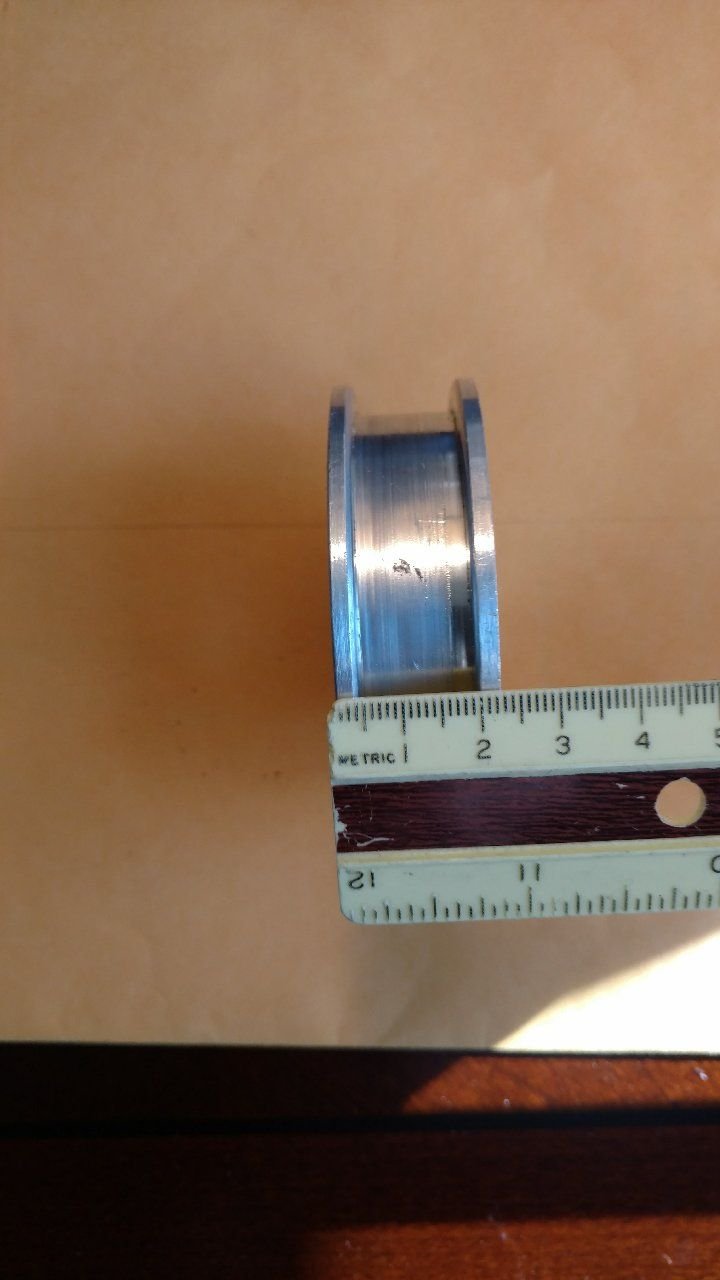

Gentlemen, I am selling this aluminum pulley for $40 shipped in USA. This was off my C6 Z06. I had it on my car for like 1,000 miles before I realized my balancer was the real issue. It is for the AC pulley (4 groove in width) it is 65 mm in diameter (without the shoulders) and is smooth. Here are some photos. PM if interested.
PM sent
