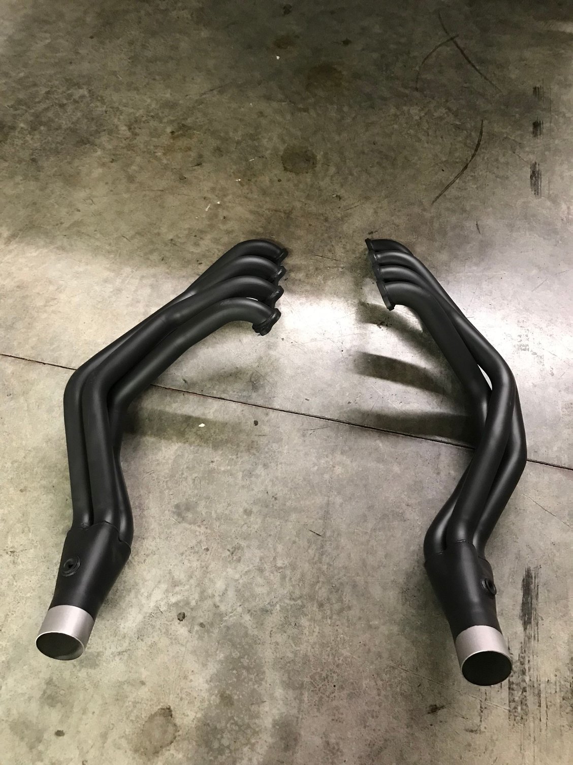

I went with Hinson brand headers and couldn’t be happier. The finish looks nice for now and fit perfectly having to make ZERO modifications to the headers or to the car. I have what used to be a Bassani cat-back but since I’m not running cats anymore we will just call it a Bassani exhaust. The reason I bring up the rest of the exhaust is because of the way it’s designed. Where the factory intermediate pipe “x” section went is where the Bassani muffler fits. It has the crossover pipe built in for a very unique sound. There is not a header manufacturer who makes a x or h pipe that would bolt to my exhaust except for Billy Boat. After looking at the Billy Boat and contacting a vendor about them I decided to go a different route. The vendor was nice enough but wasn’t listening to my needs. He kept asking me over and over why I wanted the Billy Boats. That didn’t give me a good feeling about the headers or the vendor. Anyway, moving on...

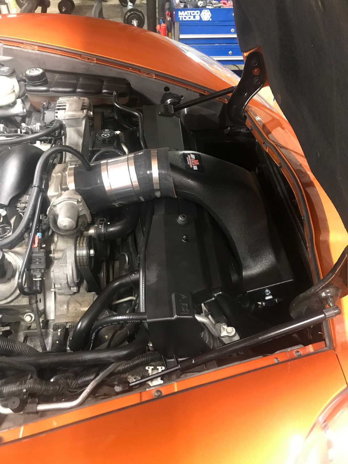

Knowing that I am getting a tune, I wanted to go ahead and get a cold air/ram air kit and a vendor on here had a sweet deal on a Vararam kit so I jumped on it. $350 shipped and I feel good about it. It cleaned up the engine bay a lot as I wasn’t a fan of the look that the factory air box had. I like the Z06 box without the silencer but felt like if I bought this that there wouldn’t be anything left on the table power-wise.

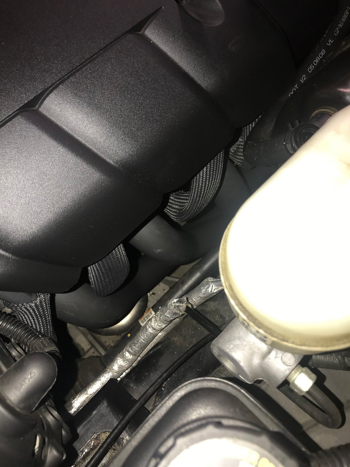

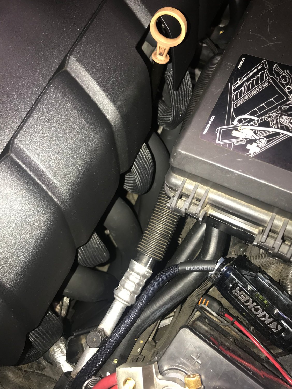

I did everything at my house, on the garage floor with jack stands. The hardest 2 parts of the job were removing the original spark plug wires and routing the oxygen sensor extensions. Mistakes that I made, the very first thing that should be done with all of the old parts out of the way is to figure out exactly how you’re going to run the oxygen sensor extensions. I chose to do it last so the passenger side header (the easier one thank goodness) had to come back off. I also forgot to remove the old rear oxygen sensors before I put the headers on. There is no way to get the passenger side rear oxygen sensor off that I can see with the header installed. Another “dammit” moment.
I first want want to say that I’ve been a Mustang guy all
my life and putting headers on Mustangs with mod-motors involves dropping the cradle. It’s a minimum 8-10 hour job, on a lift, with help and an alignment to follow. The C6 appears to be built, straight from GM with long tube headers in mind. This job was so easy that my wife kept asking me what I was laughing at. I was laughing because it was SO EASY and everything fit perfectly. I wasn’t even too upset when I learned I had to take them back off again to handle the O2 extensions.

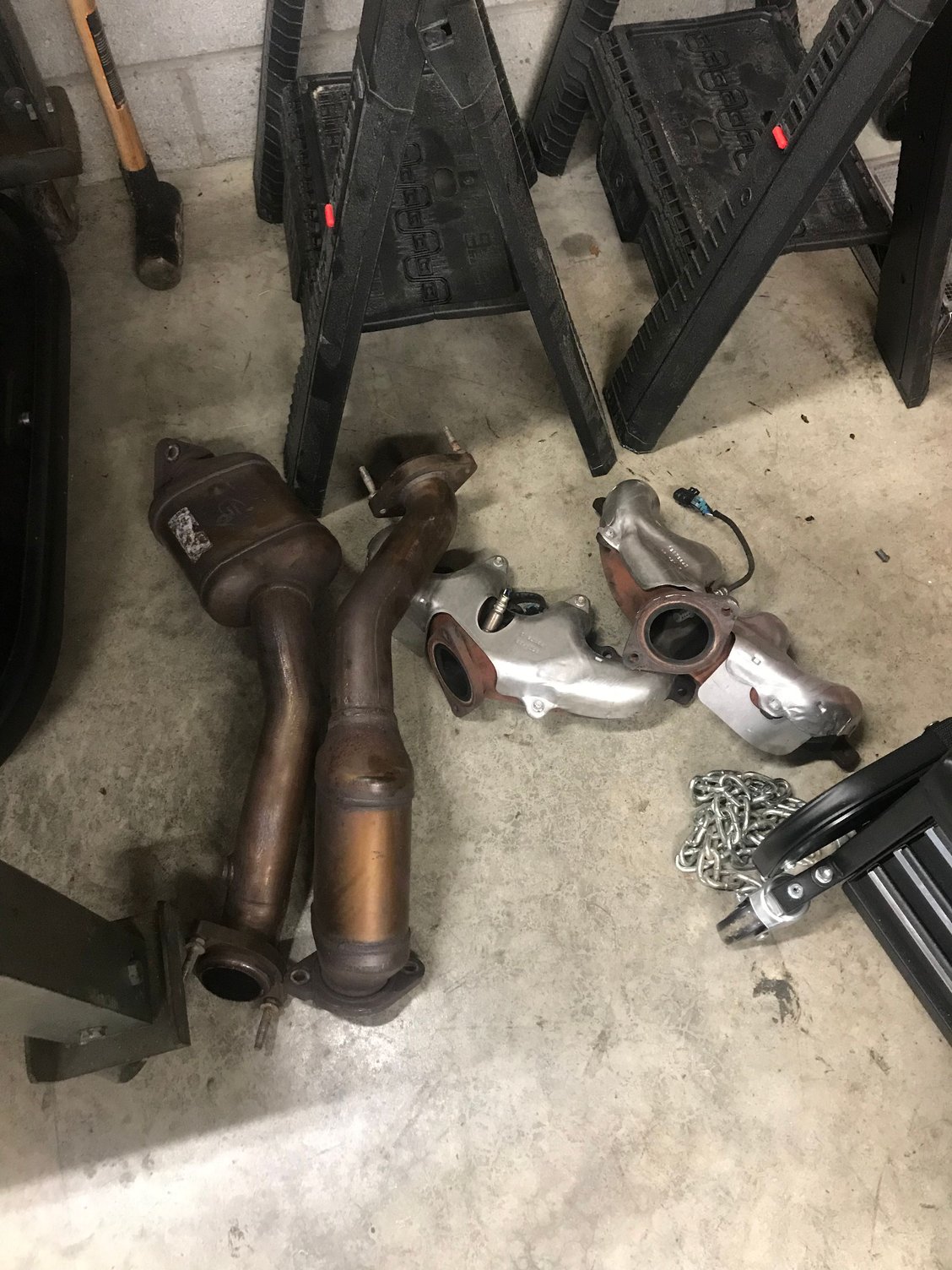

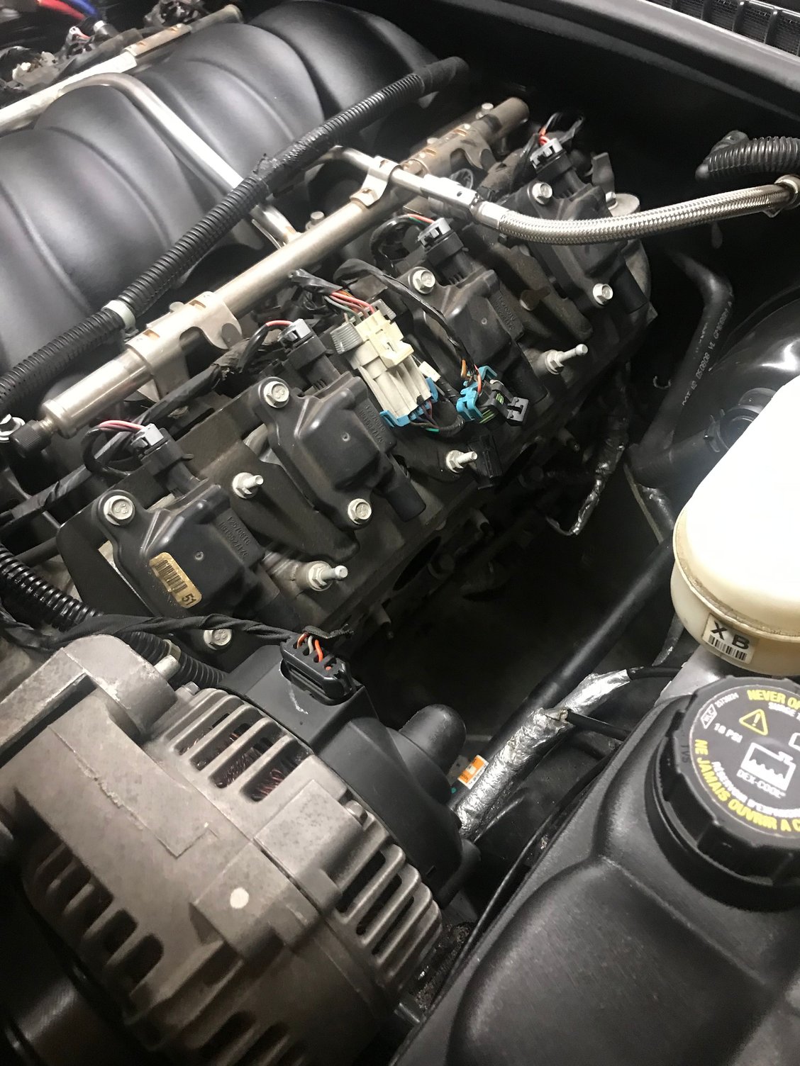

Stock parts off
New Vararam ram air kit
Something’s missing!
My work space

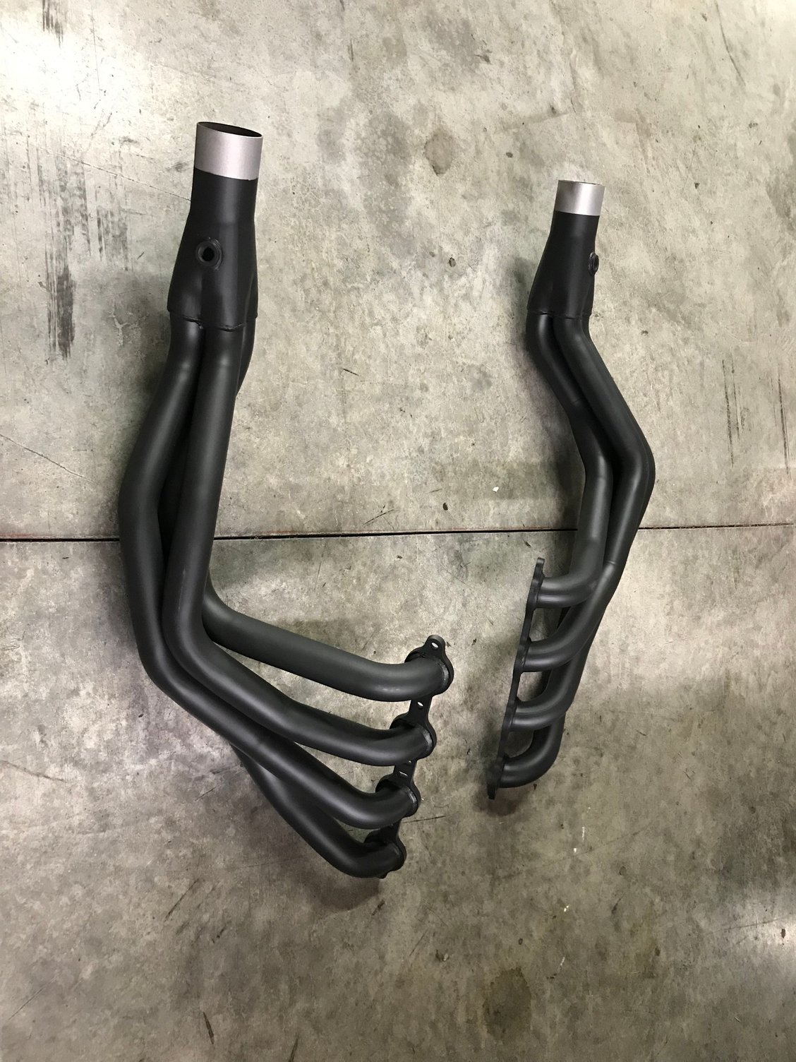

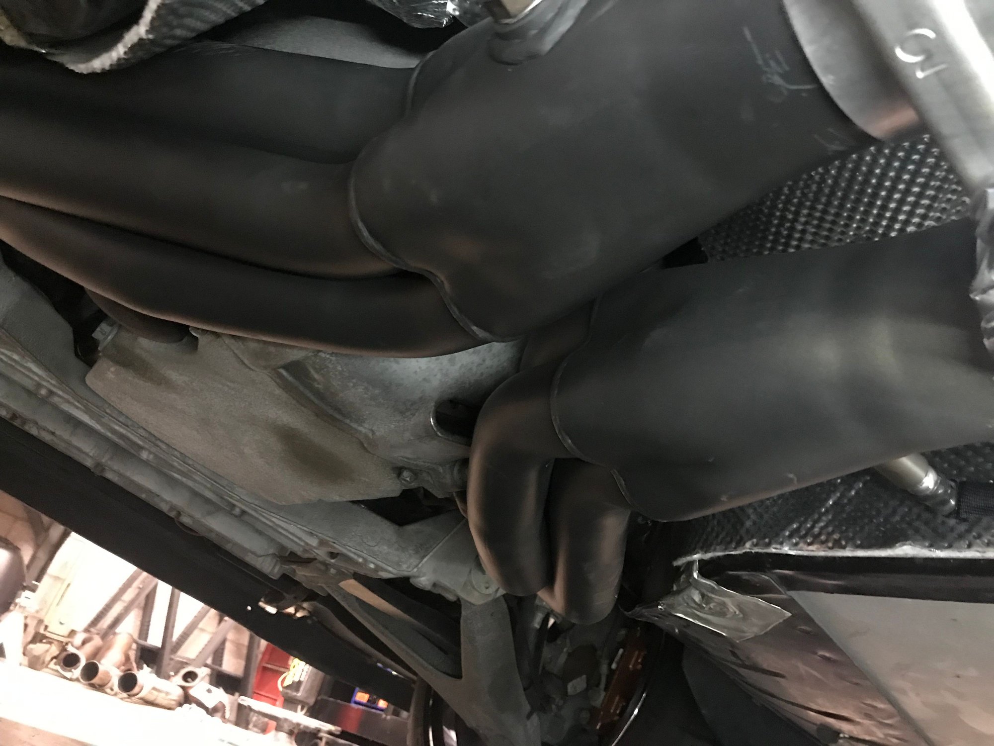

Hinson coated 1 7/8 headers
Very pleased with the quaulity
Very discreet
Almost looks like it shoulda come this way!

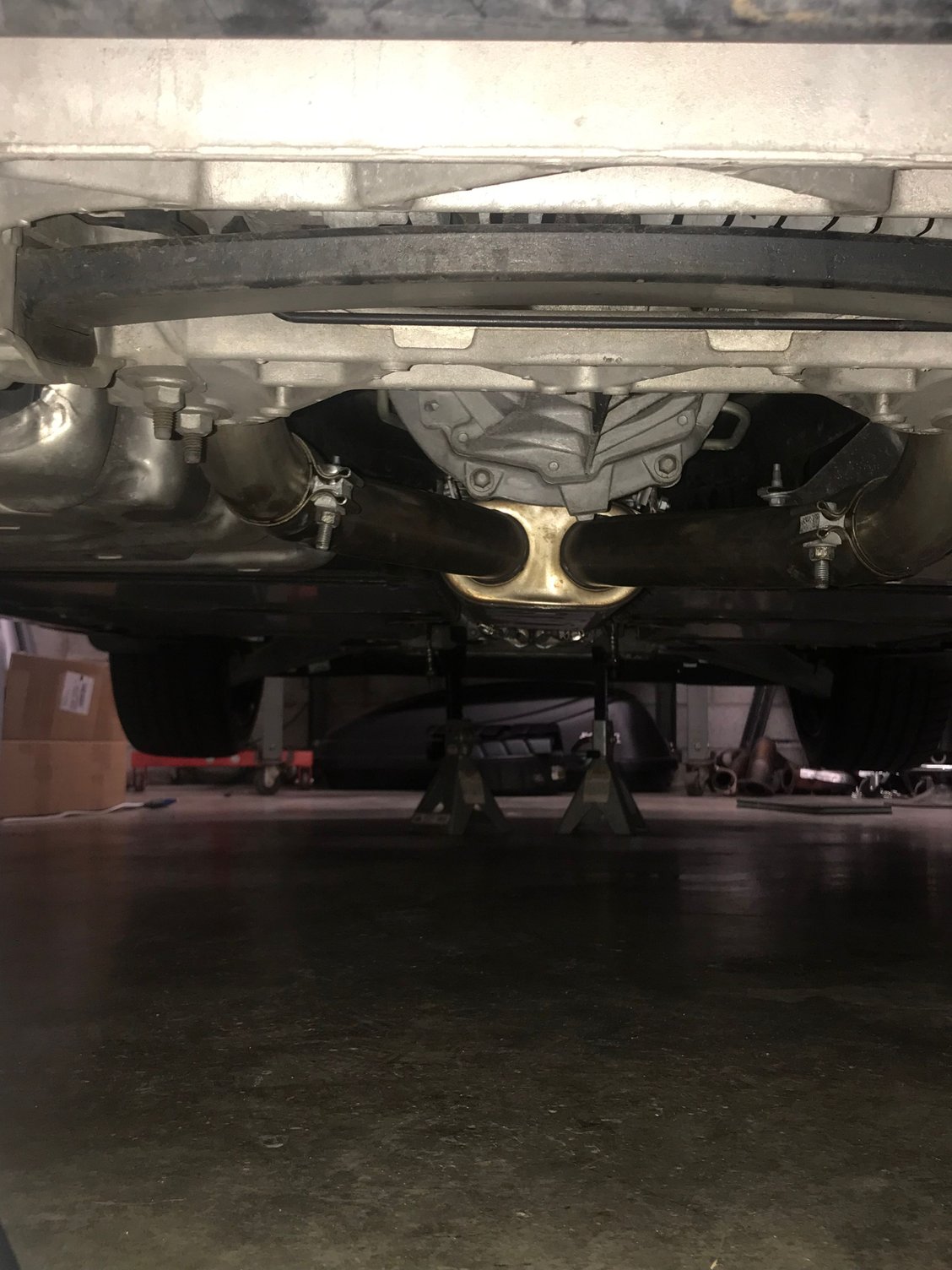

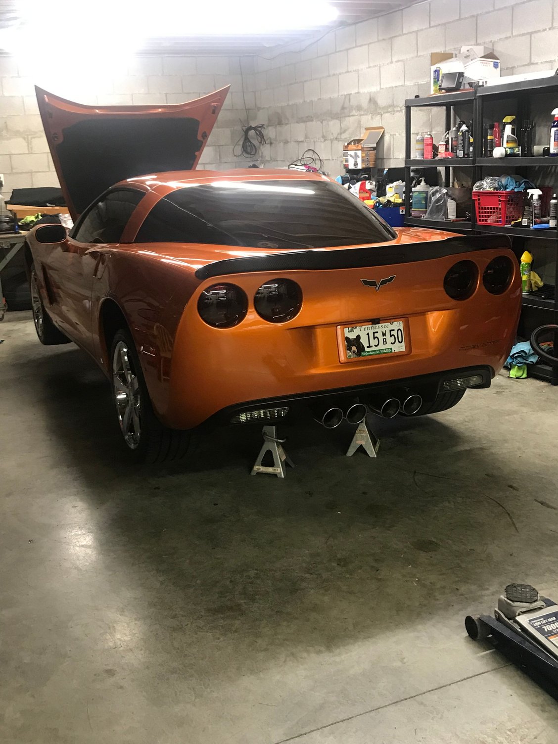

I did some temporary turndowns until I can get to the exhaust shop. Didn’t want to create too much heat under the car on the drive to the exhaust shop. My neighbors will hate me...
Perfect fit, zero modifications. Thank you Hinson Motorsports for supplying me with such an outstanding product!
