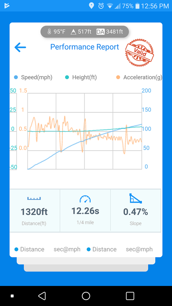

Toyo R888Rs will work great. Here is a run using a Dragy device the other evening in my '84 w/ tko 600 5 speed and 6.0 w/ LS3 top end, 220/224 cam, 1-7/8 long tubes. At that power level, I think your trap is just fine for the DA. Most of those hero runs on the fast list are done in low to negative DA. I would think normal traps for a stock LS2 would be in the low 110s with a 2500 DA.
