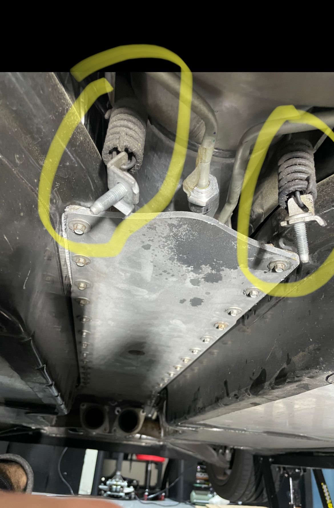

Have you checked the springs that hold the exhaust? It can cause a rattle. I had to replace mine before. They are located in front of the trans at the back of the torque tube. Do you have an aftermarket axleback? If so check the clearance on either side of the trans by the frame. Sometimes they are too close an can hit the frame and cause a rattle.
These exhaust springs?
You mean these springs right?
I think so. I've even lubed them up, shaken them, wiggled them... they SEEM fine...
The exhaust is all stock. It does have the NPP mild to wild though it doesn't make a difference which mode it's on...
Yes they are the ones I was talking about.

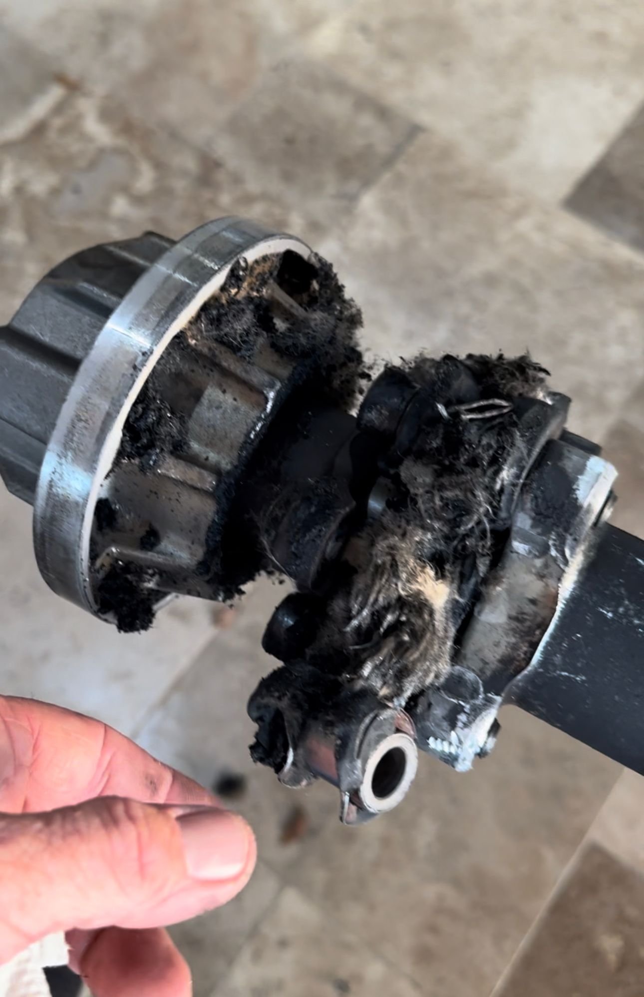

Originally Posted by Withnasty
Anybody that's had a failure in the torque tube, what were the early symptoms? M6 car sounds like rattling from under the car, weird vibration at 1500rpm and 4000rpm along with lots of movement in the shifter. Recently it's also started. Weird vibration/noise when taking hard right hand turns. This sound like couplers or bearings?
Im going to go out on a limb abs suggest that could be your problem...
I had no symptoms and just decided to rebuild the torque tube since I was having the transmission rebuilt and the clutch went out...
but when I took the torque tube apart... this is what I found..
