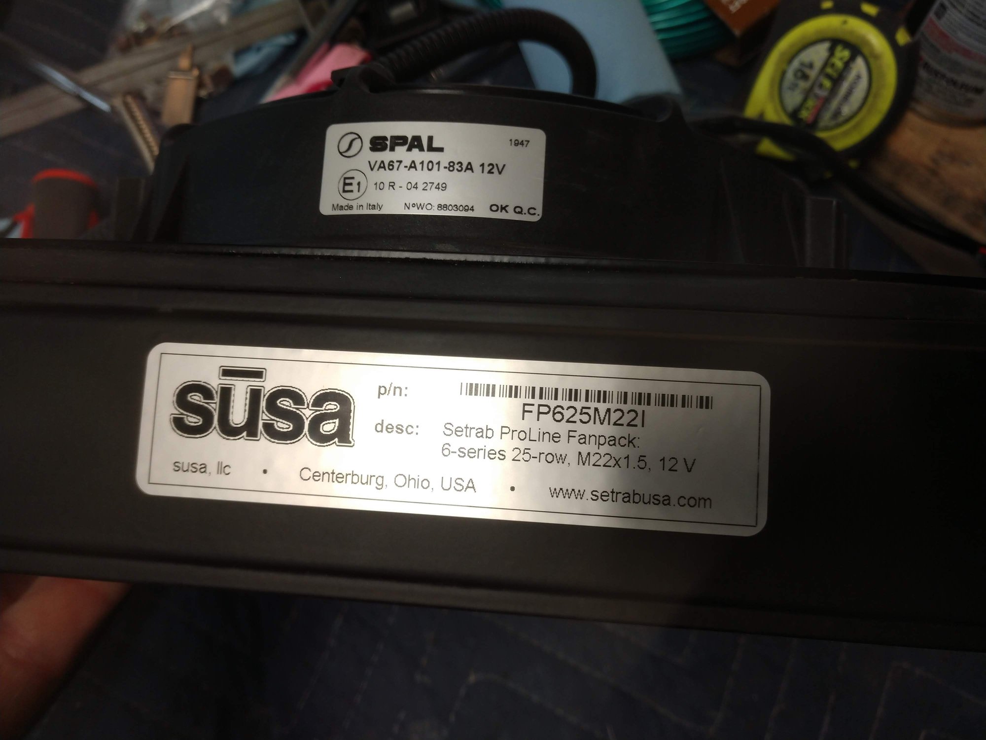

Setrab FP625M221 it's a 6 series 25 row with fanpack and it fits on the pass side but you should remove the foglight for airflow and drill holes in the fender liner.

Finally someone else with a similar setup to mine! I'm running a Setrab 6-series 34-row in the driver-side foglight area. I still have the light in place.
These have a LOT more cooling capacity than the B&M coolers that are popular. Mine is keeping 550 WHP with 3400 stall 3-disc converter under 210 °F on the road course and under 180 °F on the street (100 °F+ ambient temps). I am running mine with an Improved Racing inline thermostat to get up to operating temperature quickly.
