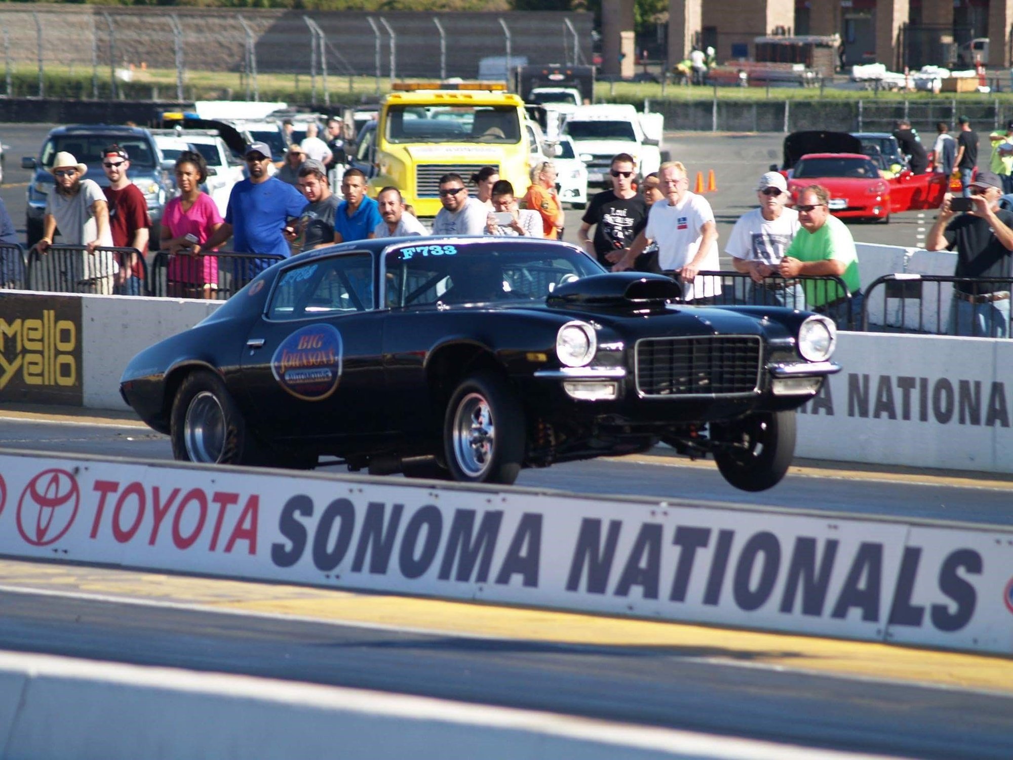

From last night:

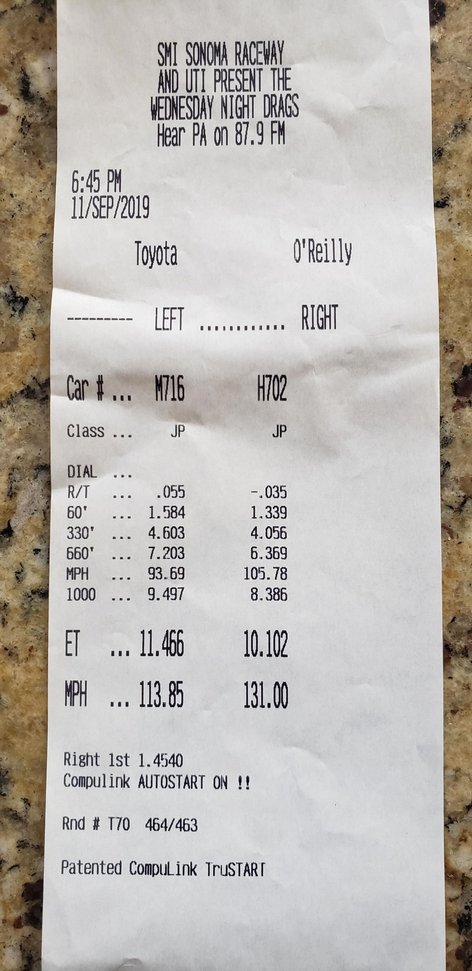

While I've been doing wheelies with the car for years, what makes this one kinda cool is that I was only launching it at 1300RPM without using my 2-step. There's a jackpot race coming up next week that doesn't allow us to use them so I tweaked my tune to have it idle higher, hence the crappy reaction time as I was still figuring out how to cut a light. Normally I leave at 1800RPM using the 2-step with my best ever 60ft being a 1.320 two weeks ago there.
What makes this even cooler still is that my 1.339 60ft was better than this guy's best of 1.340 and he's leaving at 5000RPM off a trans brake. I think his quickest time last night was 10.07.
Ya just gotta love how well that Yank converter is doing it's job!
Thanks again to Nick Bublitz for taking the time to record and post the video.

Awesome! This video is very instructional. A good video is truly the best suspension tuning tool.
Looks like you have that suspension dialed in perfectly with a clean, linear transfer, with no rear end squat. Perfect.
A 1.3x 60’ time is very impressive, especially considering that the Vette’s IRS and transverse leaf spring suspension was not “designed for drag racing”.

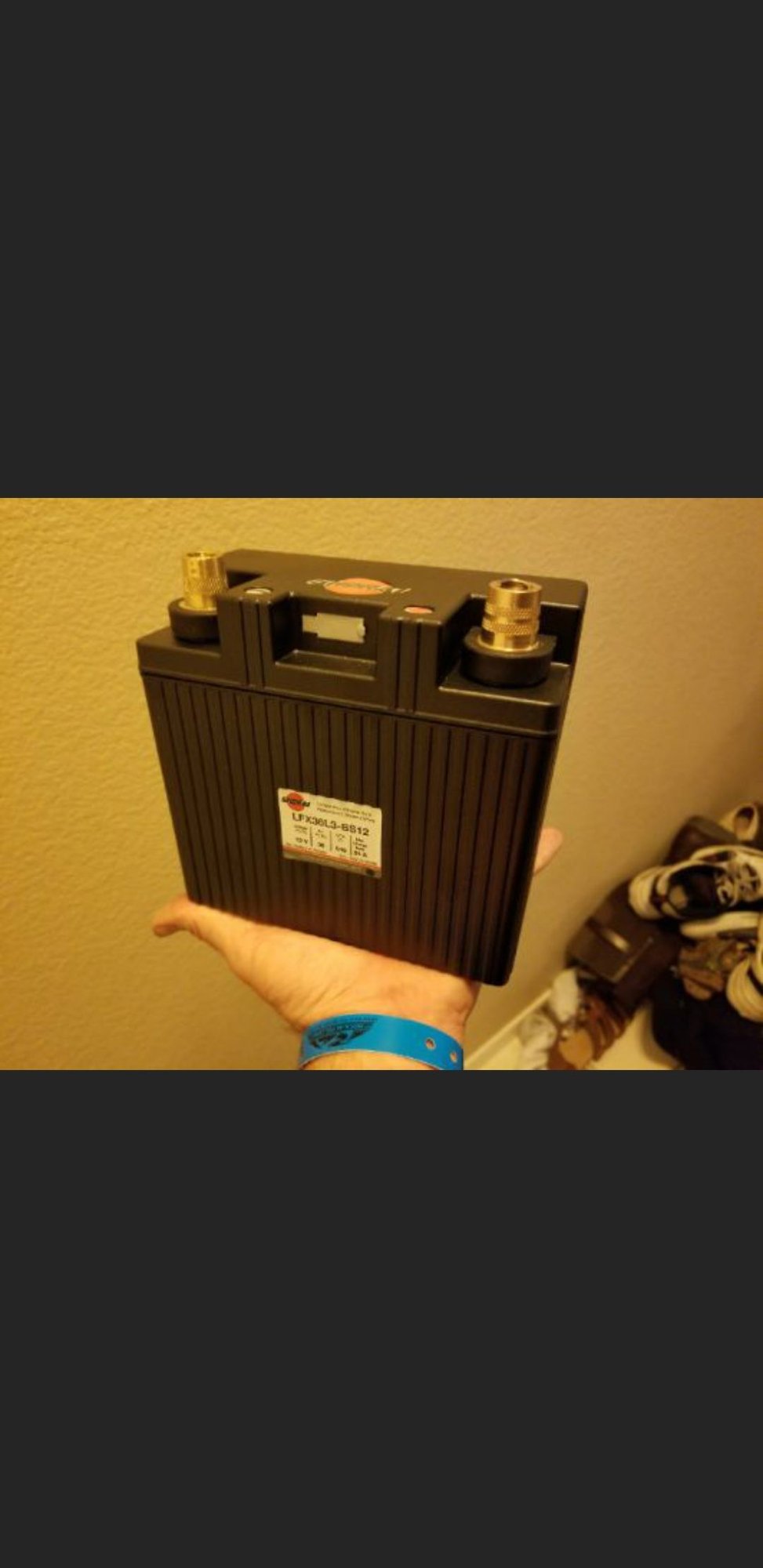

Yeah, I'm running a little 5lb Shorai battery.
