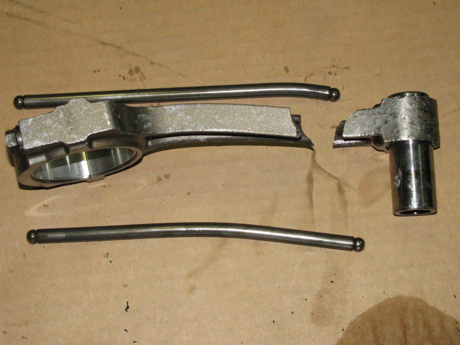

This was the result of a dropped valve from an over-rev. You can see a partial piston and rings along with rod caps in odd positions on the second journal.
Bending until the piston was gone and then breaking as the pin broke through the cylinder wall.
Salvaged the crank and a couple rods to make a TP holder for the shop bath.
I fully believe your rod failure was a manufacturing defect. If mine bent and twisted before it broke (above 7000 rpm) and I can't break any of the others by hand, I'd be getting some structural materials testing done on that one and all the others. If you can show proof of a manufacturing error, GM owes you a new engine plus all labor involved.

Ouch! this is what i would expect from an operator error. My rods were a clean snap. I'm sending rods to GM for a look but i expect to be told pound sand. What kind of racing did you do this engine in? What rpm? I have a matching crank if you want to get fancy in the shop bath.

It's been a lot of years and miles since that happened. IIRC, I was running a 3200 stall Yank, a Vararam, Z06 exhaust manifolds, and DR's at the time. On first pass of the day I spun on the launch, so lifted. Decided to get back in it to see if the high end and mph were normal. As the trans attempted to downshift, it apparently didn't complete the shift and over-revved. Exactly what rpm, I don't know. I later found out that the tune,(done by a NY traveling bovine tuner known on this forum), had the rev-limiter at 7150 and several trans downshift points set way too high and the upshifts above 6900. That's when I decided to learn how to tune for myself, instead of trusting someone who gets on a plane and never returns to this area again. I'm pretty sure it dropped a valve to start the death spiral, since I found lots of pieces in the intake manifold, including piston rings.
Actually, the crank only has a few dings on the counterbalances. All the bearing surfaces are perfect.
