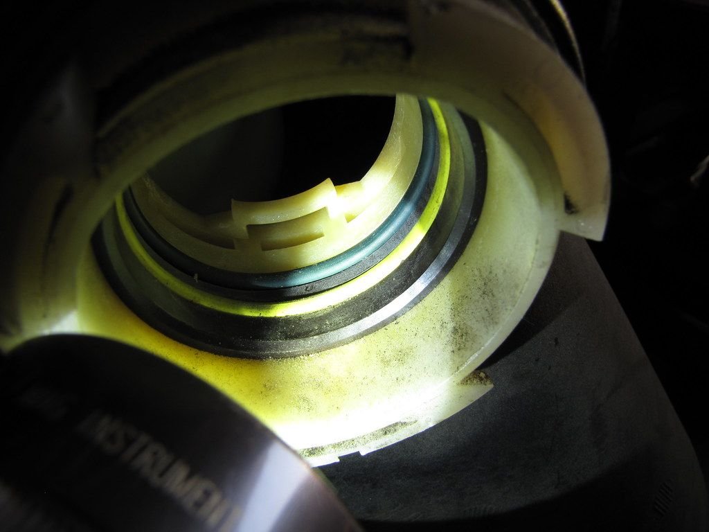

OK! When you disconnected the tank crossover pipe, all the o-rings and plastic rings spilled out were dangling from the fuel return jet-pipe. Before you could note the order they were in, the return pipe popped loose and they fell to the floor.
Now what?
You have a green o-ring, a yellow o-ring, a small black plastic ring and a larger black plastic ring with a beveled interior.
Put them back into the tank in THIS order.
1. Green o-ring.
2. Small black plastic ring.
3. Yellow o-ring.
4. Large black plastic ring with inside bevel.

Here is another suggestion that I found very helpful. A local certified GM corvette mechanic told me he always installs a new cross over pipe when dropping tanks. 5 weeks ago, I replaced the driver's side fuel sending unit in my C6 ZO6. Doing this on jack stands at home without dropping the tranny and rear end is possible but tricky. I finally ordered a new cross over pipe from a GM Parts Discount house for only $143. After messing around with the original one, this new pipe slipped in so quickly and easily. To successfully finalize a potentially brutal project, this new pipe, to me, was worth it's weight in gold
