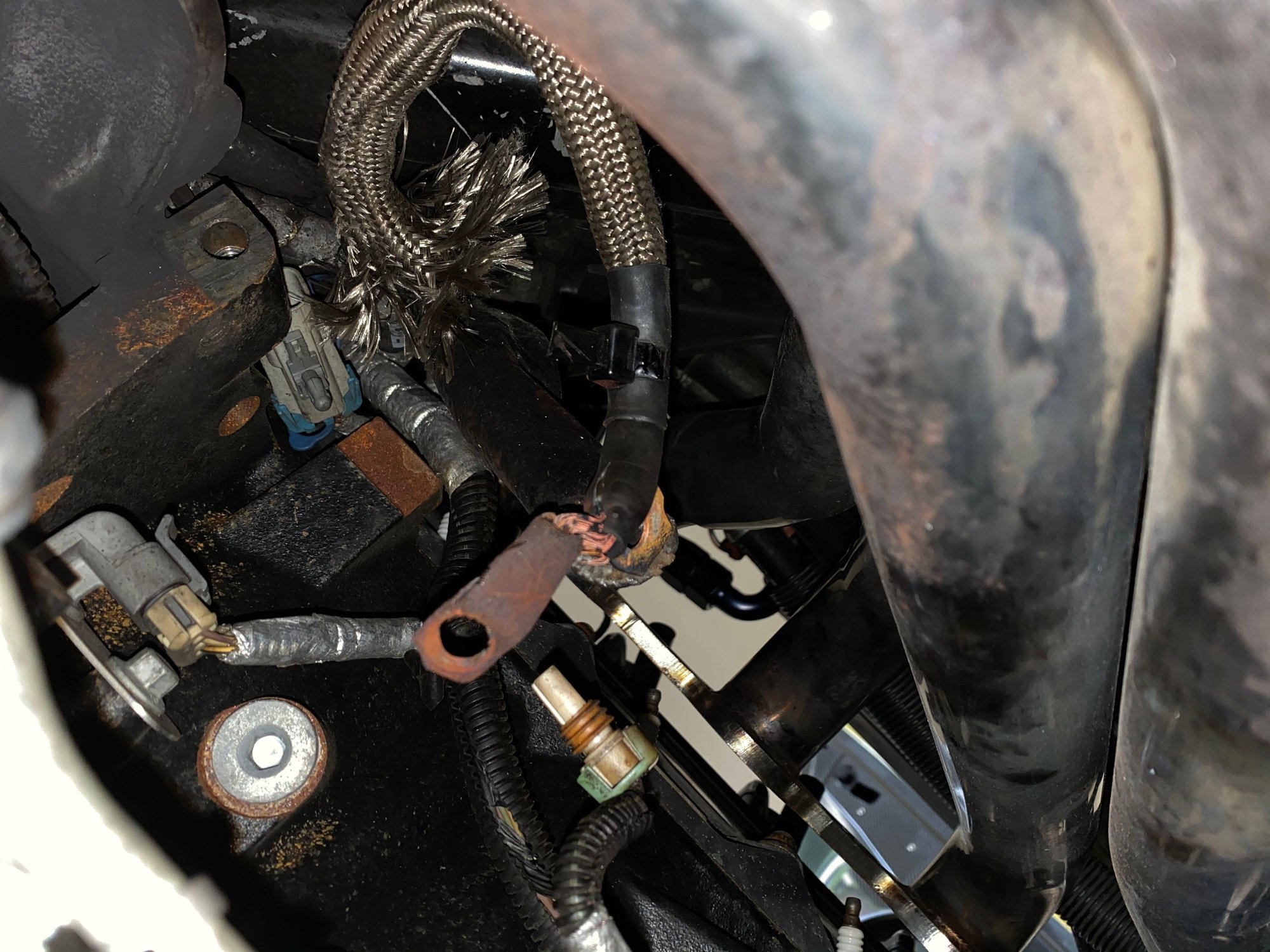

Does anybody know what the part number for the starter to alternator wire is on a 2012?...it’s a grand sport but the battery has been relocated to the trunk...I did a search and didn’t have any luck...the headers on the car burned up the solenoid and the one wire is in pretty bad shape so I’d like to replace it here’s a pic of it

Did you ever figure this out?? I'm in the same situation with my grand sport

It must of happened to the previous owner of my car but I got lucky and they replaced the wire with like a 7" piece of wire with lugs on it so I was able to just replace that. it seems like a common problem with these cars that have headers. I replaced that wire and installed a new starter and wrapped the started with a dei shield. no problems since (knock on wood)
