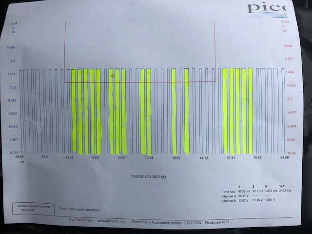

YES !!...anytime a motor is replaced you have to do the crank relearn...the crank sensor provides misfire info to the PCM...you can also get "phantom misfires"...flashing MIL but no actual misfires felt...as far as the 0340/0341 I would find a shop that can scope the cam and crank sensor too...my LS1 is a 24X crank and a 1X cam...below is my cam and crank signals taken with my scope...you have to make sure that you are getting the full amplitude (12 volts) on both and they line up correctly...the red signal is my 1X and the blue is the 24X...making sure they line up correctly is imperitive...as you can see the crank signals have wider and thinner "on-off" times !!
..we call it a "cam and crank variation" !!!...I believe your engine is a 58X and a 4X !!
