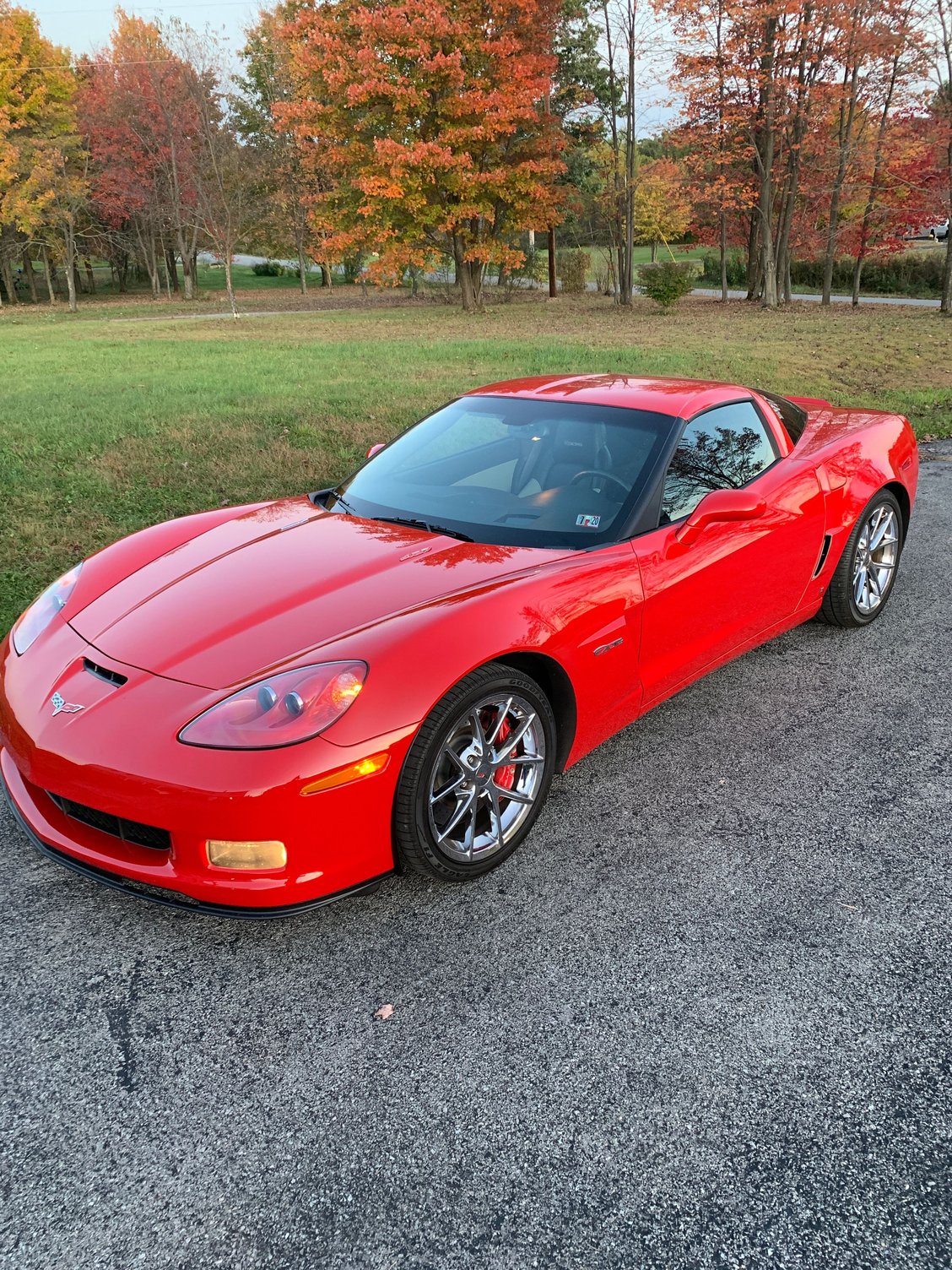

Need some help . My 09 Z06 keeps getting a po171 lean bank 1 code . Car will run shitty to the point where you can’t even drive it problem is it doesn’t do it all the time . You can drive for a day with no issues and then out of no where po171 code and car will barley run . I replaced the following . Btw Car only has 4,000 miles on it .
-all new GM fuel injectors
- new GM mass air flow sensor
- 2 new GM front o2 sensors
- switched coil packs , wires and plugs from bank 2
- fuel pump pressure at 65 psi and holds steady even when running shitty
- checked battery voltage on battery 12.6 volts
- checked everything for vacuum leaks
- flushed fuel system several times
also before anyone says anything I recently bought the car in July with 3,100 miles on it so I’m not the one who left it set lol . I would love to be driving it before winter hits ...
