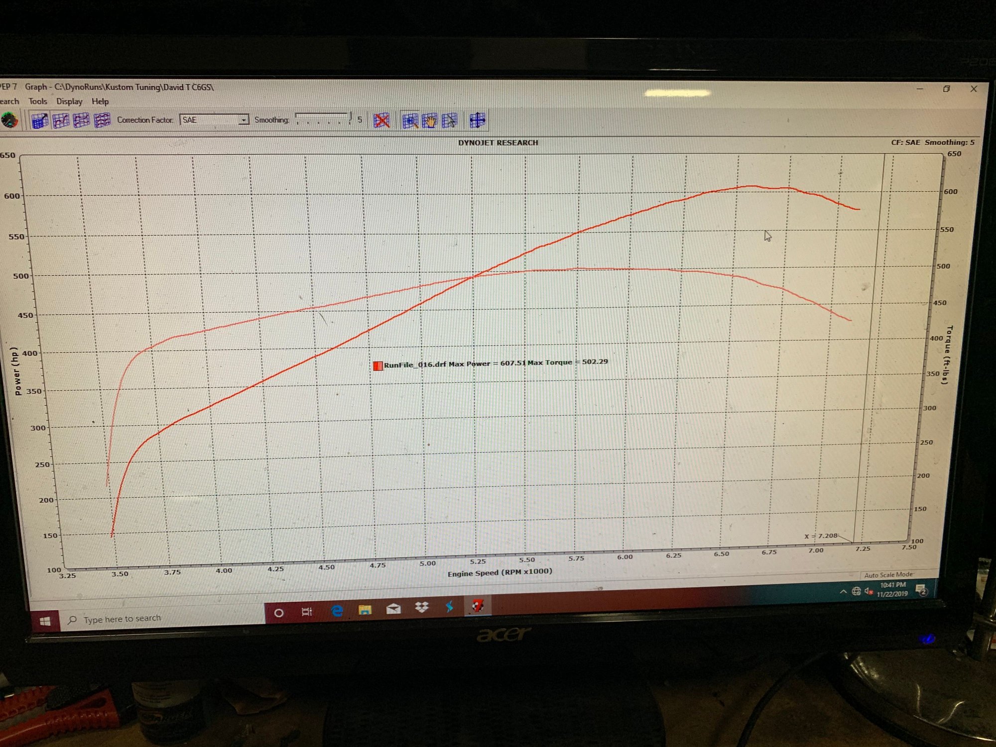

Not sure how much power you want to make but I’m over 600 wheel with the ls7 intake just mill heads for 13. Compression on E not a big cam 245 duration on the intake take a look
You can tell where the drop off starts on the top end and that’s where the intake runs out of breath but clearly you can top 600 with it I just did a quick last minute porting on it basically just ruffed it out.
Stock ls7 bottom end
