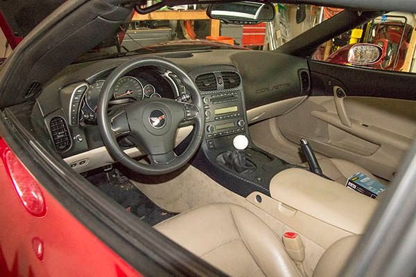

I've upgraded my '05 to the 2012 centennial wheel. You'll need the wheel (of course), a new airbag assembly and a new clock spring. If I recall correctly any clock spring 07+ will work (double check me on this) and will allow you to hook up the airbag and horn. You'll have extra connections on the clock spring connector you can use for accessory controls if you want to do so later.

Nice interior Dutch08.
Thanks ! I appreciate the comment.
