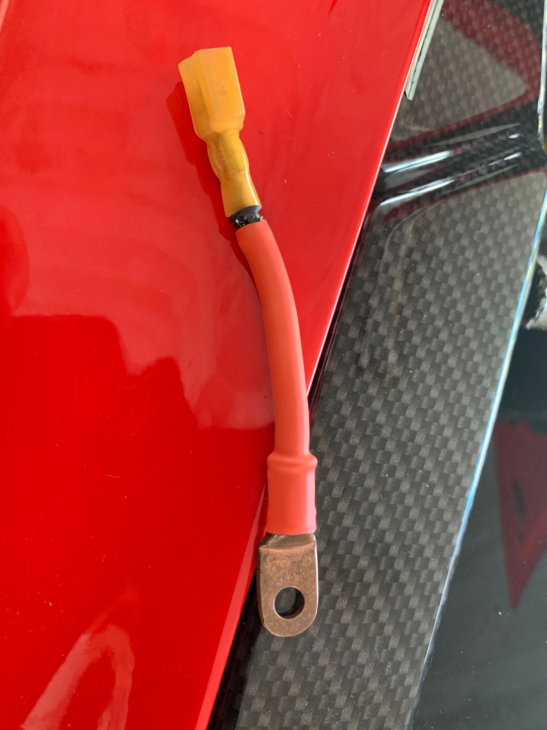

If the factory starter is ok size wise must high torque starters are smaller diameter and shorter I’m running 13 to 1 on E with the Powermaster p# 9509 it clocks to any position needed, no problems with Kooks or ARH I’ve had both. A friend is using the MSD red hts with same 13 to 1 compression ls7 combo and he likes it by the way.
I was having slow starts with a perfectly good very low miles OE starter my tuner hate it he said get a starter then call me cause every time he changed something was thrown off by the extra fuel slow starts when calibrating starting and idle.
Either way another deficiency shows up starting a high compression high performance engine is the solenoid wire going to the push start switch, the connection itself becomes inadequate I found going to a heavy duty loop end takes care of the electrical issue see picture.
I made it removable but is best not to just remove whatever end is there now and using factory wire just change to heavy duty loop end.
That there is great info. I have been looking into the Powermaster 9509 for this exact reason.
