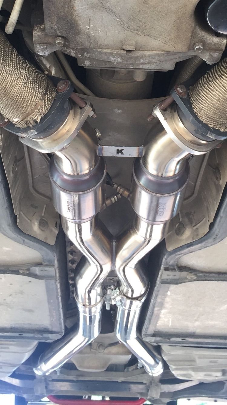

From: Bossier City Louisiana
I’m a big fan of the kooks headers. I bought them used from a forum member and later added a new catted x pipe. Perfect fitment and just gorgeous.
