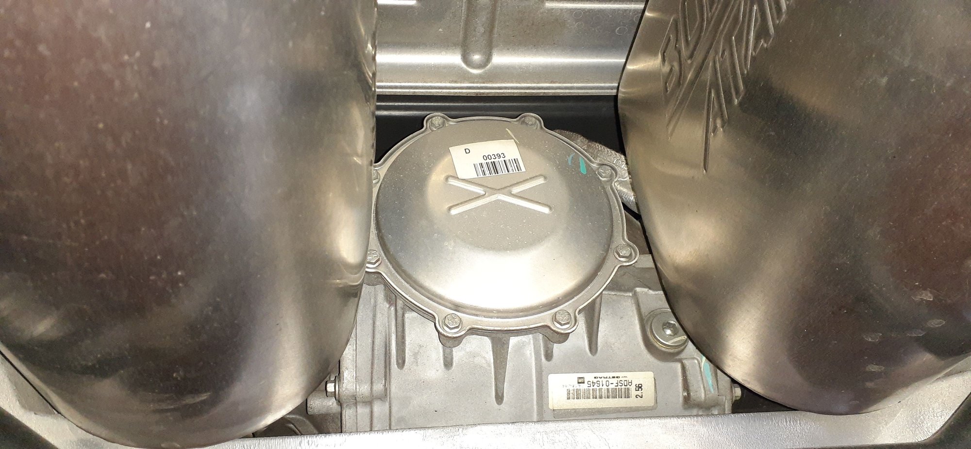

Old Mar 8, 2020 | 10:01 PM
Charliemopic's Avatar
Charliemopic
Joined: Dec 2019
Posts: 310
Likes: 41
From: Chicagoland
These say Borla ATAK. They appear to be made of thick stainless steel with heavy welds. Each muffler has 2 exit pipes.
They are quiet until boost comes on then they get loud.
The hold heat too.
