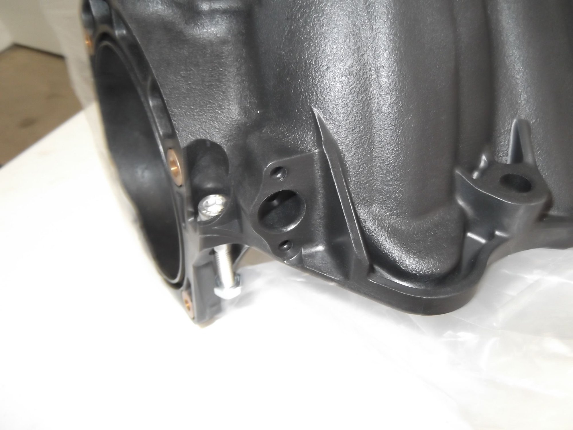

On the left side of the 102 upper near the TB opening is a hole to mount one of the snap fit hard plastic EGR lines. The male tube is formed on the stock LS2. Is a tube fitting supposed to be included with the Fast 102 for EGR application?

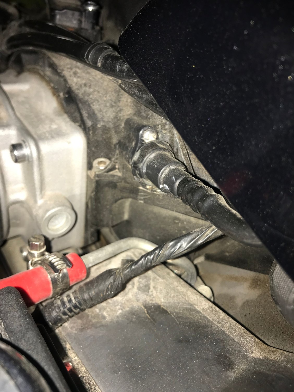

This is the picture of my broken one.
