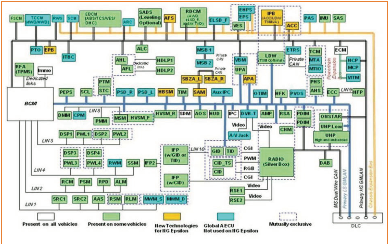

Sounds to me, (this is my opinion and you know what that means), based on the info you've provided, you have a intermittent low speed serial LAN issue. You are correct as the BCM is the bus master for both the LS GMLAN (low speed serial single wire) and the HS GMLAN (high speed twisted pair wires). GM uses "other" low speed buses as well but these two are the major players. The HS GMLAN has the major controllers on it to start and run the car (they're data intensive and pass a lot of data therefore the high speed). When the button is pressed to start the car the BCM pings the other controllers to wake them up. When the modules respond back (with the expected response) the BCM cranks the car and simultaneously powers up the LS LAN (where the IPC sits) This is noticeable as the needles on the IPC sweeps after the car cranks.
There's a couple Service Bulletins (08-07-30-021G, 08-07-30-021E) that discuss chaffed wires or pushed back pins within these busses. Only issue is these SB's are for 2007-2013 6L80 vettes. I would say since you describe your issue as intermittent this still could pertain to you. I'll also throw in GM's notorious cold solder joint issues along with the chaffed wires or pushed back pins. If you don't have service manuals you can search the interwebs for diagrams of these buses to start your trouble shooting should your issue stop being intermittent. This won't be as easy as cleaning grounds and your issues magically disappear. I've fixed many a bus issues on 08 and above vettes, but haven't had the pleasure to work on a 05. The number of controllers sitting on these busses will change between the years GM made major changes (i.e. the 4L80 has the TCM built into the ECM. The 6L80's have a separate TCM located in the trans itself, another is F55 equipped cars).
Her is a generic diagram for GM buses. I will also point out that the LS GMLAN that you see in the diagram shows it terminating at the DLC (ODBII connector) this is probably the reason your Tech2 can talk to the IPC. FYI if you find the pinout for the ODBII, pin 2 is labeled Class 2 Serial bus. This is the LS GMLAN. Pins 6 + and 14 - are the HS GMLAN's twisted pair.
Good luck!
Good luck!
The data signal is there I see it on the tech2. What makes everything sweep when you start it.
