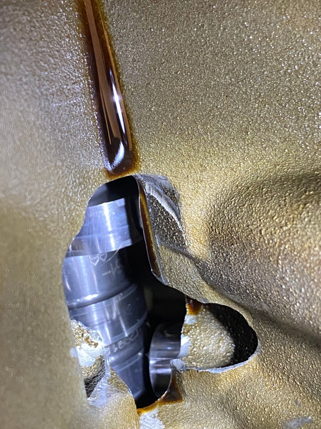

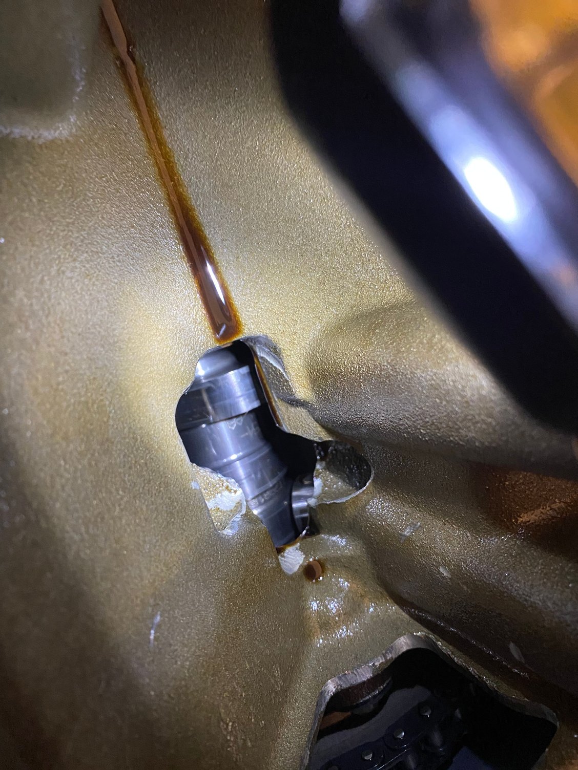

Just curious what you guys think?
4k miles on the cam. BTR Stage 3. Ls7 lifters. BTR springs push rods etc.
Is this worth fretting about? I can’t feel any of it with a finger nail. It’s just visual. Car seems to run fine otherwise. I just tore her down for the heck of it tonight. First engine I’ve done any internal work to so I’m a little green when it comes to these kinds of things.

My Comp Cams cam looked the same after 8K miles, I left it in & it's still good for now after another 3K Mi.
I know this info doesn't help you, but wanted to share!

My tuner told me to throw some ZDDP additive in with my Mobil 1. Might be worth you doing as well. Stupid question, what all do you have to take off to get this view? I have a slight fear that my cam may be wearing, but don't want to have to rip the whole motor apart to see it haha.

To get to this view you need to remove the intake manifold and fuel rail to get to the valley cover. Once your there you can take your valley cover off and get this view. You can see about 4 cam lobes total. It takes probably 1ish hours to get to this view if youre taking your time.

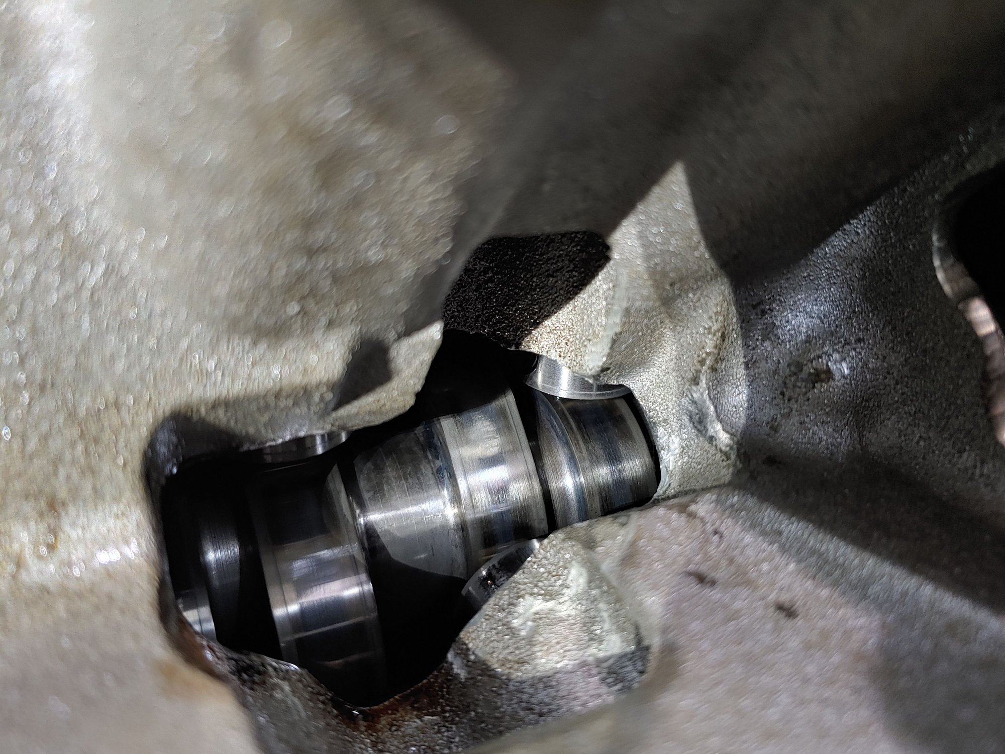

my stock ls7 cam after 73k miles.... made 458 to the wheels on the dyno before I pulled the motor...

Why did you pull the engine??

head fix, Blackstone report was normal before I pulled it...

Mine looks the same. I talked to an engine builder who was doing my heads at the time and he said it was totally normal fwiw. He told me to pay more attention to how it feels versus how it looks. Felt smooth, left it in and forgot about it.
