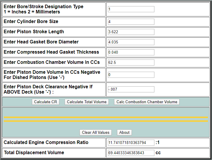

Whats you compression ratio? did you mill any?

Around 11.7:1. Heads were resurfaced twice but not purposely milled. Has around 0.010 taken off. 0.40 cometics are on it as well.

If those were 243's you had 65 cc chambers. Between HG and resurface you took about .022 off. 11.3 to one or so? I've got about the same set up. Trick flow fast as cast 220's. Mill .025 and .044 HG about .033? Total 11.5 to 1 ? Comp 231/239. .617/.624 113+4 and I did a 100mm maf that really makes it breath! Car is running going to the dump/tuner ASAP. I am also looking for 500 at the wheel, I hope been trying to get there for awhile

Maybe you can double check my math here. Stock chambers are 64.45 cc, I've been told by the machine shops that did the heads that anywhere from .010 to .012 has been removed in total, so I'm guessing just under 2ccs smaller. Everything else should be pretty straight forward. And yeah I switched over to just a custom 4 inch intake with a 4 inch maf housing. Didn't do a before/after pull but the combo definitely works with a NW102. You'll be in the ballpark, that's for sure.

I was never any good with those calculators, BUT GM lists 243's as 65 cc chambers and stock HG's at .052 compressed and LS2 at 10.9-1 comp. it is widely used that .005 is 1 point in comp. Sooo you did .012 and you have HG at .012 that's .024{I'm being generous} so lets say .5 which would give you 11.4, stick out from the deck is more like .003, I did .025 off the heads and .008 HG which is .033? I figure I'm about 11.5-1
