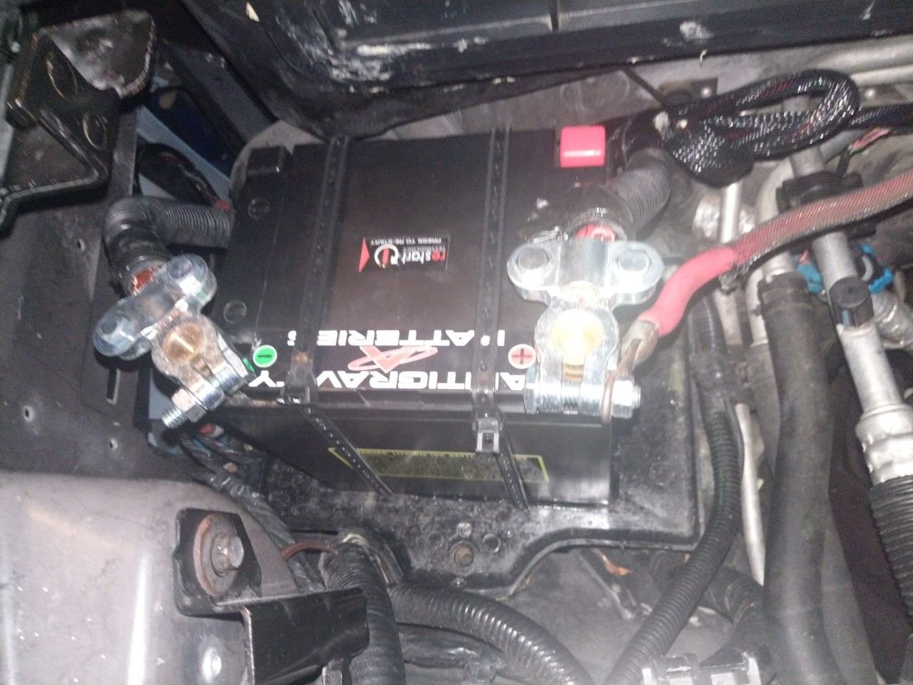

antigravity atx-30
for now I just used two heavy duty tie wraps no problems so far and I have 25% underdrive pulley no charging issues

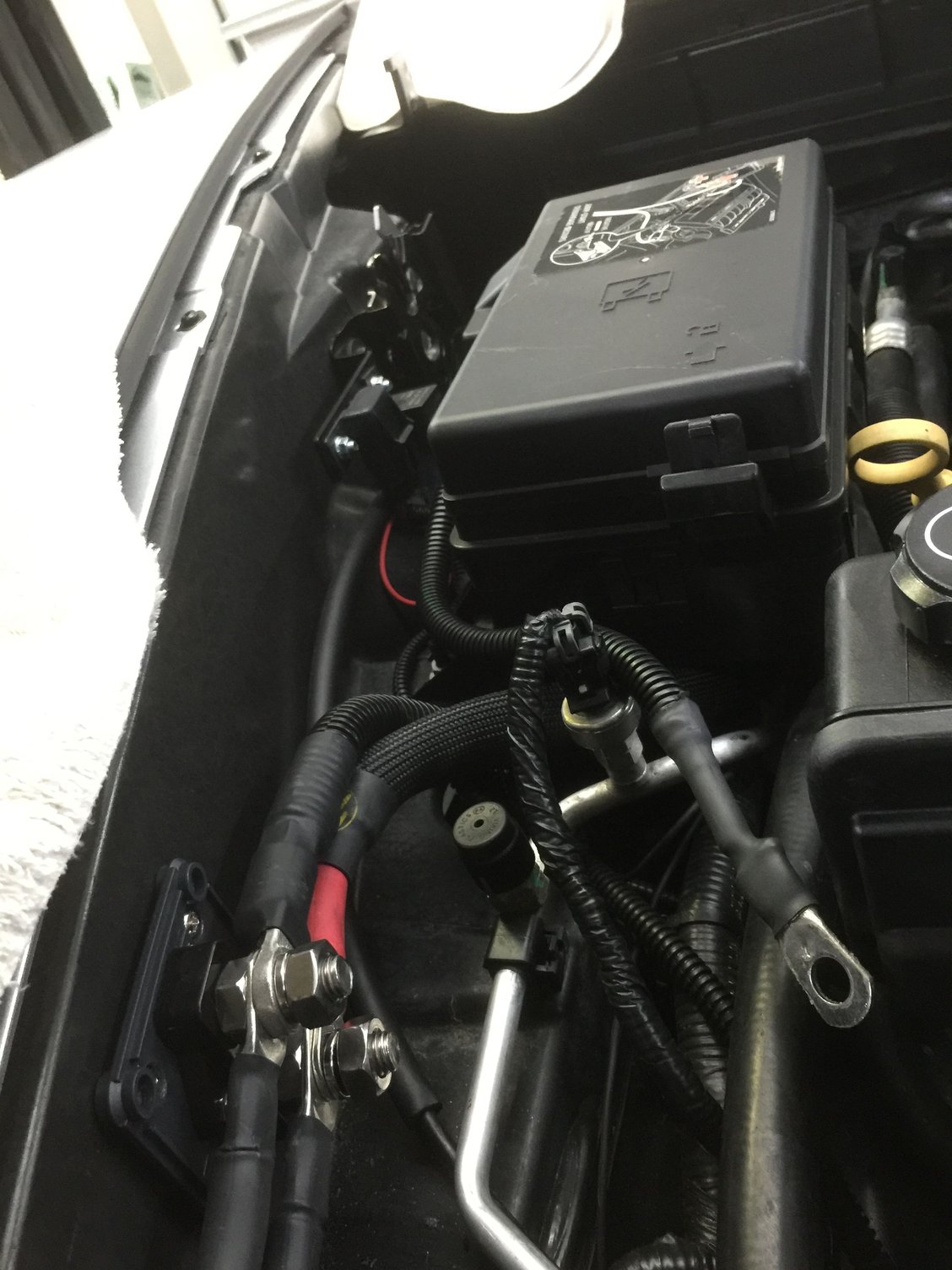

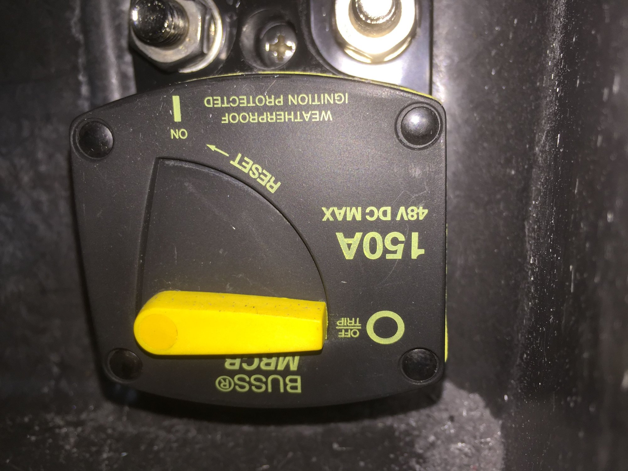

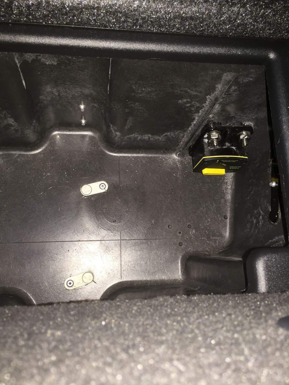

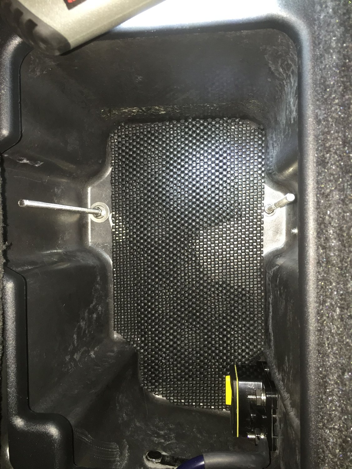

I did mine differently, by running a 1 gauge wire forward through the right rocker tunnel and connected that to a Marine bulkhead connector and then ran a shorter cable to the starter and then a 1 gauge wire over to the alternator. I also installed a marine circuit breaker in the rear cubby next to the battery. I prefer to have some sort of breaker or fusible connector inline when running heavy gauge wiring forward through the rocker, in the event that the cable gets shorted in a crash or something.

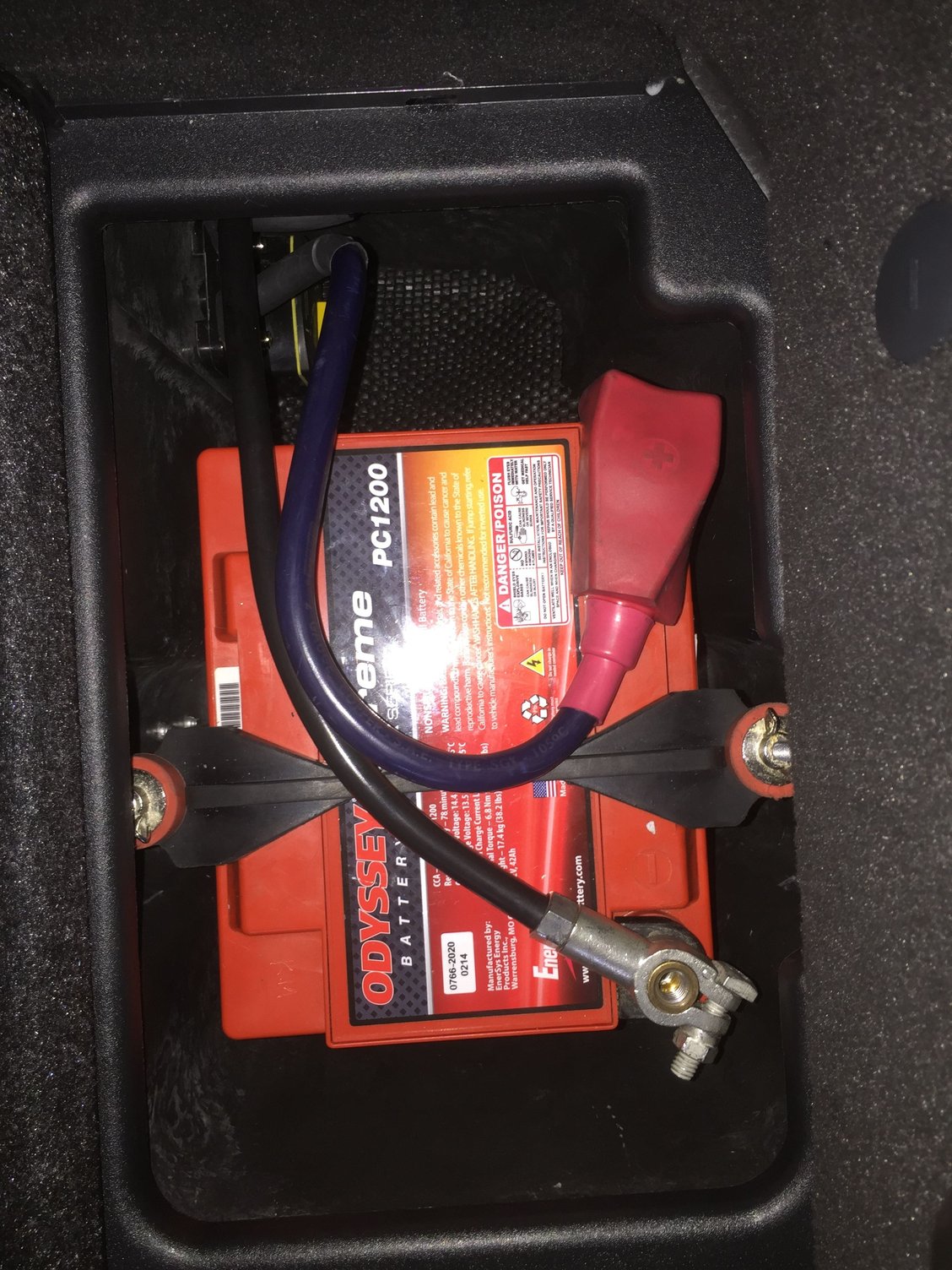

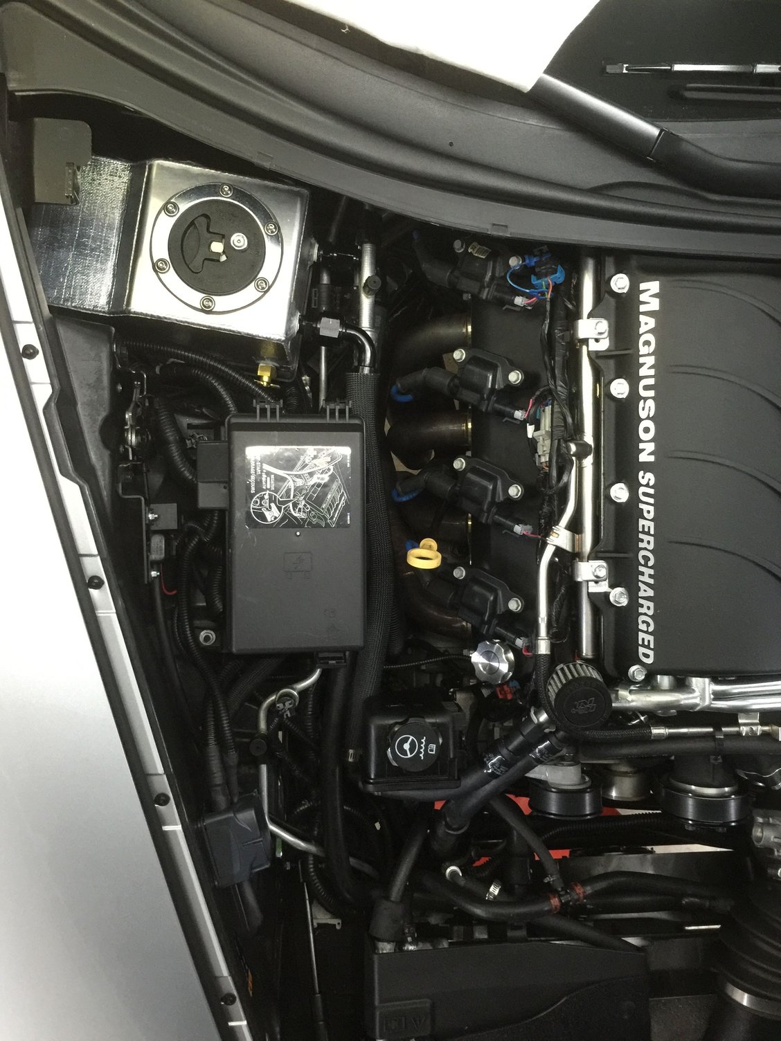

Here are a few pics of my install:
Here’s where it’s located: easily accessible with the PC1200 Odyssey installed.
Busman 150amp Marine circuit breaker. You can get one of these from just about any large marine retailer.
Used two threaded rods with S/S fender washers underneath for the holddown. Put some toolbox drawer liner under the battery to help cushion it.
Here’s the bulkhead connector mounted forward of the fuse box. NOTE: This isn’t the ideal one, as the two lugs aren’t connected, so I had to use a heavy cable loop to connect the two lugs.
Odyssey mounted and connected.
Moroso H/X reservoir mounted in place of the battery.

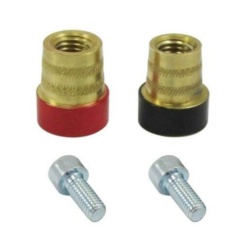

How did you add the posts
Old May 27, 2020 | 02:50 PM
veneno's Avatar
veneno
Posts: 469
Likes: 62
From: coconut creek, fl
Antigravity Batteries Automotive SAE Terminal Adapters
purchase separately I got them from ebay

Originally Posted by CI GS
That should work. But it would be better if you either ran the batt + cable directly to the starter or at least changed the factory positive cable for a short HD cable and use either a covered marine junction block to connect the battery cable to the starter cable. Or, better yet, use something like a Mechman ANL fuse holder and a ~300amp ANL fuse to connect the two cables together.
https://www.mechman.com/accessories/...l-fuse-holder/
I've decided to go ahead and run the main battery cable straight to the starter. I like the idea of the circuit breaker you put in the cubby! You have a link for that?
