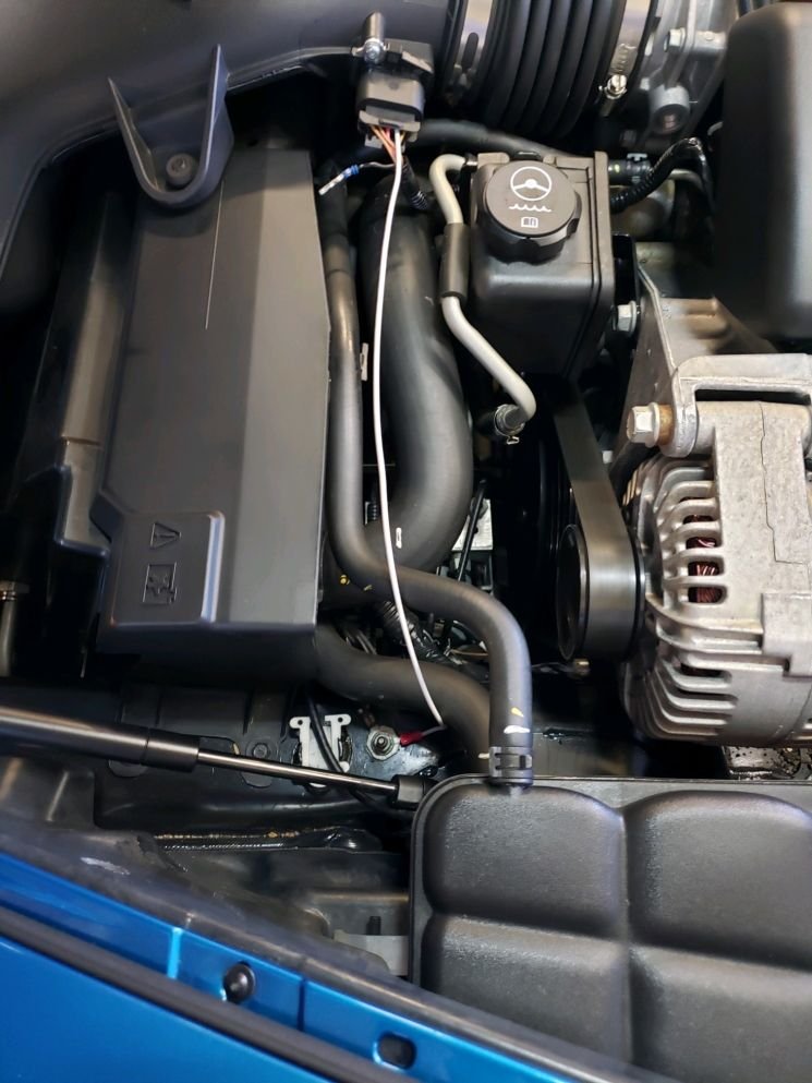

Checked everything and appeared to be having intermittent ground issues. Replaced the pin/pigtail at the connector, soldered it into the harness and cleaned the G106 body ground on the right rear side of the engine. Same results. Bought a replacement connector from GM, pulled the pin/pigtail from the new connector, put it into the old connector and ran it to a local frame ground. Problem solved! I'm assuming I have a broken/frayed wire somewhere in the harness. It's running great now, but I'm going to have to figure out a more permanent solution.

As I mentioned, I put the frame ground on Thursday after work. Started the car and it ran great. Drove it around the remained of Thursday night – no issues at all. Got up Friday morning. Started fine. Drove it to work and around at lunch - again no issues. Got up Sunday morning. Went to back it out of the garage, wouldn’t start again. Same issue. Since I already had an appointment scheduled at the dealer for Monday, I decided to splice the pigtail back into the wire harness and drop it off at the dealer Sunday night for them to look at Monday morning. The tech at the dealer does a lot of work with the local Corvette club and everyone swears by him.
Got a call from the dealer Monday around noon. They went to start the car and the battery was dead. Really odd since I’ve never had an issue with it, but they said that they tested it and it failed their test. They also said the cables were slightly loose. The plan was to install a new battery, tighten all the cables and try again in the morning.
Got a call today around noon again from the dealer and this is what they told me. They installed the battery, let it sit inside all night and it started right up in the morning – no issues. When the tech took it for a test drive, the car almost stalled on him and he had to limp back to the dealership. Thinking it’s now a fuel issue, he checks the fuel pump, pressure, etc. Everything passes and still no codes. He says he’s stumped (his words, not mine) so he’s going to start at the front of the car and work back on every system until he finds the problem.
When he pulled the air filter off, he noticed the carbon pouch had come unglued from the housing and is only attached along one edge. When he gives it gas, depending on how the air flows, the pouch swings down and blocks almost the entire intake of air and the car stumbles and stalls. Pulls the pouch off, re-installs the air filter and everything is running fine – for now!
