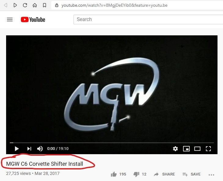

Follow the instructions for installing the insulation that MGW explains on Youtube.

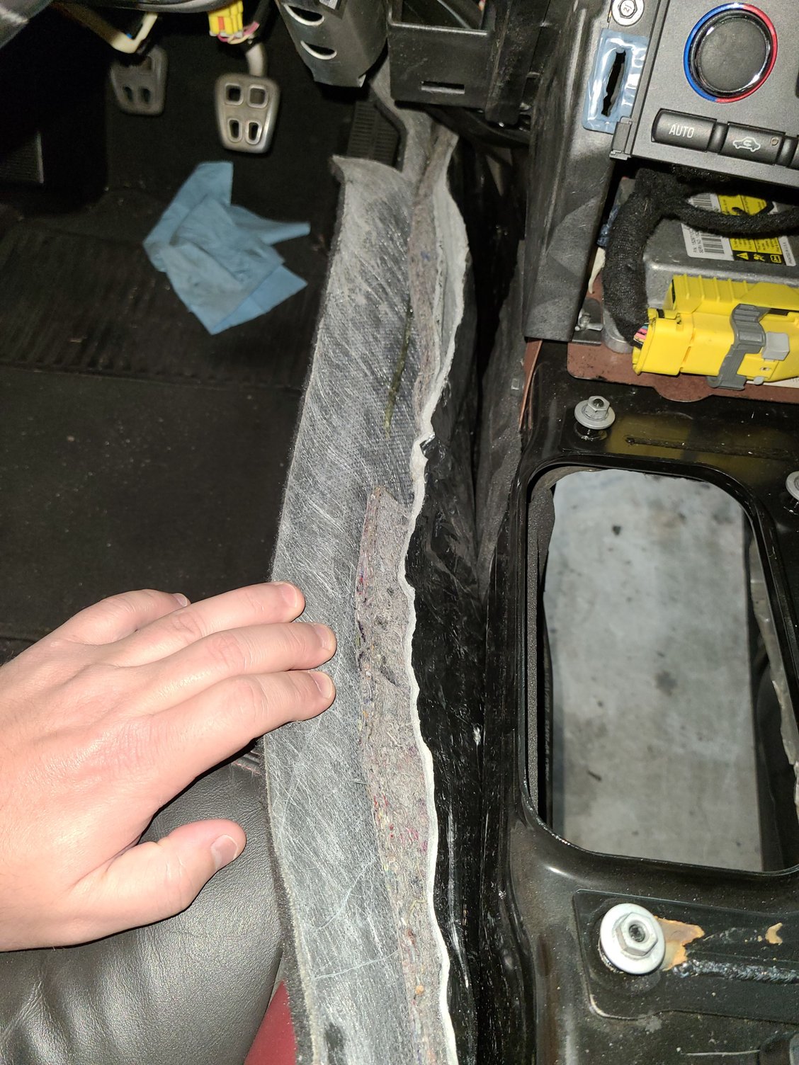

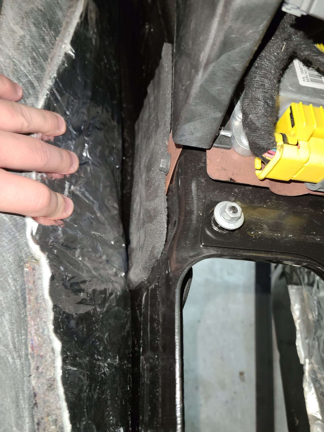

I do my own tinkering and recently removed the exhaust and the tunnel plate and found out why the center hump area gets so hot, first was evident the insulation is installed in two pieces starting off the center and the two sides didn’t meet together they where separated allowing heat to be absorbed by the exposed metal no wonder the cup holder gets so hot but as that ain’t bad enough tours the front approaching the firewall the two sides split away wide open so heat is absorbed there by the bare metal and transferred tours the back to the cabin and console area, no way I was going to live with that went to the auto parts and didn’t find anything good enough so went to a car sound place and for 12. bucks they handed me a piece Dynamat just cut to size and stick on, also I had previously got an insulation for the tunnel plate and that helped so I run into another and bought it so the tunnel plate is now insulated on both sides to help keep it from absorbing heat all is normal now.

Originally Posted by jol
Video is unavailable.
This is the URL

Go to youtube and search for MGW C6 Corvette.

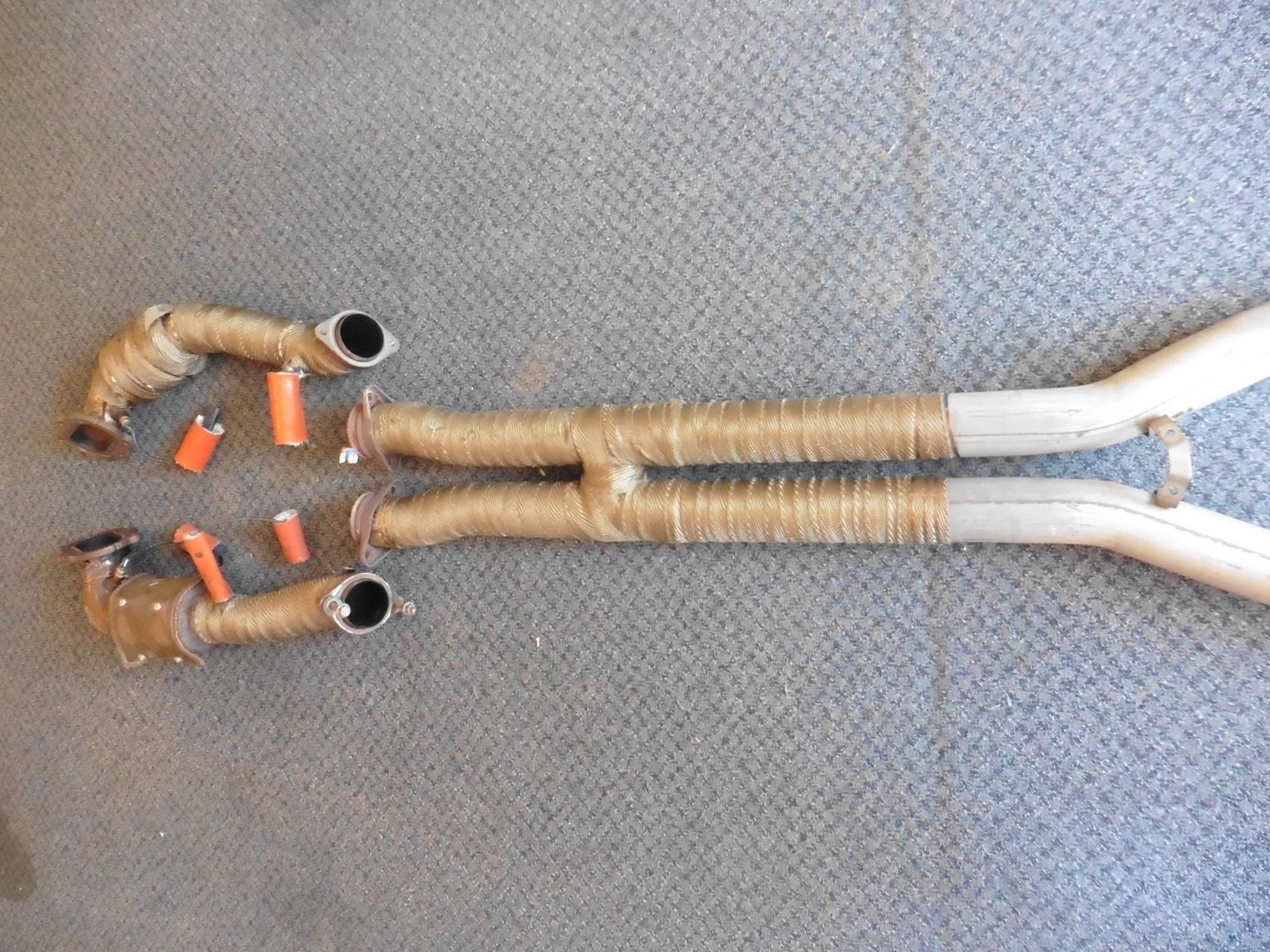

DaOtherOne's idea doesn't hurt, but..... I too put in the few square inches of stuff I got from MGW when I put my short shifter in my '06 ZO6. However to really take care of all that heat, I found that there are other areas that I needed to work on first. Since I enjoy tinkering like others, I had to decide if it were best for me to attack this heat issue from above or from below. Previously I had installed a couple different seats w/ sliders & discovered that I really don't care to work from inside the crammed cockpit. I guess since I also have jack stands & tools, I decided to tackle this from below. Similar to xBoostx, I also extended the tunnel plates' reflective insulation by purchasing a product from Design Engineering. While in there, I also put on 50 ft of their 2" Titanium wrap to my exhaust pipes by attaching this with SS zip ties. The wrap was only $70 and easy to use. The one additional thing I did was to put on DEI's C7 catalytic converter shield on the driver's side. This may have not been necessary but their product is so sweet that it was a pleasure installing such a quality part. Fortunately for me, my under the car tinkering dramatically cooled my right leg. Hoping the best for you too. Pic included
