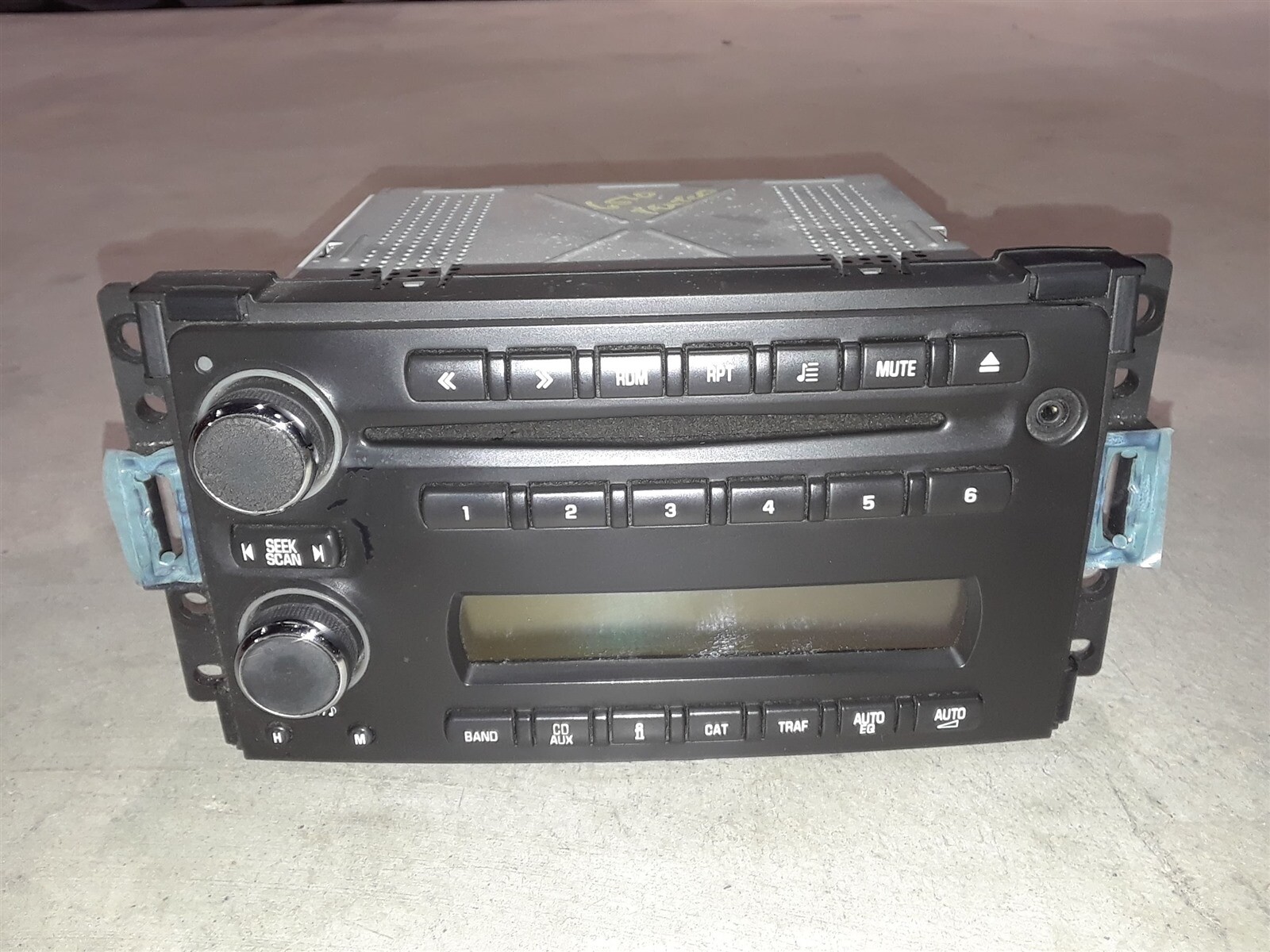

I have a 2011 C6 base convertible with the 3LT option package - has the Bose system with NON-NAVIGATION single CD radio ( I thought the 3LT package included the 6-CD in dash radio).
I've been thinking about swapping it out for an OEM 6-CD unit, but info is tough slugging - I have started finding more available (my search-fu must be getting better?).
Got a couple of questions for anybody out there familiar with the unit:
1. Anybody ever have any trouble with the OEM in dash 6-CD changer? I've owned numerous changers (Ford, Jeep, Pioneer) and never had a problem but my local stereo shop says stay away from anything with a CD changer.
2. Is there a specific radio for the Bose system? I'm finding a number of OEM in dash radios with the 6 CD changer and AUX input, but no mention of Bose - I was thinking earlier I ran across "Bose specific" radios?
I've run across these part numbers but don't know if they apply to the Bose system or not:
Part #’s 25930344 25854492 20795290 158663553
3. Can the dealer unlock unit before it's installed (for testing reasons)?
Any info appreciated!
I've got an Android cell phone I bought just to use as a hard drive - it's plugged into my AUX input and has all my music on it, but I do like the convenience / sound / operation speed of the in dash CD player. I'd like to be able to burn 6 genre specific MP3 CD's & have them all in the radio, available at the push of a button.

Old Jun 17, 2020 | 04:12 PM
Dano523's Avatar
Dano523
Joined: Dec 2013
Posts: 12,502
Likes: 3,631
Photo of the cd unit needed.
Hence car should have come with a 6 disc changer in the dash, but may have had problems, and someone replaced it with single disc they found on the cheap isntead.
Hence just looking for the top button third from the right, and if it has the stack picture, it a 6 disc changer.
As for if a single and you can find a 08-13 6 disc radio with Aux input so it does have the steering wheel controls as well, is a simple plug and play swap of the units, then Tech II to clear the old marry of the radio to the other car is was in before, and to remarry to your car on the first start up so it works in your car.
My car has the unit as in your picture - I'm aware of the extra stacked CD button for the 6-CD units.
I've found around 3 possibilities out there, but scared to take a chance until I can get some verification.
Previous poster said if the car came with GPS (didn't they all?) you got a single CD instead of 6-CD unit - don't know if having GPS means the 6-CD radio would not work for some reason?
I'm almost willing to bet it would be a straight swap (dealer activation aside), but I've got Bose, steering wheel controls, & GPS / Onstar in my car.
Don't know if any of those would trip me up?
