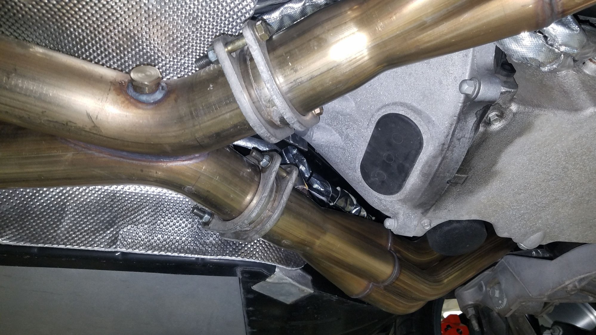

Warren J, I installed (myself) AmerRacing 1 7/8" Headers & 3" Catted X Pipe which
gave me 400 RWHP (on Tommy Wong's Mustang Dyno)
From What Ive read I'd recommend the Texas Speed Cam Kit(forget the model number) or
Bryan Tooley Cams for use with your STOCK A6 Converter. And
