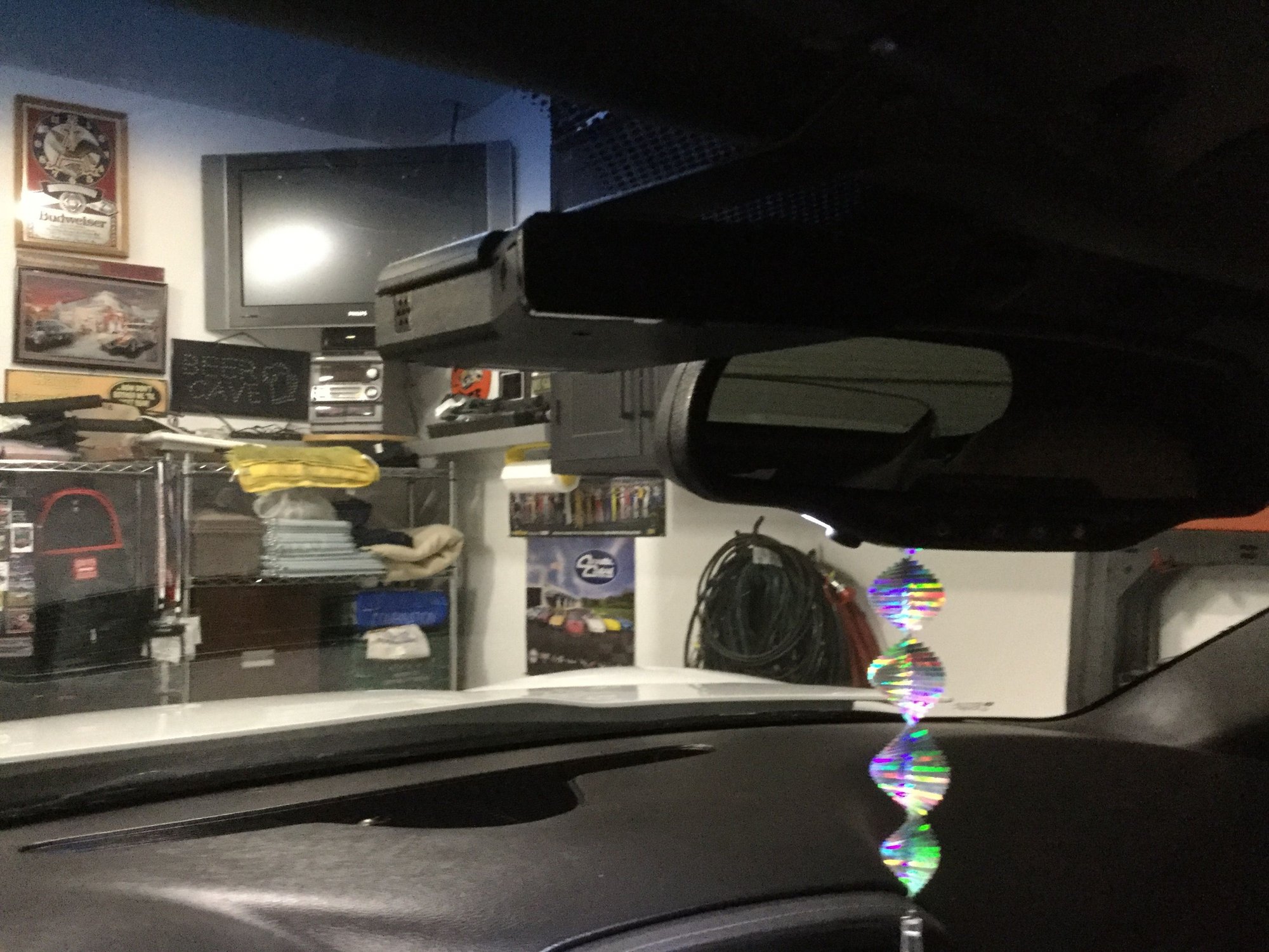

eBay for Mirror Tap wire harness. I have what is called a Vision Mount for C6, also available on eBay. I will post pictures later if you want. V1 Gen 2.

. When you purchase the Mirror Tap power cord for your car it comes with instructions on which color wire the tap goes over or under. Follow the instructions. I have them in my file but will have to look tomorrow. Pink is switched 12V and black is ground.
